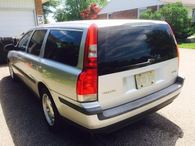

Had fast blinker, on wife's Volvo wagon...front left.
- she works in the automotive trades, and is sharp mechanically
- so she called dealership, for a pigtail socket (to hold the good bulb)
LOL, dealership didn't sell the bulb socket.
- instead, the parts guy tried to sell her a $1,000 wiring harness
- and book a ton of hours, to install wire bundle @ $110/Hour
A mechanic friend, fixed the pigtail socket, in 15 minutes.
- normally a $5 part, at the local auto wreckers
