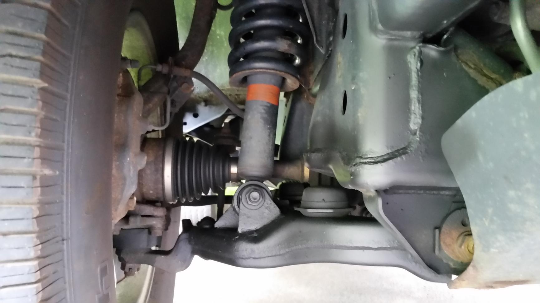

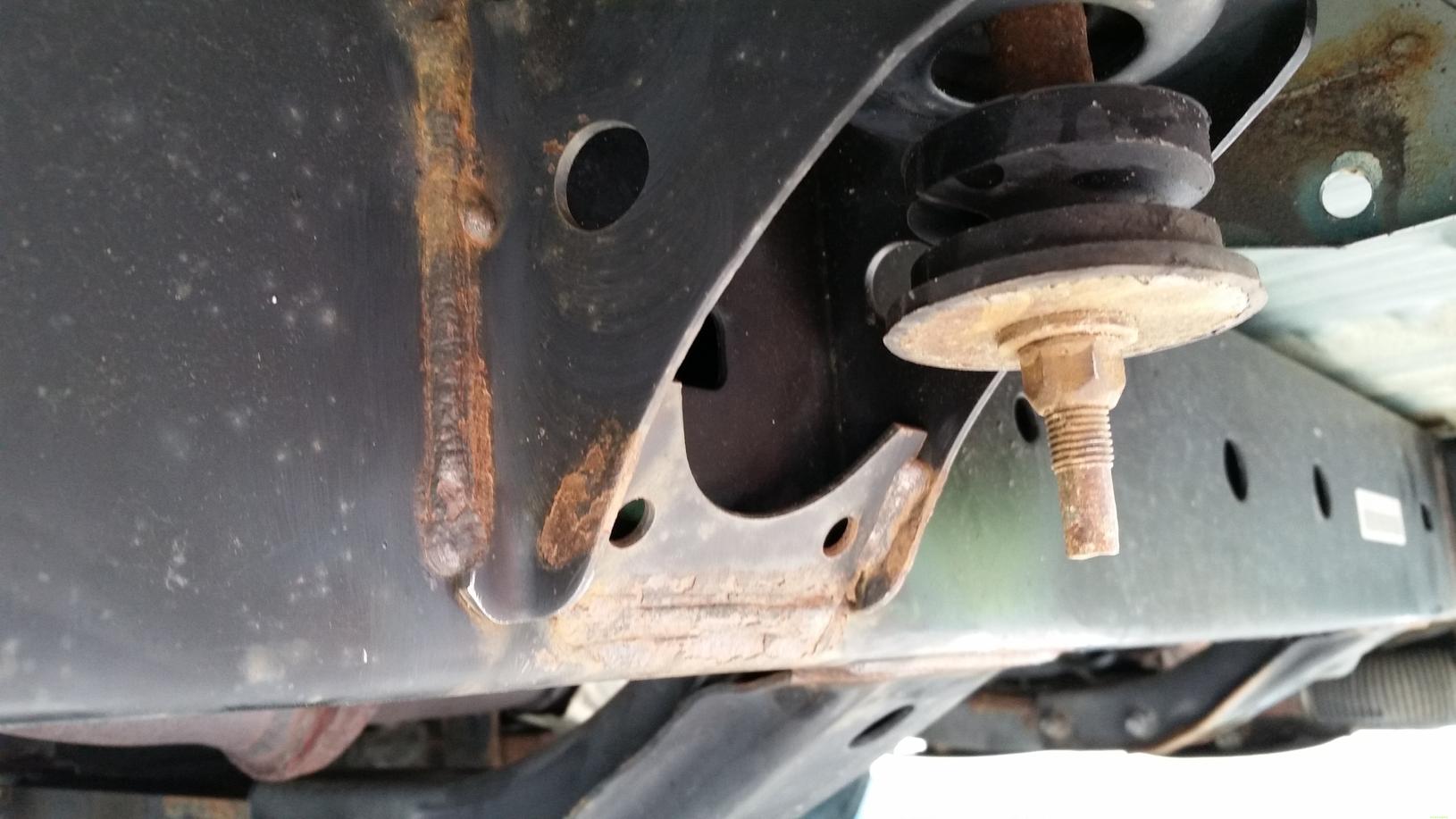

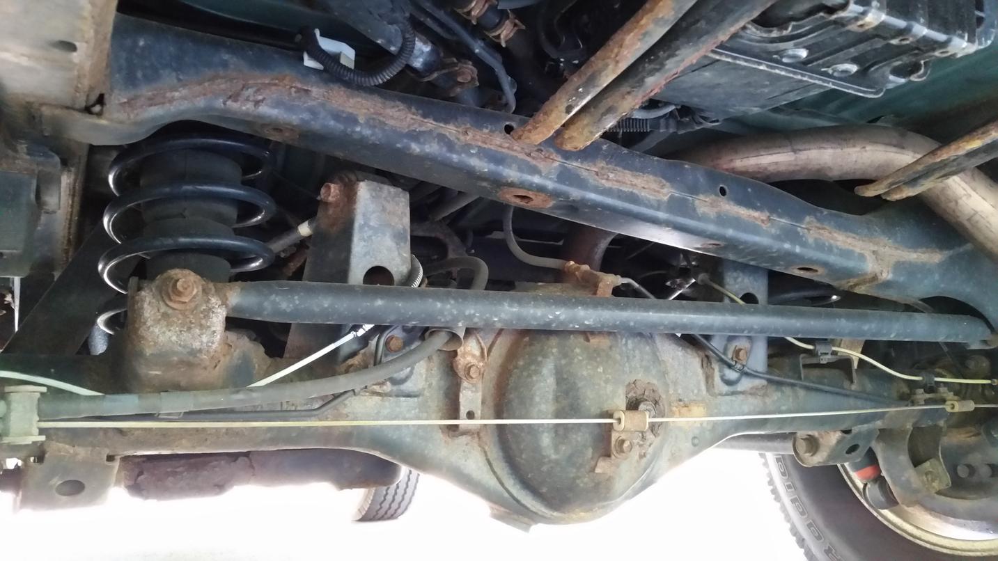

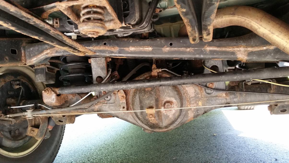

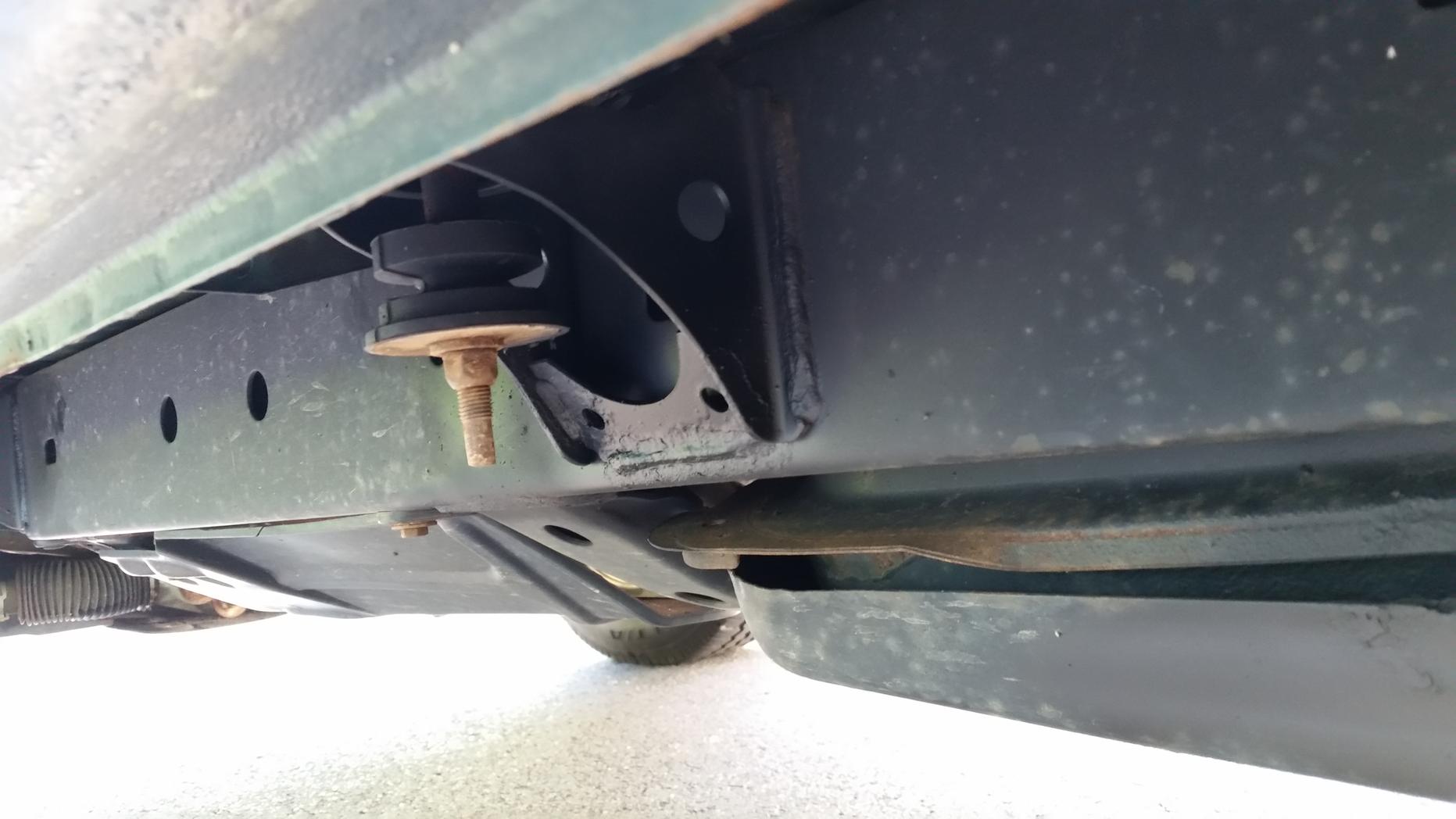

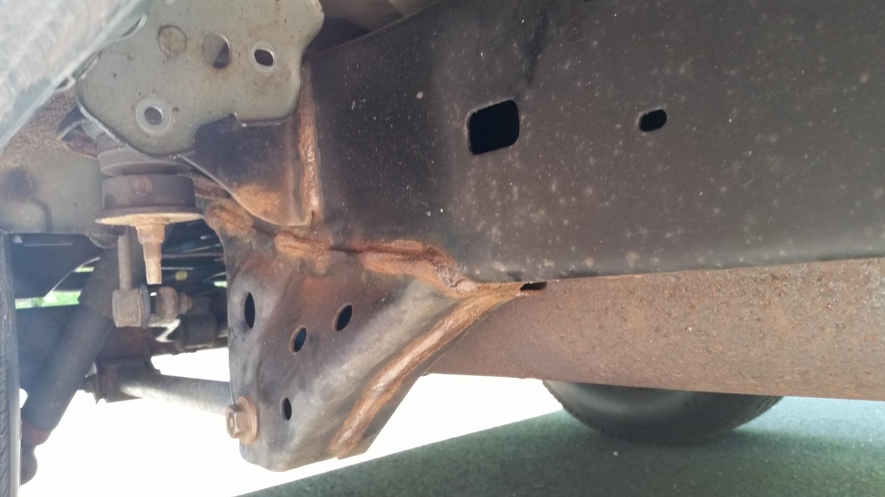

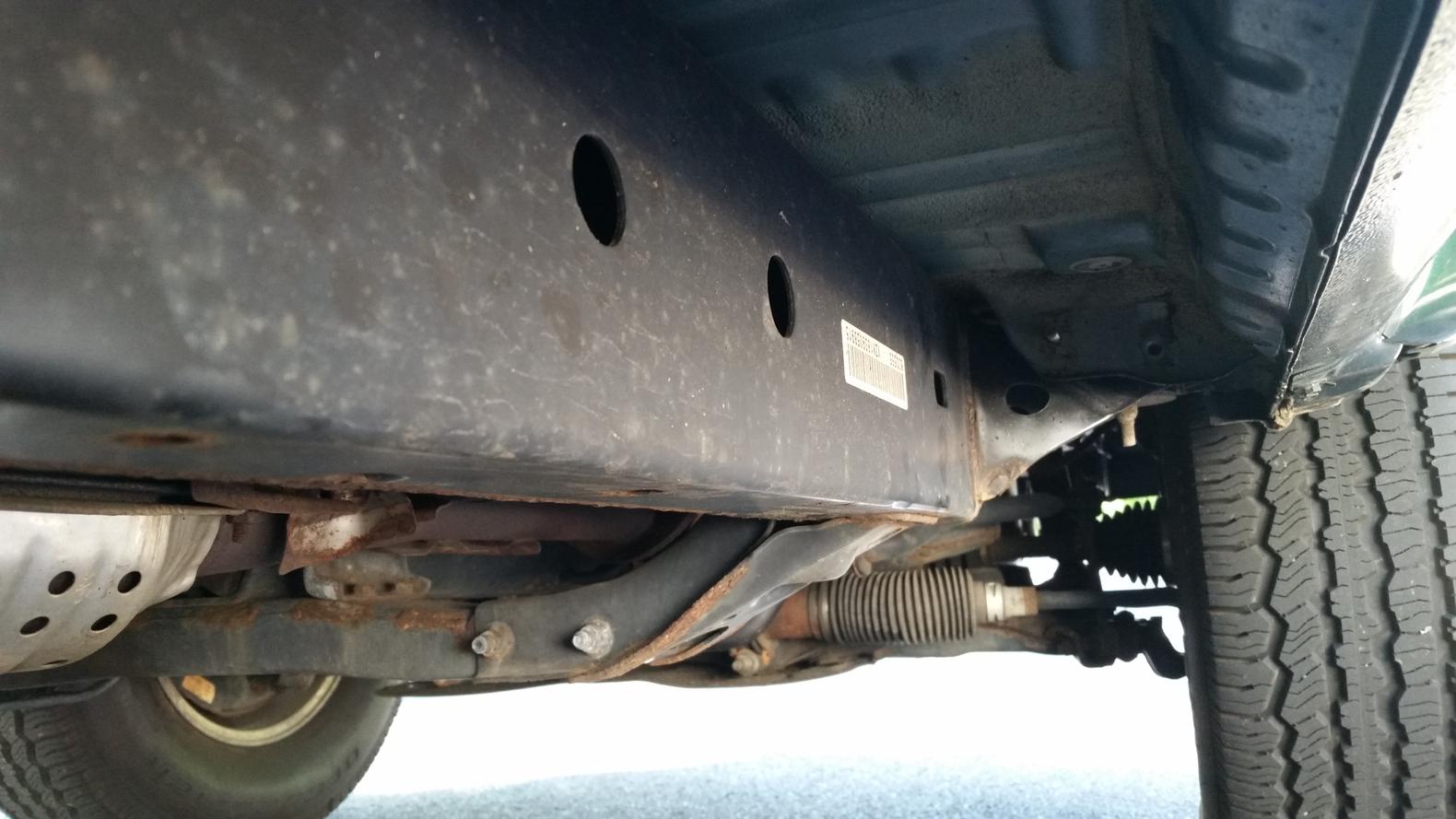

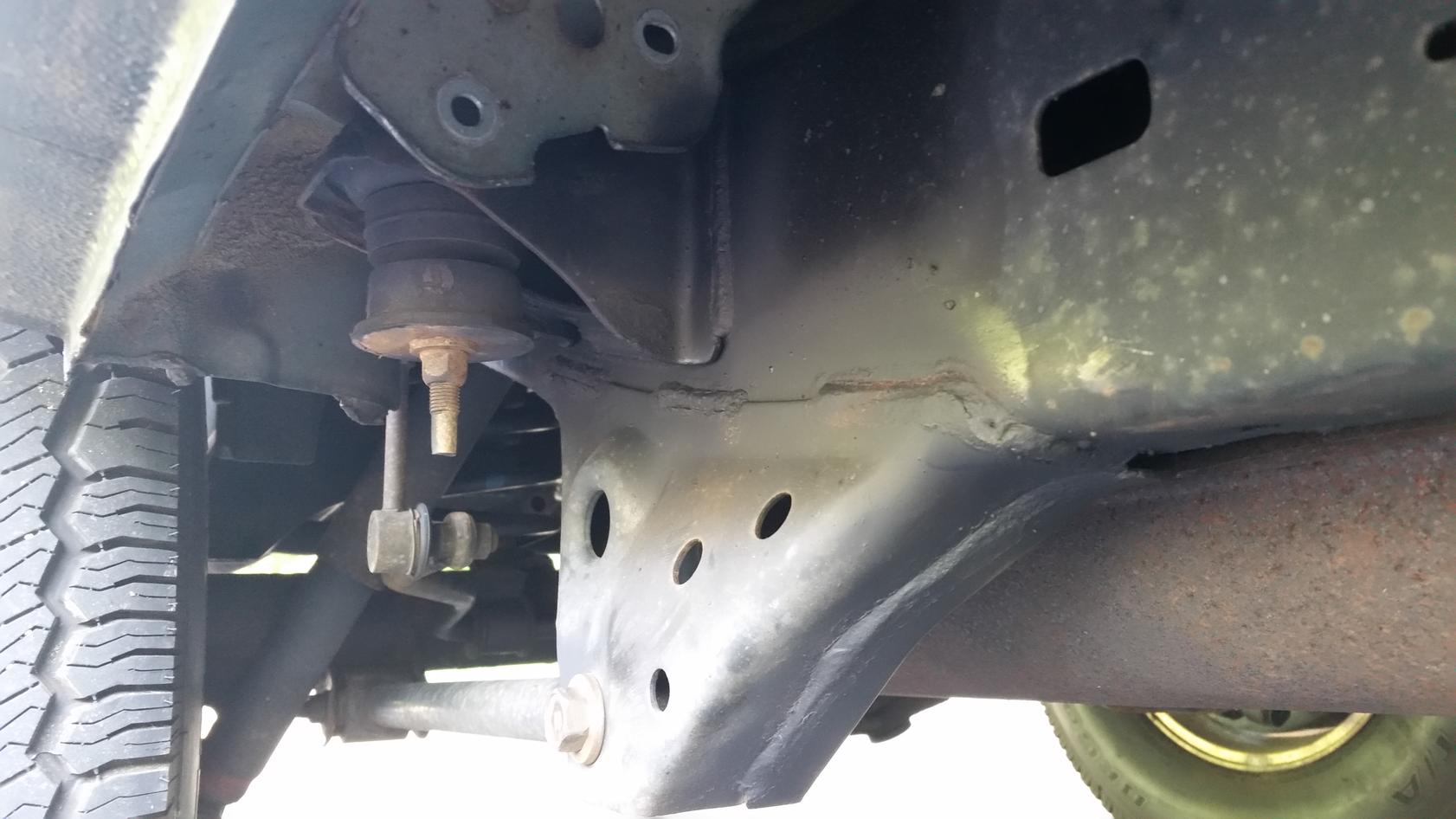

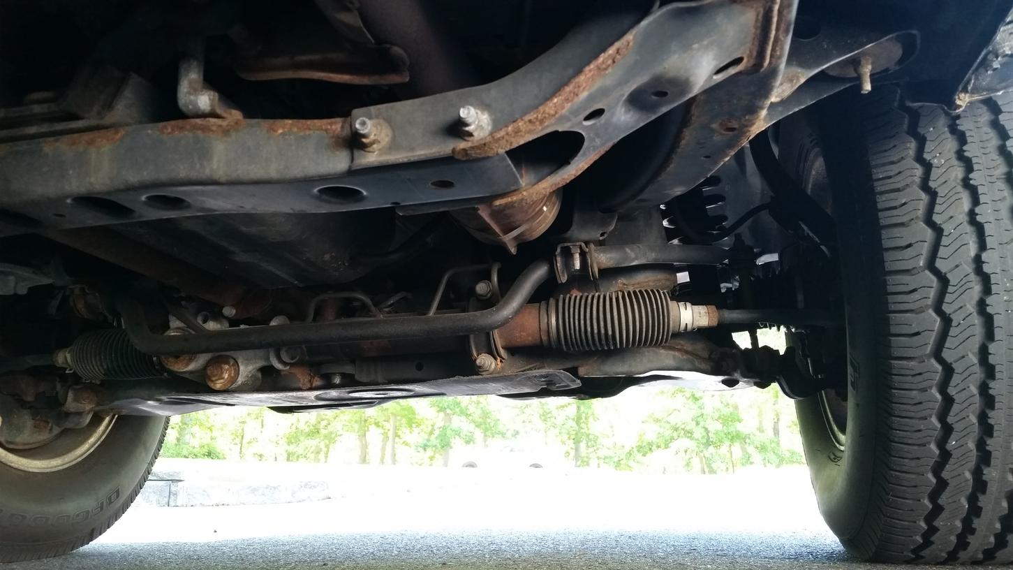

Let's begin. First pictures of the frame beginning my project. No rot, just surface rust.

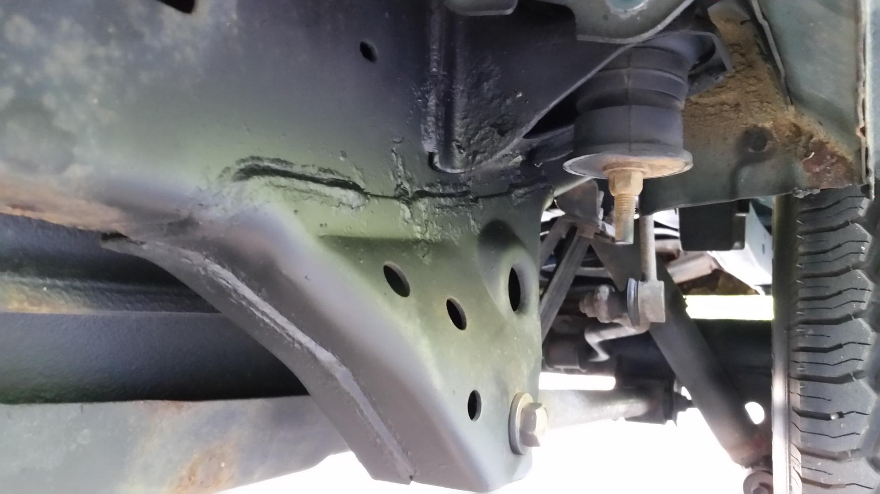

Next, wire wheeled all the loose rust

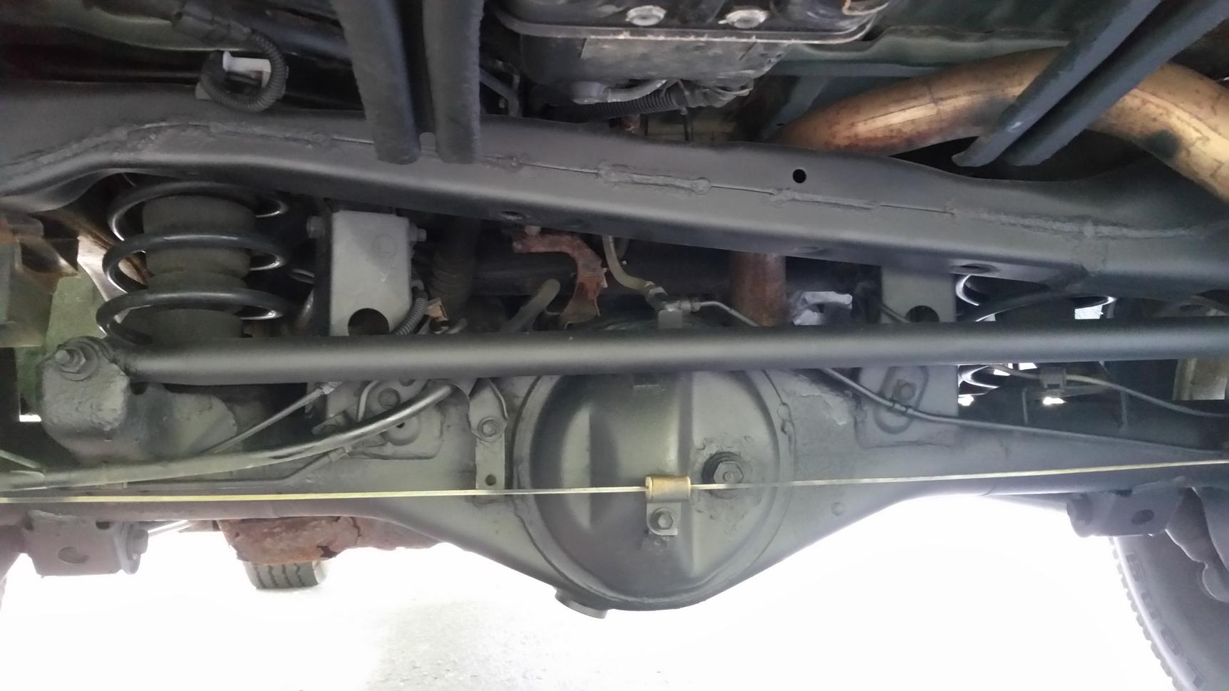

Coat of primer. Starts looking good now.

Continued....

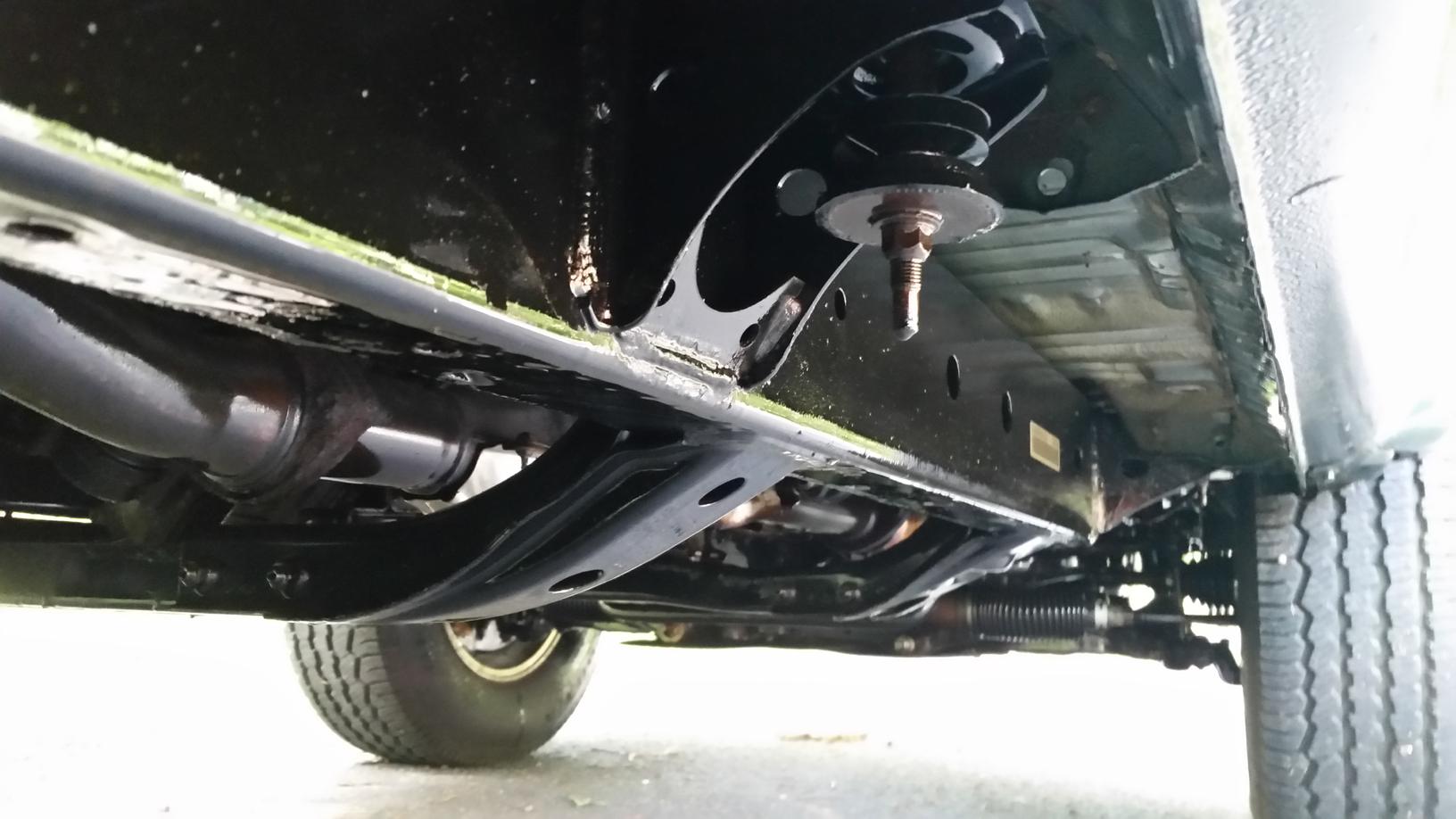

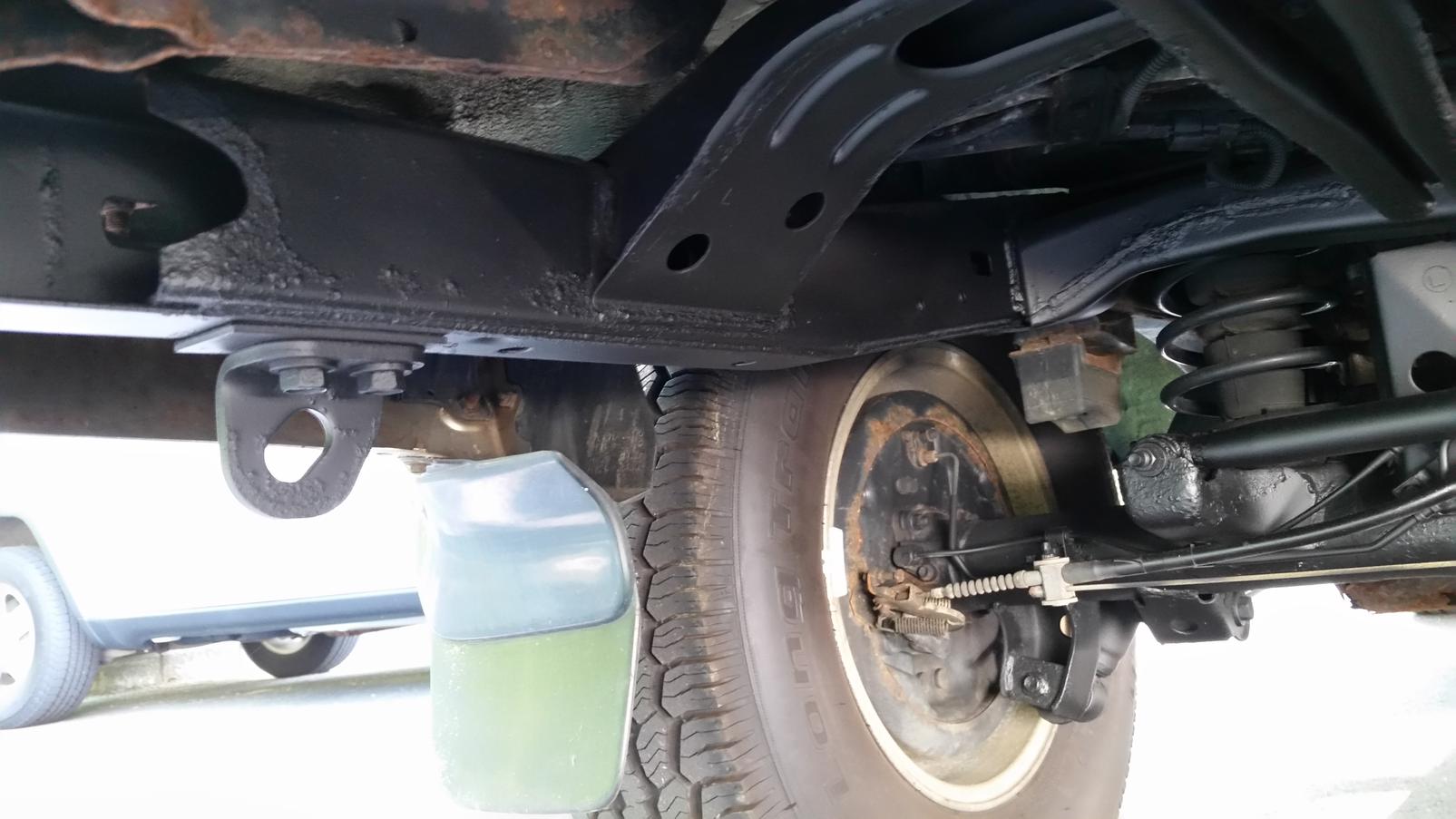

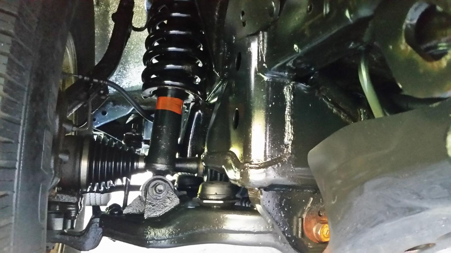

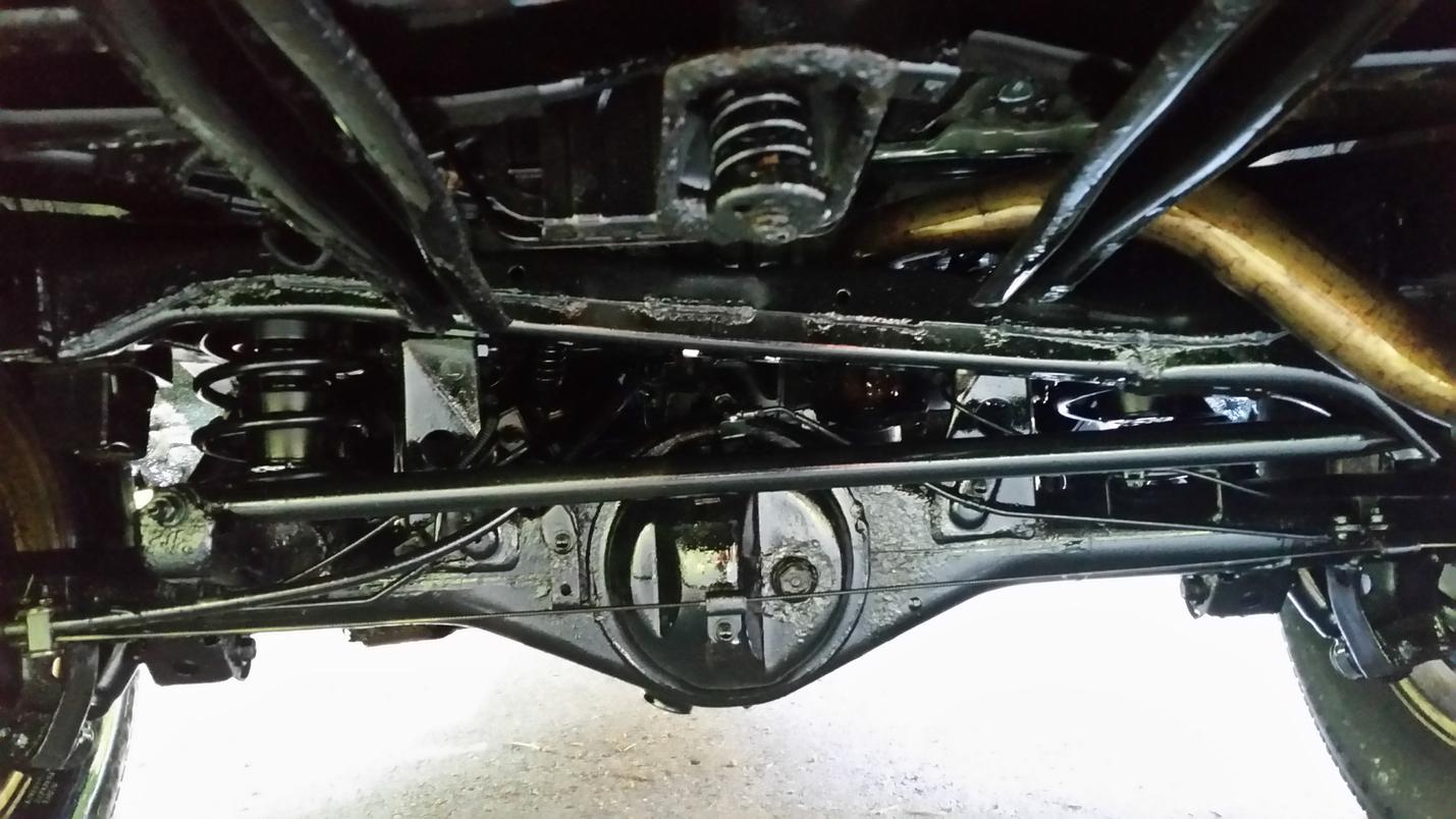

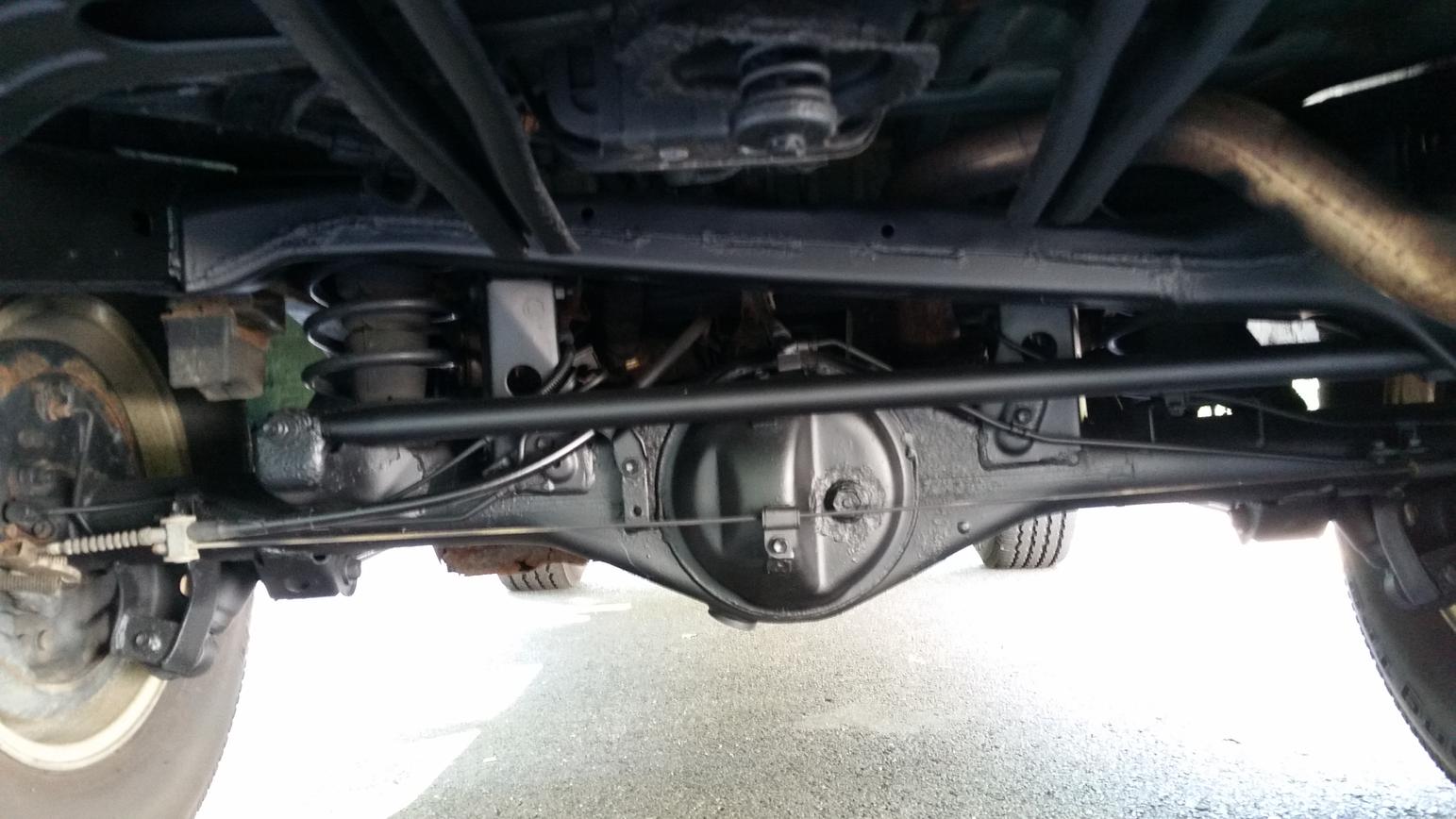

After primer, 3 coats of paint. Rustoleum flat black. I did not need to spray the whole frame because it was still black and clean.
And finally, sprayed everything with used diesel oil. Extra shiny, extra black, and extra protective from these winters.
To me, it was well worth as I plan to drive this 4Runner for many years. It is definitely a piece of mind also. Thanks for looking!

I like the layer of diesel. I used to spray a mixture of gear oil and penetrating oil. It makes a thick layer and after that, the surface is good for years.
Before you apply oil make sure the frame is free from water.
Exactly. The layer of oil usually lasts me 2 years before I have to do it again. If you spray water on my frame it just beads up so you know the oil is doing its job.

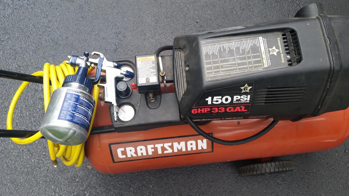

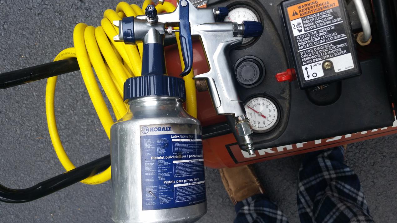

So how did you spay on the diesel? Mine has no rust, but I want to coat it to protect is from rust this winter when I ski, if my body will give me one year of skiing.
What did you use to scrape the surface rust off? Or did you walnut blast it? Also, how long did it take? I need to do the same but am considering taking it to a shop.

Did you just use a pump garden/weed style sprayer for the oil? This is great stuff
This is everything needed to spray the oil. Got the spray gun from Lowes. I sprayed used 15w-40 motor oil that came out of my previous diesel truck. It's thick and black.
I simply used a cordless drill and put a wire wheel on the end of it. It did a good job.
