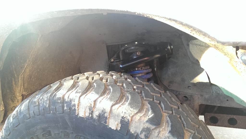

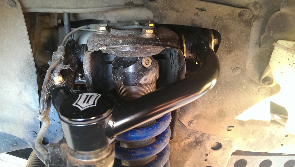

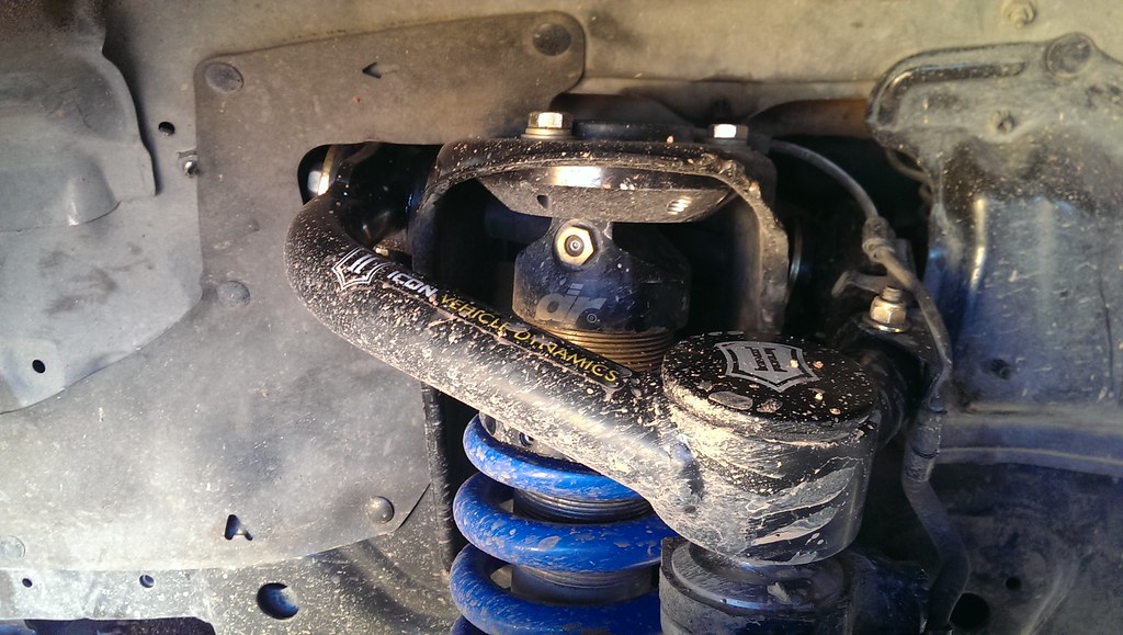

I recently decided to finish up the freshening of my front suspension with a new set of UCAs. Taking advantage of a smoking black friday deal i picked up some Icon Uniball UCAs without much hesitation. I didnt have a great reason for replacing the Light Racing adjustable UCAs that i have been running for the past 10 months. But, I did want something that I could essentially remove and re-install over and over if need be without totally wrecking my alignment. The past few months i had come to see the adjustability of the LR arms as more of a curse than a blessing. And i knew the mounting bushings were on their way out. So i was going to have to pull them to fix them anyway. I had an earlier rubber bushing design that has since been updated to a more modern and durable Poly setup.
The hardest part about the swap was getting the old upper ball joint adaptor out, the Icon install was easy as pie. If anyone has questions about either let me know. I also love the new uniball caps that Icon came out with, i think sealing off the top will lengthen service life of the uniball greatly.

Clean and with just the Icon shield anodized into the ball cap.

Dirty and with double logos.

You mentioned replacing the front UCAs, did the Light Racing ones go bad? Im wondering why they are giving you a free set.

What are the pros to the Uniball itself. I need UCA's for my ext travel icons i have waiting to be installed. If you sell me on them, i'll get those. If I still want the LR, i'll buy your's when you get them back!
But for now can you go into more detail on the icon UCA's?

Always great to have you stop by here Brian, your a wealth of knowledge around here! Yes, the rubber bushings in my LR arms blew out in the 10k miles that i ran them, it was an old style rubber design that has since been replaced by a new and improved poly setup that they are implementing on all of their arms now.

For me, down here in the southwest where wet weather is pretty scarce and i dont usually let my truck stay dirty after wheeling, the sealed ball joint of the LR arm wasn't that great of an advantage over uniball designs that are offered. I just made the switch to go with something that was a solid bulletproof design made by a company that i know and trust. Less wear items on the Icon arms as opposed to the LRs and i wanted the simplicity. I can deal with replacing uniballs every couple of years as they wear out and develop slop, i just dont like the idea of a failure on the trail or highway from a ball joint seperation or worse that has happened to a handful of LR arms in various applications.

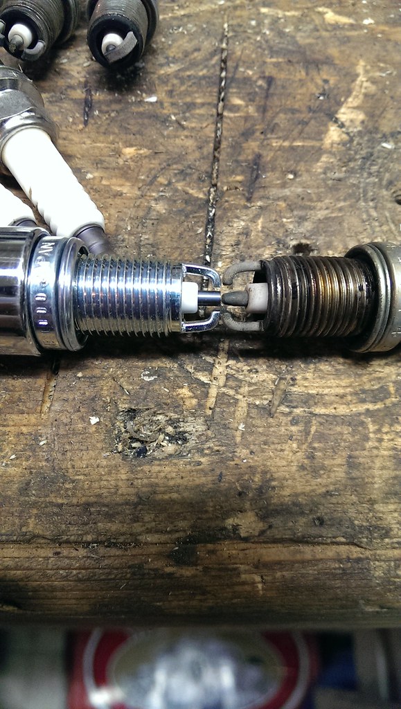

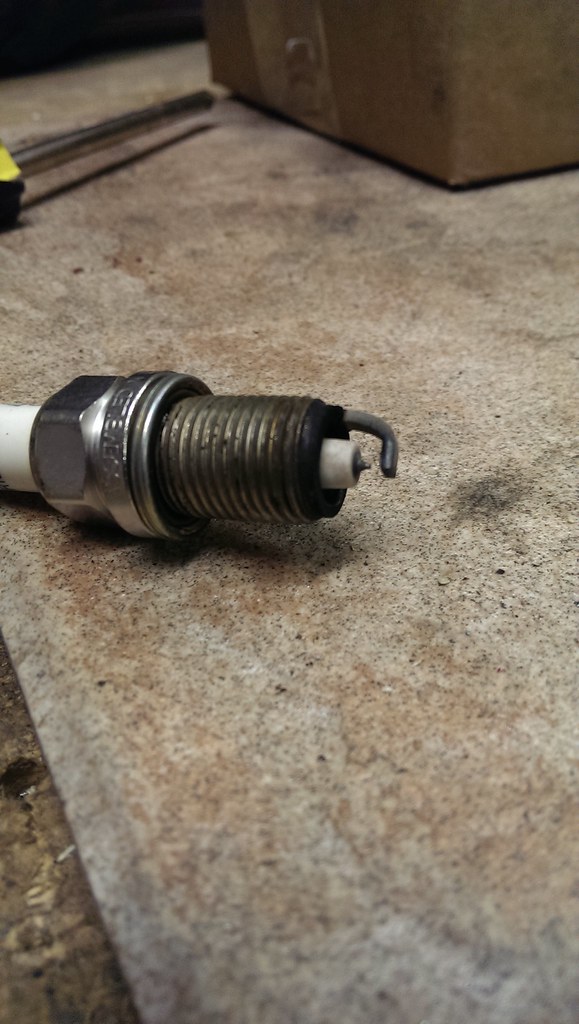

Been busy making some big decisions in my truck's life lately, tweaking setups and fixing problems til i have everything dialed just the way i want things. Maintenance was needed first however. Within the last month i did a full synthetic oil change complete with oem oil filter. Also replaced the air filter with another OEM Toyota filter, i was surprised to see it was made in the USA. :usa2:

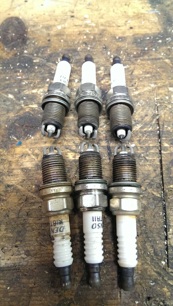

Next, I replaced what i believe were the original plug wires with a NGK TE66 kit along with some fresh dual electrode NGK BKR5EKB-11 plugs. The 5 of the 6 plugs i pulled were duals, 1 was a single oddly enough. I didnt think they were that bad until i compared them to the new plugs and i saw how wore away the old electrodes were. I cant really tell if the truck runs any different since the updates but i know it cant hurt!
Old plugs.
Untitled by natemob7, on Flickr
Total shit plug.
New vs. Old.

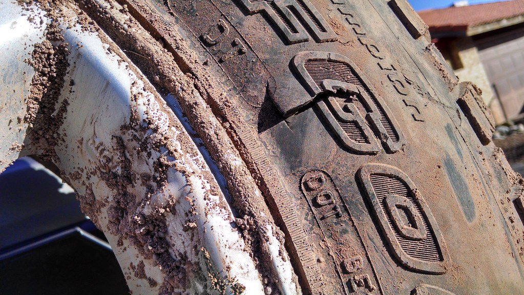

How'd that tire get so dirty back there?
It was my driver front and a rock ripped a hole in it! Luckily i always carry a fullsize spare and i had it swapped out in 15 minutes or so and the fun continued. :lookout: The gash was in a very thick part of the carcass down near the bead, must have hit it just right. I was aired down to 18lbs went it went.
