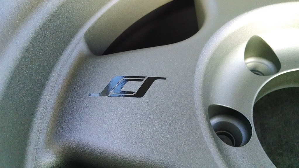

I have been looking at and wanting new tires for some time now, I just never could decide on and commit to a tire design and size that i was really into. All the while looking only at 17s, i would occasional peruse the 16" offerings but had no intention of buying new rims. My Tundra wheels with 1" spacers were the perfect width to not rub in the front when stuffed and turning, they were beat up from lots of rocks and i didn't have to worry about ruining them since they were already "broken in". This went on for several months.

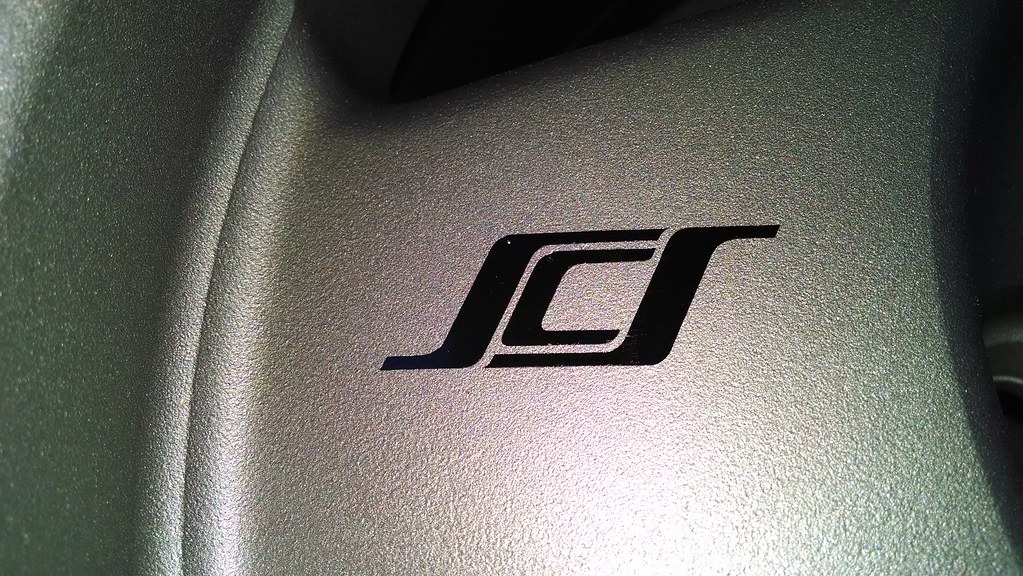

I have been keeping up with [MENTION=63060]rickashay[/MENTION] 's Tom Cruiser build and have always liked the look of his Limited Edition, Matte Grey, Deep Dish 3.5" backspacing, SCS F5s, man they look incredible on his truck. I checked them out around the start of December, and got in touch with Vin. A few emails later i pulled the trigger on 5 in the same flavor as Addison with black spline lug nuts. I did have Vin add the black SCS logo to the rims to help tie everything together. What an exceptionally entrepreneur and enthusiast, I couldn't have asked for a better buying experience and can't remember making a purchase where i was kept so informed on my order. They arrived in pristine condition with a couple decals and a hand written "Thank You" from Vin himself. They are insanely light at only 18.4lbs each, my old 17"s were 27lbs apiece. Nice weight savings that will help negate the increase in tire weight.

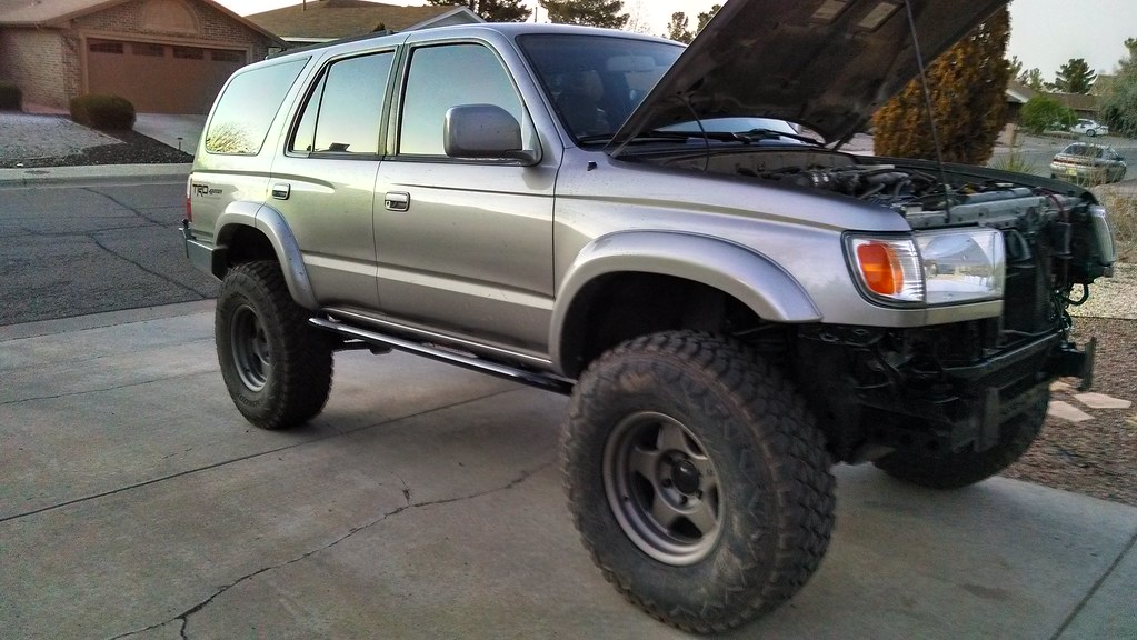

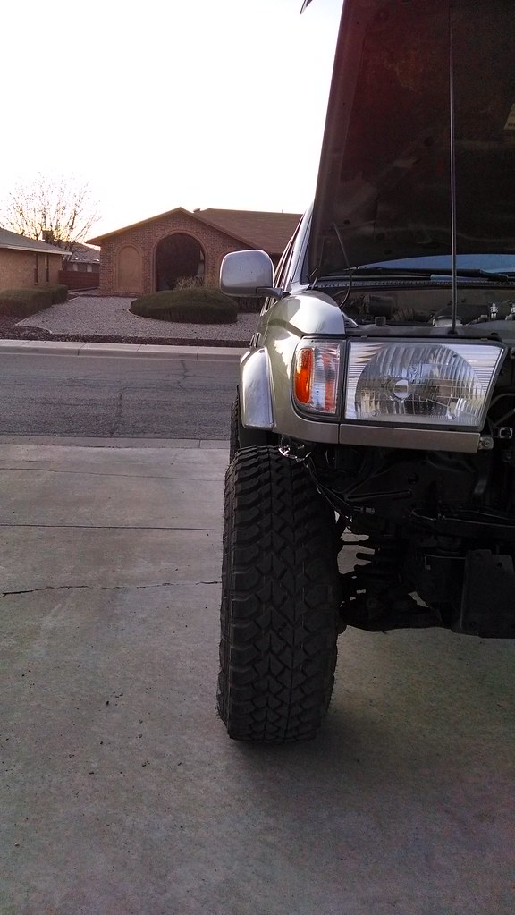

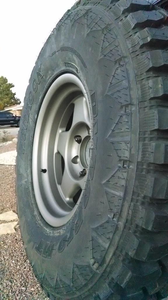

For tires i went with a load range D 295/75/16 Hankook Dynapro MT. The manufacturer lists them as 33.6" tall instead of the 33.4" that the metric size converts to. So they run big for their size. Yay. The sidewall has a nice look to it that goes well with the tread. And the tread, looking like it was chiseled and carved as opposed to molded, nice crisp edges and anti-pebble bars between the lugs. The rubber compound does seem a little soft, i wonder where the tradeoff will be between traction and treadwear. 64lbs each.
My old tire and wheel combo was close to 76lbs.
Tundra 17" 27lbs
BFG MT KM1 255/75/17 49lbs
New setup is close to 82lbs.
SCS F5 16" 18.4lbs
Hankook Dynapro MT 295/75/16 64lbs

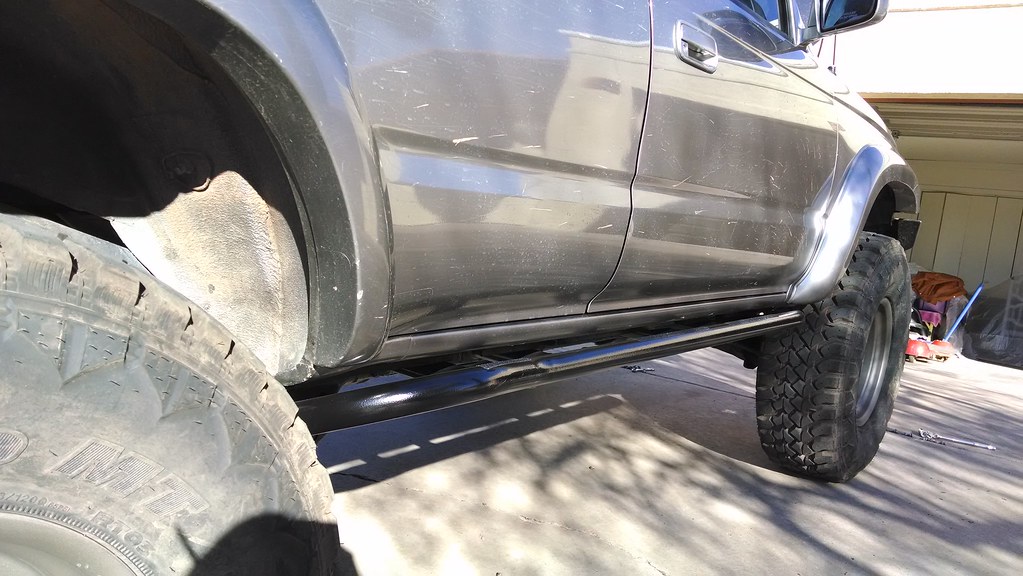

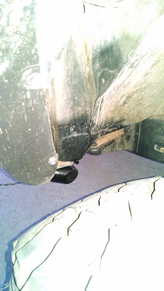

Once mounted i was a little worried, they rubbed. A lot. I had previously hammered back my pinchweld for clearance, i needed quite a bit more. I took about 1/2" off the front of my sliders then welded in a 1/8" disc that fit the tube ID perfectly. I went pretty much by-the-book using [MENTION=67615]Dirtco[/MENTION] 's method for running 35s with lots o backspacing. I still need to gut the inside of the fender flare a bit more because they rub while turning and stuffing a tire. Happy to report they fit the rear perfectly with my shock and bumpstop setup. They make contact with the smooth slope of my rear bumper at the same point that they ever so slightly touch the inner lip of the rear fender. All as the bumpstop compresses 3/4" and the shock is 1/8" from bottoming out. Its close, i will probably lengthen my bumpstop setup a little just for peace of mine. Not worried at all about the bumper rub, but i do intend to trim the inner fender ever so slightly.
Can't see much after painting it black but it is all nice and smooth if it does still rub.

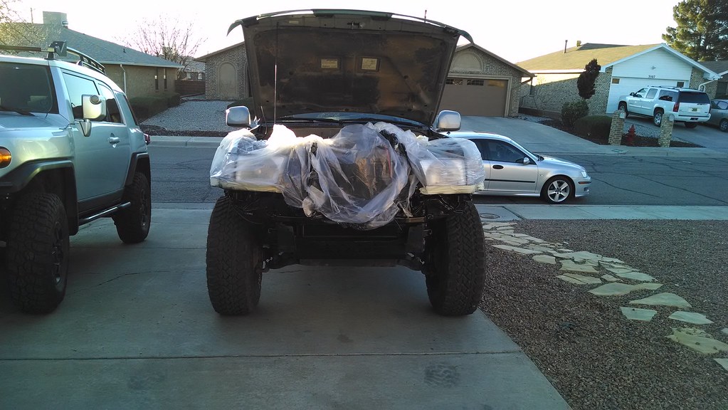

Today i went ahead and pulled the CBI so i can get it cleaned and up for sale. I knew with the small gaps produced by the BL i wanted to paint anything below the fender line to help blend body into bumper. I painted the underpinnings a satin black and plan to do the bumpers in gloss black, i already sprayed the sliders and am very happy with how they look and contrast with the truck.
All taped and drying after a first coat.
