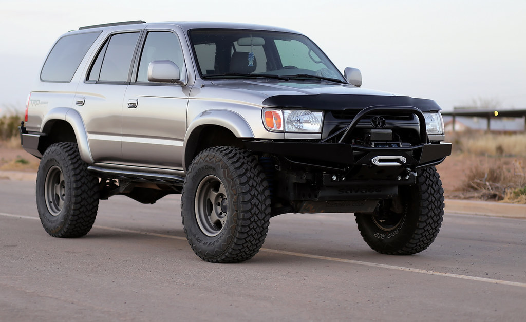

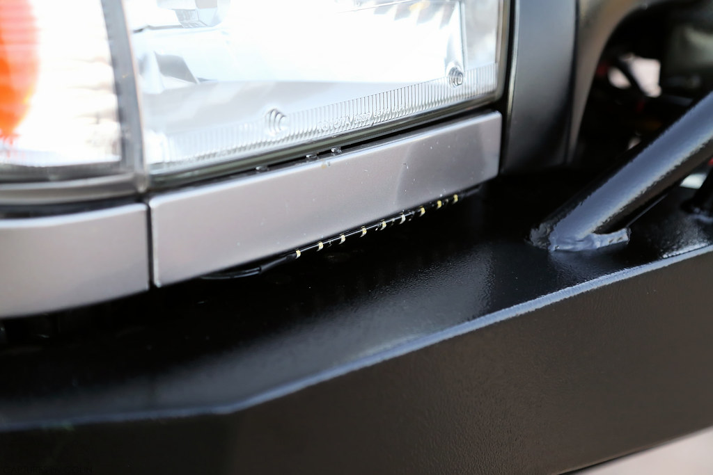

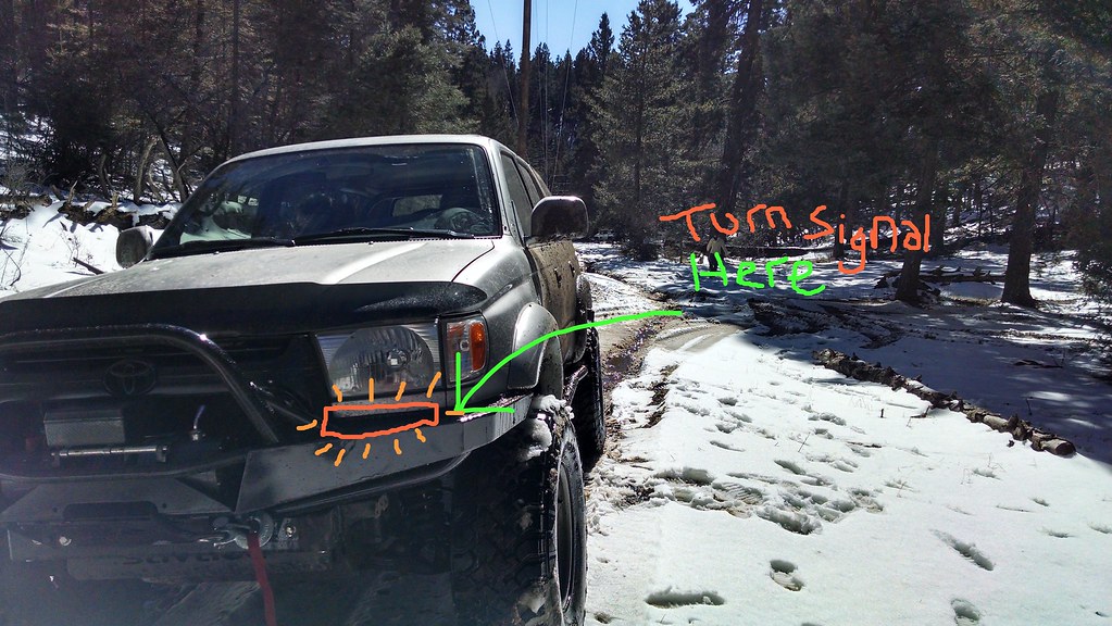

I knew when i ordered the AOR bumper i wanted no turn signal cutouts for a smooth look for the front end. But i didnt want to copy [MENTION=67615]Dirtco[/MENTION] or [MENTION=34852]crazydubman[/MENTION], nor did i want to cut up my parking lights. So i put on my thinking cap for a different way to do my turns.
I have a 1/2" body lift that left a small gap in the front where the bumper meets the body, I decided i wanted some thing inconspicuous to fill that space for my turn signals. I ordered some 6" waterproof Amber LED strips from oznium and tapped them into the original wiring harness.
The factory filler piece has a perpendicular lip on the bottom thats about an inch wide that runs the full length of the panel, i put it in my vise and bent it to about a 65* angle, taped it off and painted it semi gloss black to keep things incognito. Once the bumper was on i adjusted the angle so i had about an even 3/8" gap from the bumper and stepped back to admire my work. I hate wiring so even something as simple as this i felt accomplished not tearing anything up in the process. I am pretty happy with how they turned out, i dont think they look tacky since they are fairly hidden and they work as i hoped. They blink.

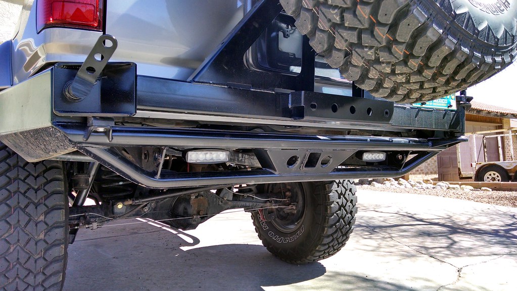

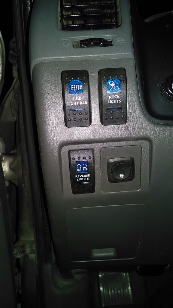

Been working on some electrical upgrades lately, not the most fun projects for me but things turned out good. Added some cheap eBay lights i bought a couple months back, wired them to a Carling switch in a factory blank spot. I liked them back there for backing up, camp lights, and of course any ******* that decides to ride my ass while i am cruising in the right lane.

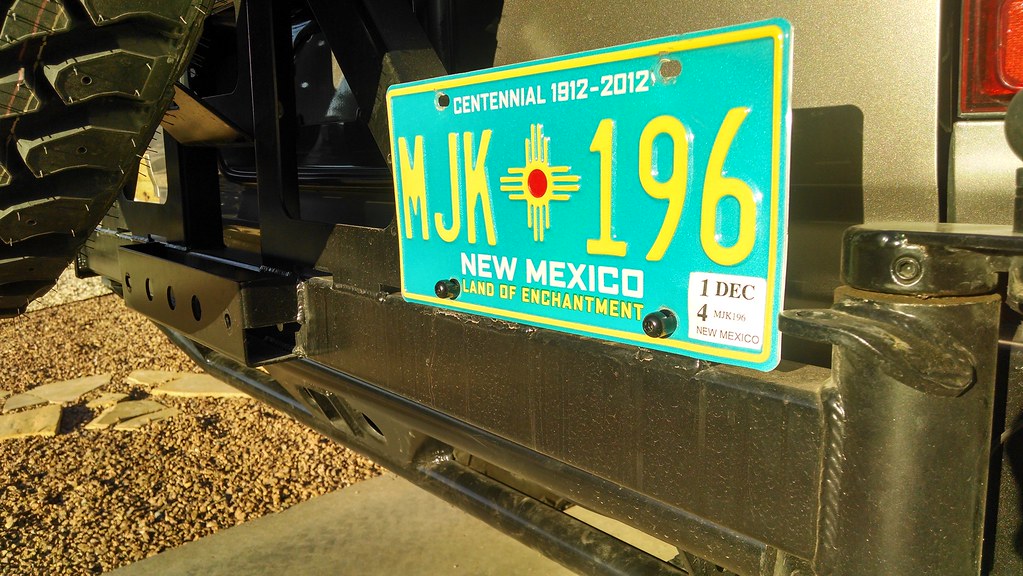

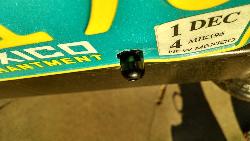

I've been riding dirty for the last year without a license plate light, CBI failed to send me one initially, I didnt realize until looking [MENTION=58830]JWaldz[/MENTION] truck that it was supposed to come with a cheap little light that was apparently very low quality. I had seen these bolts that have LEDs in the heads of them on motorcycles and cleaned up hot rods in the past, i thought they would be perfect to get me legal and still keep a nice and clean look. I got these from Oznium, the quality is excellent and i would recommend them to anyone looking to do the same.

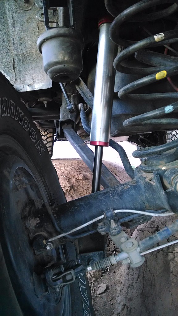

New Shocks! I scored a badass set of Sway-a-Ways from [MENTION=34852]crazydubman[/MENTION] that were on his wife's truck, they happen to be the same shock that he runs on his own truck. A good quality set of shocks were the final piece to my suspension puzzle, after ditching the 5150s I can finally say that my rear setup is capable of keeping up with my front end. I cleaned the bodies up with some scotchbrite and lightweight oil and they look new. These bad boys have a spherical ball lower mount that bolts right on and has a 7/8" shaft! It's beef to the max.
These are built and sold for 4th and 5th Gen 4Runners, and also the FJ Cruiser.
THEY FIT WITHOUT MODIFICATION.
I can confirm that THIS shock requires no top mount drilling or special bushings to function properly. There is a serious lack in quality rear shock options marketed towards the 3rd Gens and i hope that this at least opens another option up to those looking for something that doesn't require an adaptor (PITA) and are running a taller lift that can benefit from the longer length of the SAWs. I dropped my bumpstops a little to keep my tires off my flares and bumper and to keep from blowing out and bottoming the shocks. :reddance:

They are a 9" travel shock.
Part number is 52000-108-14LT.
Here is a link to them on wheelers site
Sway-A-Way Extended Travel Rear Shock Set
They are an inch longer than the factory 4th gen shocks which are a couple inches longer than factory 3 gen rears. Factory 4th gens are about what the 5100 bilsteins are for the 3rd gen.

So far do you like this option better than our outboarded shocks?
I messed up the angle of the shocks when i welded the upper mounts to the frame so they were never perfect. And i would get some pops and noise from them as the suspension cycled top to bottom. So that was my own fault. I wanted new shocks and wanted to go back to the stock location so thats why i made the switch, the shocks feel great on and off road though so i dont miss my 5150s the slightest.

Thanks Todd, and yeah the shocks are working out great. And the flare/fender trimming isn't done yet but its getting there. Ive got the rubbing controlled for everything except when tires are straight and fully stuffed they rub the inside of the flare and fender with the outside edges of the tread blocks. I need to trim about an inch and i could jump this beast without any rubbing!

What travel shocks are they?
yeah and whats the model number?
Thanks again Todd, these are some killer shocks and wouldn't hesitate to recommend them.

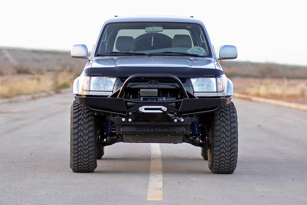

when i got the CBI i did a nice photoshoot for it, its only fair i give the [MENTION=17736]AddictedOffroad[/MENTION] bumper the same treatment.
wrinkle black by natemob7, on Flickr
quarter by natemob7, on Flickr
front by natemob7, on Flickr

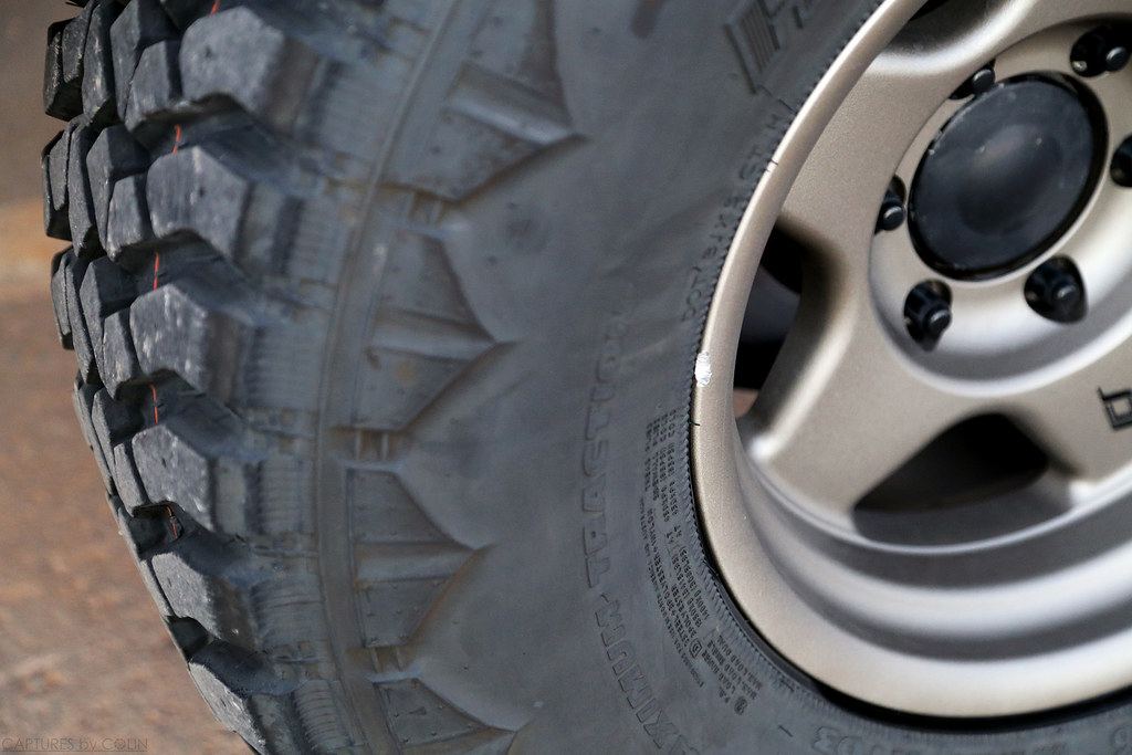

first scar on the new wheels, since this was taken the only cherry rim left is the spare.
gash by natemob7, on Flickr

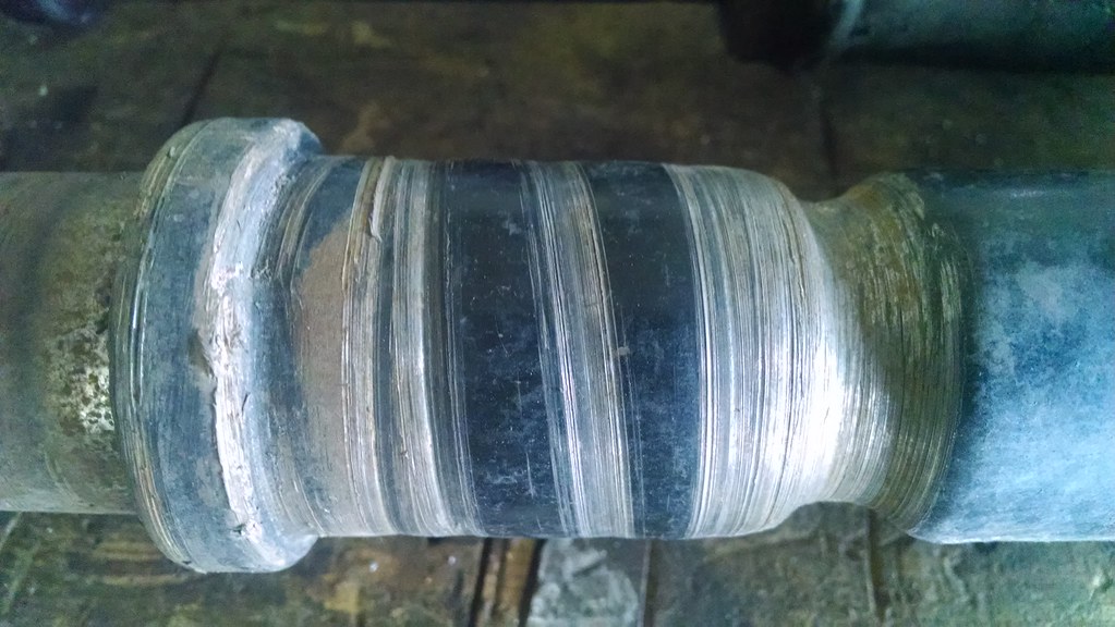

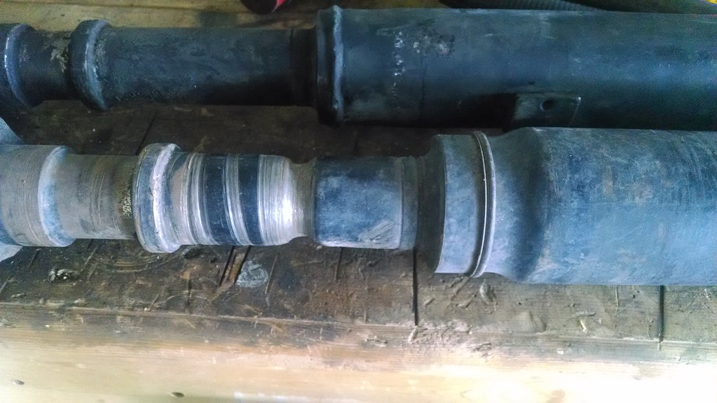

Unfortunately no skids out there protect the driveshaft. :twitch: Ive been getting some crazy vibrations at highway speeds and after having the tires rebalanced i think i found the issue.
Untitled by natemob7, on Flickr
Spinning and sitting on a rock ledge caved in the slip yoke portion of the driveshaft, judging by the candy stripe extending past, it looks like i made the climb.
Ill be getting another driveshaft built while I'm gone and plan to keep this one as a spare.
