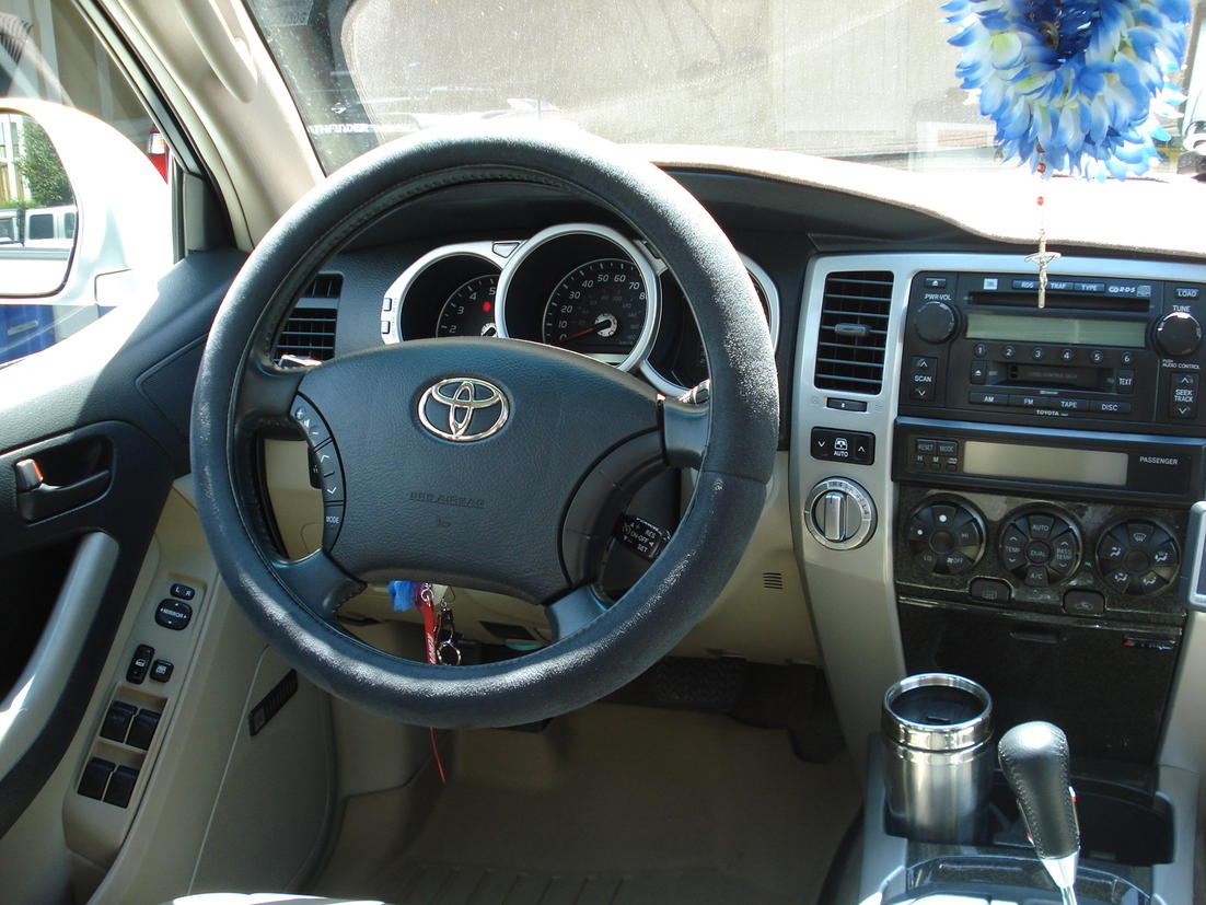

That Kenwood looks more "user friendly" than the Pioneer. The video says it has the DNX6140. I know nothing about RDS. Heck, i don't even know what TRAF is and what each RDS, TRAF, and TYPE does. Here's a photo of my OEM. I'mma play with it sometime and see what each does.
