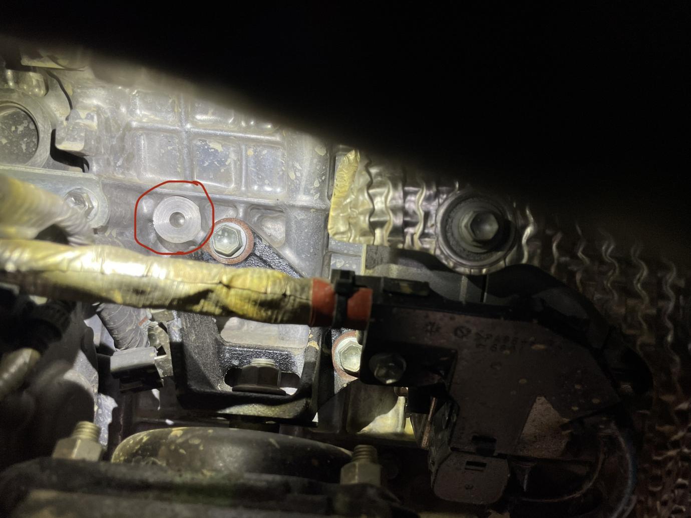

On my 2021 there isn’t even a bolt at the driver’s side engine block drain location, just an empty hole. Looks like they went from valve, to bolt, to completely sealing it off. I’m wondering the best way to get those last few quarts of coolant out … lower radiator hose?

Just keep filling with plain water until your lowest “accessible” drain point runs clear?

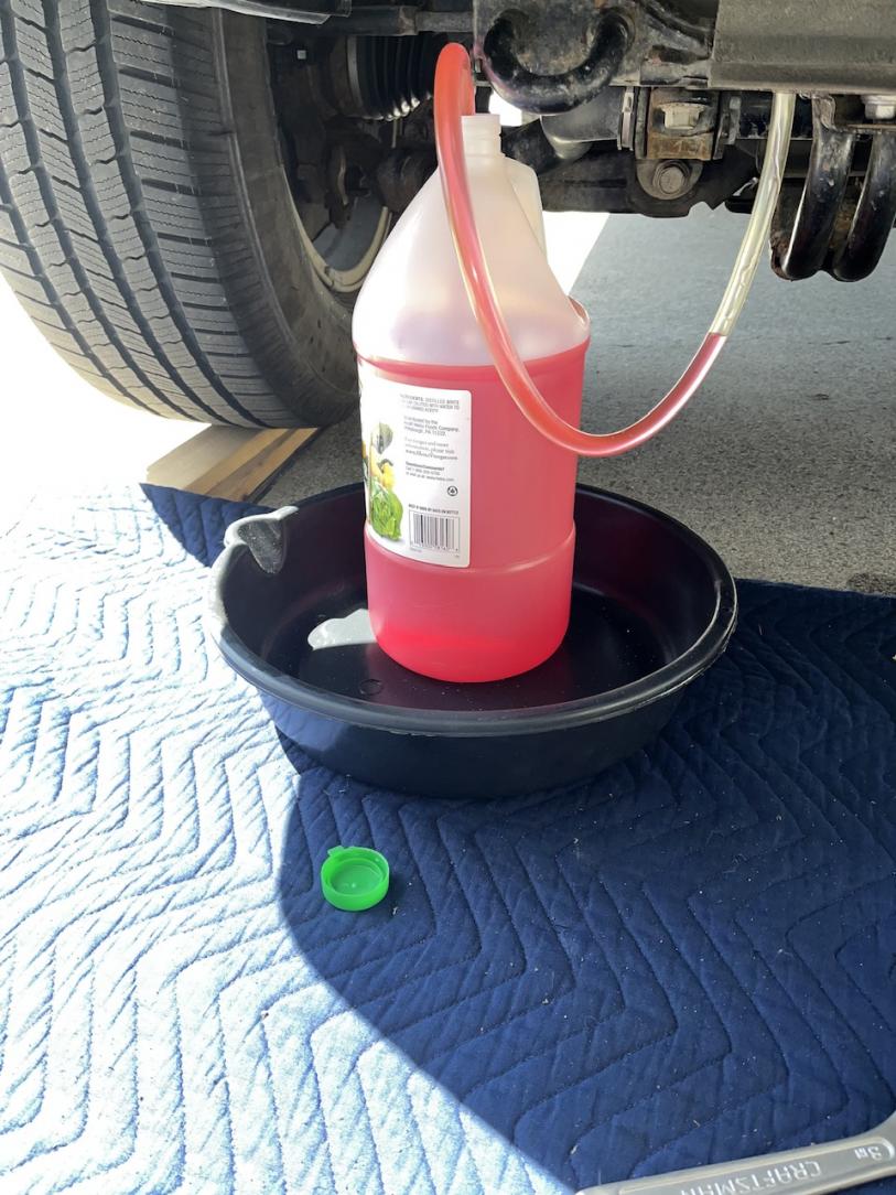

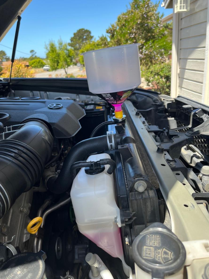

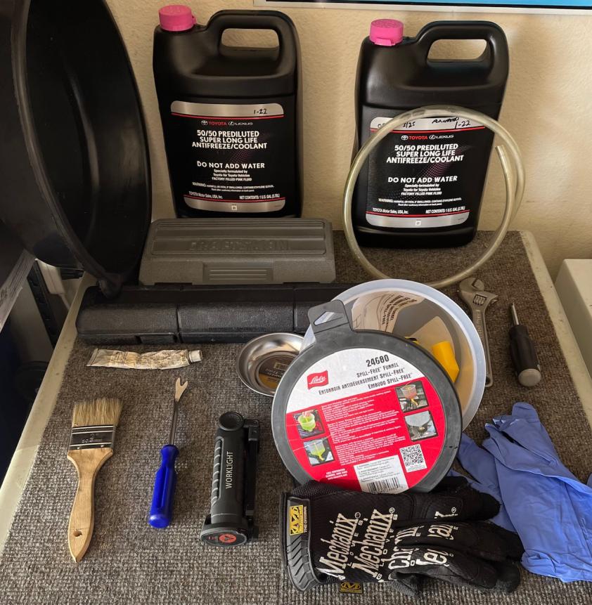

Did my third coolant change today.
150,819 miles. Interval is 31,032 miles and 42 months.
Radiator drain and fill only. Just over 1 gallon.
Got my coolant from Lewis Toyota for under $19/gal.
Out: Toyota Super Long Life
In: Toyota SLL
