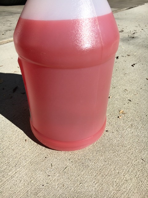

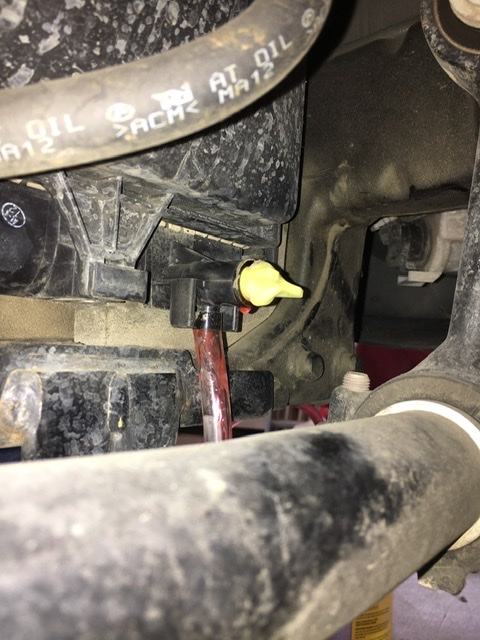

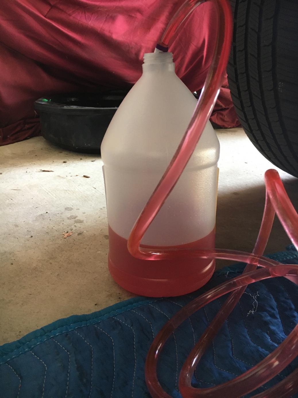

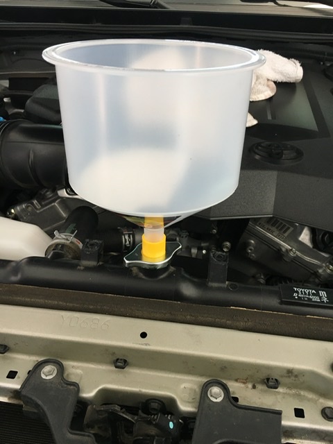

I changed my coolant today. Since the stuff that came out was clean as a whistle I decided to only do the radiator and reservoir drain, barely got more than a gallon. I think I’ll just do partials like this every few years since Toyota doesn’t really recommend normal “flushing” type flushing.

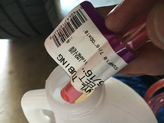

Drain Tubing ID is 5/16”
Interesting note, I’ve got a Lexus dealer close to me so I thought I’d buy the coolant there. $39/gal. Twice retail. We used to call that the FTC book price. Toyota dealer was better but still about a $2 over retail at $23.

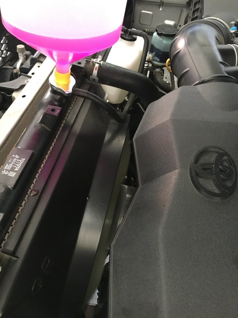

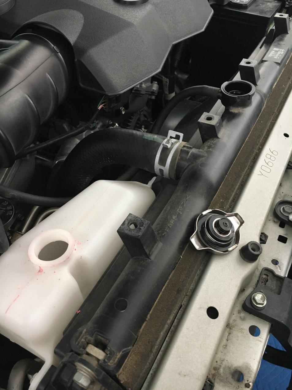

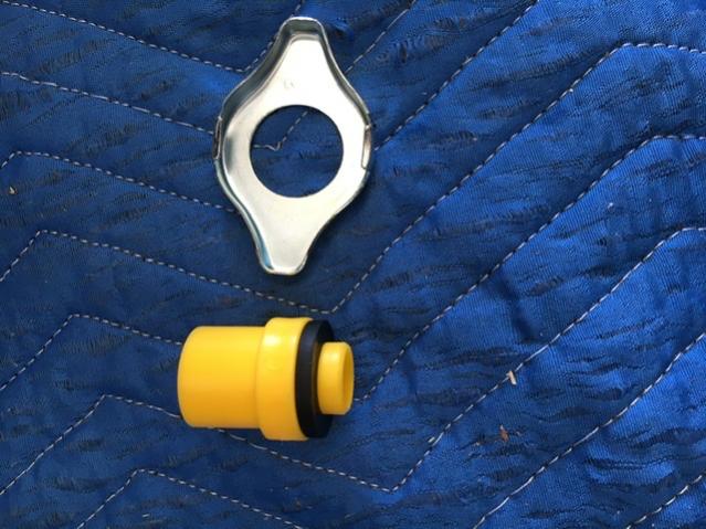

More pics.

When I did mine a year or so ago, I just pulled the lower rad hose and popped out the passenger side plug. Good enough for me. I remember it being super easy to burp after. I think I put the front on ramps and had the rad cap off, started it, let it run until the thermostat opened and the coolant level went down, added more in the rad until it was full, and the job was done. Way easier than most other vehicles I own or have owned recently (Jeep/Infiniti). Obviously monitor the overflow tank for a few days after so that you can make up for any additional air getting worked out by adding coolant as needed.
Totally agree with you that burping was a nonevent. Thinking about it overnight I’m a little disappointed I did a half-assed job. I might revisit this sometime in the next year. According to the Toyota parts website there’s a dealer with much better prices in Sacramento ($14/gal). I’ll swing by on my next California road trip and get a few more gallons.

Saw that funnel on a youtube vid, wonder if Autozone or O'Reilly sells it?

I didn’t do the block drain and I got only a little over a gallon. After almost a year, I’m good with this method and will do just the radiator again next year.

Yes you can get the funnel at most auto parts stores, but it’s cheaper online. No idea what blue stuff you’re talking about.

In your picture the fluid in the funnel looked blue.

Pro Tip: Leave the radiator cap on when you open the Pee-Cock valve on the bottom of the radiator, as the coolant drains its pulls/sucks all the fluid out of the overflow reservoir.
