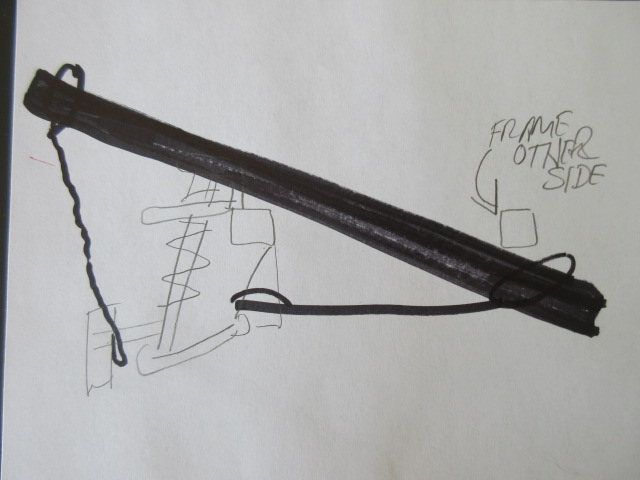

I'm thinking something similar to this, but maybe 4x4 or 6x6 to get less flex out of the wood. Say, 6x6 across frame where engine weight would do the trick, then 6x6 across several rafters to distribute the force, and a floor-to-ceiling pole jack in between to compress...?

If the Egyptians could move 80 ton blocks of rock without machinery you can do this easily. Use leverage where you can. I'm thinking stick a landscaping beam or 2x6 or some other strong enough wood under the frame on other side, tie it back to the frame on other side somehow, cause would lift frame otherwise. Ratchet strap the coil to compress to where want it. I think this would work fine.
