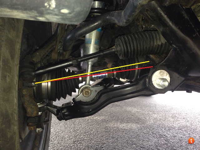

Only other thing I see is that the axle looks disjointed on the transfer case side. Have you tried putting it in 4 wheel drive or is yours a V8? The red line shows the center of the axle which looks lower than center on the t case side and the yellow shows where it should be if it were centered. These are the only things I can think of so I hope you figure it out or somebody with way more knowledge than me can help. Your truck looks really good BTW.

Thank you! Yes the axle seems pushed into the differential side where it adjusts laterally causing further limitation. I think it's because the LCA has been adjusted in
Your adjustment tabs aren't set for crazy amounts of in, but yes, it seems more pushed in than mine. Are you sure the CV was the correct one for the 4th gen? It almost seems too long. Did they replace the CV at the same time as the suspension? If so you wouldn't be able to tell if the CV was the problem, or the setup.

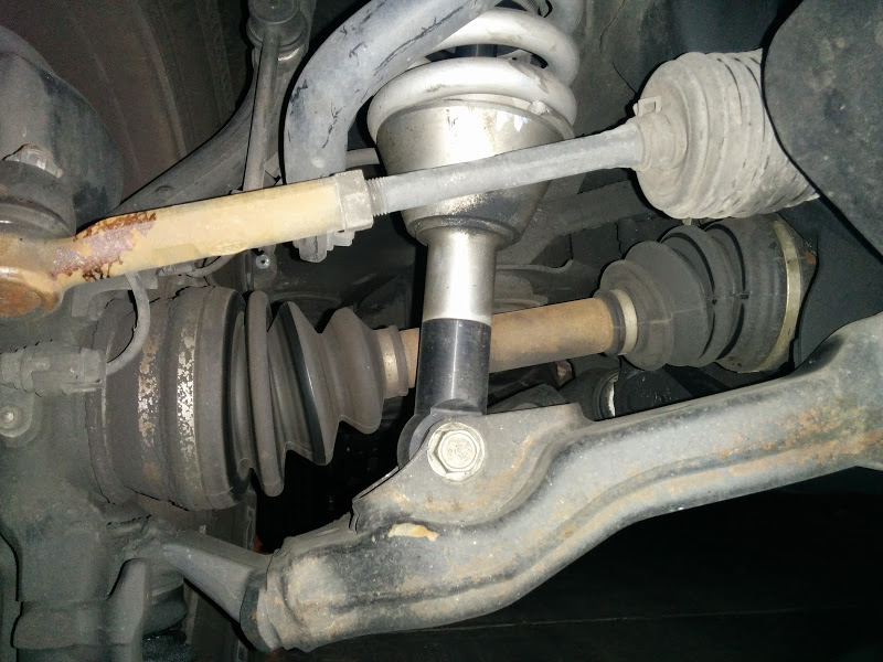

I have a bit of an update on my situation. Thanks to the suggestions by [MENTION=96713]drewm[/MENTION]; & [MENTION=93193]morphious[/MENTION]; i have been able to remedy some of my issues.
I ended up completely redoing the alignment myself. First off setting the lower eccentrics out nearly as far as they can be to give me more distance between the hub and diff. I then put the caster back more positive in the B postion of the SPC UCA's at 3.75 degrees. I adjusted the camber as close as i could and straightened up the tow as well as i could basically using an eyeball, level and an Iphone. (mind you this is only a temporary fix so i don't blow my CVs going over the next dip in the road at speed. It actually drives pretty nice though haha. I will be getting this aligned from a more 4x4 oriented shop shortly)
This completely remedied my CV binding on the passenger side at full droop. My ride height is now about 23.5" from center of hub to fender on both sides. The drivers side still has a very small amount of binding at full droop so i will probably have to remove the .25" spacer I used to even it out. The LCA bushings were torqued at full droop because I was running out of daylight last night and didn't have time to loosen, jounce and re-torque at ride height. That may help a little bit too with the sag at full droop when I loosen & re-torque everything at ride height.
I still have some vibration issues at around 40mph and also more pronounced again at 65-75 mph. I'm not sure but this may be a wheel bearing because my drivers side seemed a little gritty when i was spinning it while i had everything off the hub during install. I also have 1.25" spidertrax spacers on and with the addition of the lift might be causing enough additional stress to produce vibration that wasn't there before. It definitely sucks to change so many parts all at one time. Not real sure where your complications are coming from
