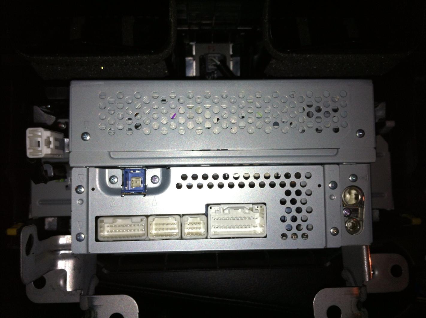

Hello all,
I have a '10 limited with JBL 15-speaker but NO nav, and found a factory navigation for sale but I'm hesitant because I'm not sure I can get it to work in my vehicle...
Has anyone here successfully installed a factory nav into their non-nav 4runner, JBL or non-JBL? And if so, please share how they did so and if all the features of the unit works, etc.
Thank you and hope someone can help me out.
BTW, I've attached a photo of the back of a JBL non-nav unit. It's slightly different than the non-JBL units. I've searched all over the forum but haven't found a picture of one yet so hopefully this will help someone here down the road.
I think the problem you will run into will be not having the correct wiring harnesses(wires) behind your dash.
For instance the GPS antenna, you probably don't have one of those hidden behind your dash, would the JBL-Nav system come with one of those? Or is it somehow built into the wiring harnesses?
Another thing is the backup camera. the Nav system has the camera feed running from the rear camera to the nav. Even if you had a nav unit put in there, i dont think the plugs you need to view the backup camera would be there, not to mention the reverse sensing feed.
My backup camera feed goes into my rear view mirror. There aren't any feeds behind my dash, i had to run my own wires from the rear view mirror to my dash.
I don't want to discourage you, just want to bring up some ideas.

Thanks everyone for the replies, they are all very helpful. I really like the look of the oem navigation and I'm comfortable using it, but ultimately I'm going to run into problems with the install which was my main worry... I guess the only way to go is aftermarket. I just don't like the look of it when installed, don't know how I feel about the empty space on the sides..
