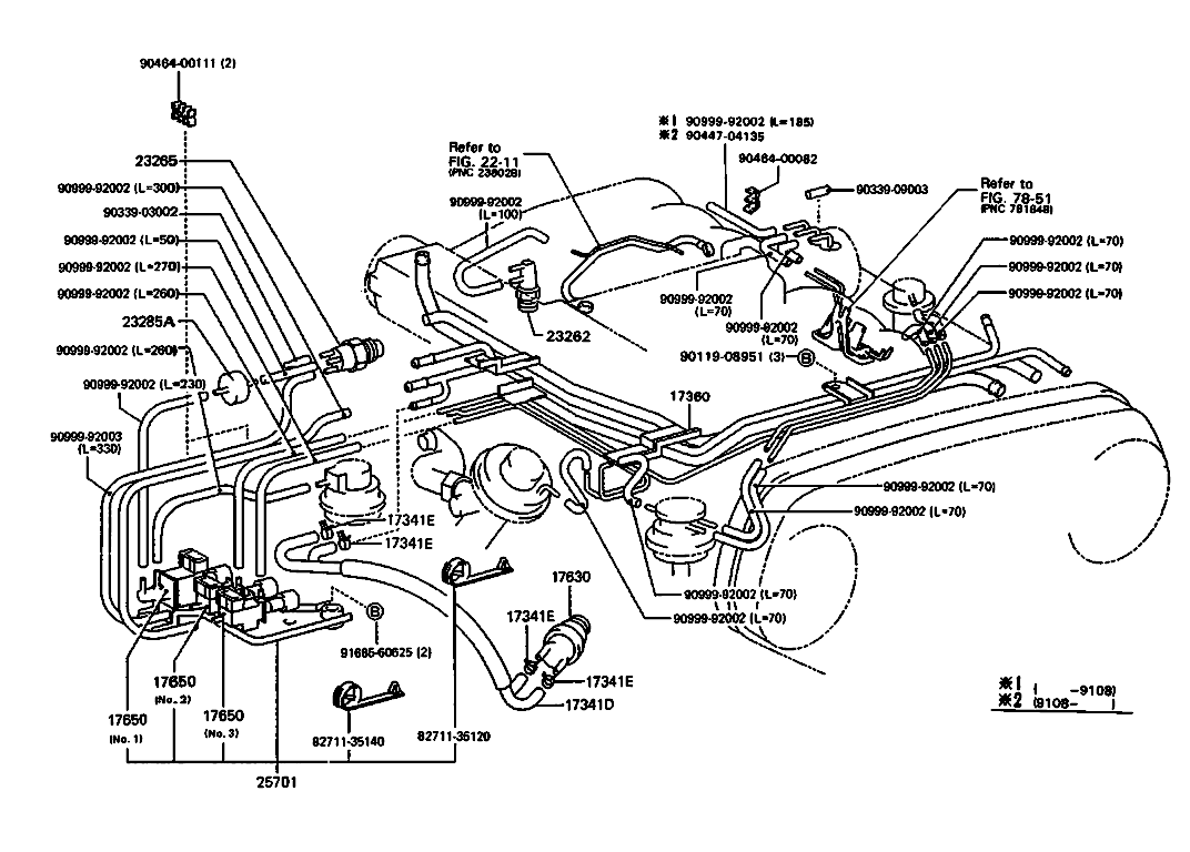

toyodiy.com is great resource for part numbers.. This one is for a 2nd gen V6
part number:tube assembly 17360-65050
part # 17360-65010 air tube assy 11-87 to 8-88
part #17360-65021 air tube assy 8-88 to 3-89
here are your part #`s speacial order though the 65010 is no longer available and the other # as far as toyota is concerned there are only 11 left in the whole wide world so you better get it ordered fast
