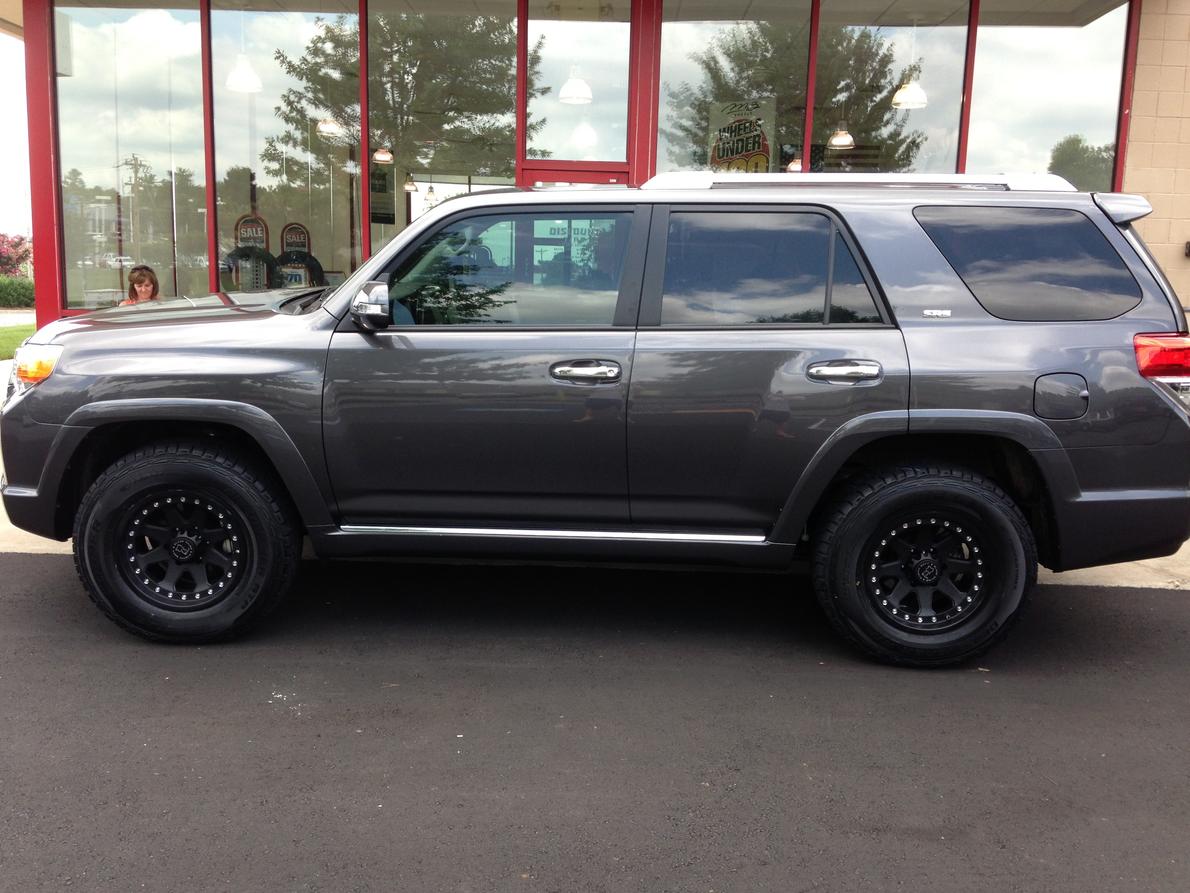

I ended up going with 265/70/17 Cooper Discoverer ATPs and 17x9 Black Rhino Imperial wheels. $1531 out the door with Discount Tire without trading in my old ones, which I thought was a great final price.
The tire does rub very slightly on my passenger front wheel well in a right turn sometimes. Makes me glad I didn't go with 285/70/17s... Would've had major rub I believe.
What do you guys think?
I'm not sure how you can have rubbing with a stock size tire. Do your new rims have an offset that is way different from stock rims?
Looking nice though!
Okki
They widen my stance just a tiny bit. I'll have to look up the exact offsets. The rubbing is almost not noticeable and only on certain slopes with a certain turn angle--- not even a locked out turn, which I found interesting.
