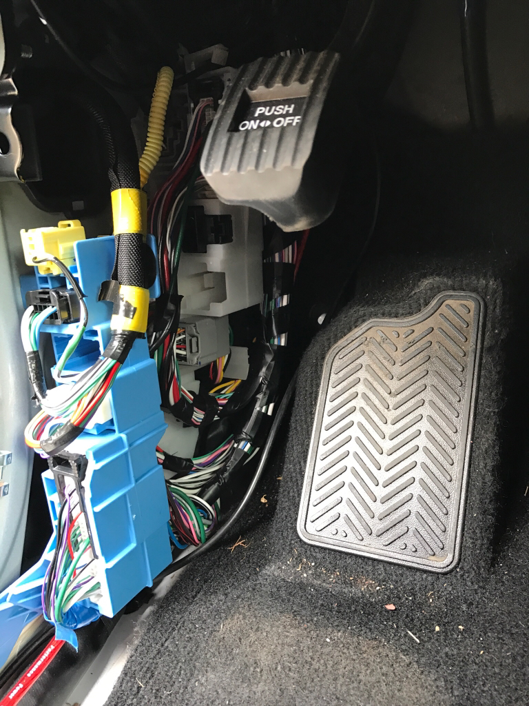

I have my amp under my drivers seat and need a good wire to tap into acc for the (remote) amp wire. Anyone know if there is a good one to tap into under drivers seat or behind the radio? I can't seem to find the radio wiring diagram for 2016 non jbl entune.

It gets tricky. The best way is to use a multimeter to test ignition-on fuses in the miniblock under the dash there. I used an add-a-circuit from the auto parts store and it works great.

Mini tap on p-outlet fuse drivers footwell fuse panel.
This method works. I know there are at least a few open slots that have key-on power. Or you could try one of the following;
Ignition 12 volts BLUE (+) DRIVER KICK PANEL WHITE 48 PIN CONN, PIN 7
Ignition #2 VIOLET (+) REAR OF UNDER DASH FUSE BOX WHITE 56 PIN CONN, PIN 52
Accessory RED (+) REAR OF UNDER DASH FUSE BOX WHITE 56 PIN CONN, PIN 48

Came here to make a joke, appears as though they have all been made already. As stated earlier easiest way is to whip out the multimeter and start testing fuses to see which one gets juice when the ignition is turned on.
Thanks for the help. I had a wire come off the amp while trying to get the remote wire figured out and it threw me for a loop. All set now!!!
