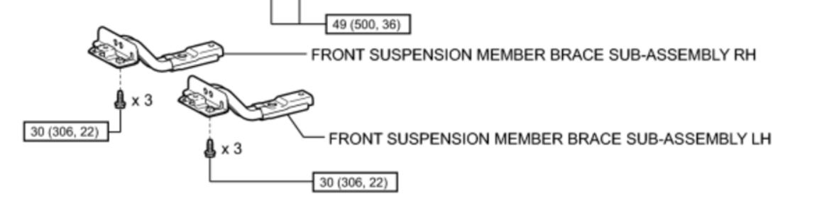

Does anybody have a picture of how the two
front suspension member brace sub-assemblies are installed in a 2015 SR5?
Mine got taken off during a bumper install. Trying to put them back on.
A picture of the part itself can be seen here
Thanks
It's this simple... Left of the screen is front of the truck. I would take a picture on my truck, but skid plates are on and I'm not taking them off LOL

front suspension member brace sub-assembly
Thanks. There is a photo on Shrockworks website that was very helpful especially since it shows the installed view of the front plate that comes with their front bumper.

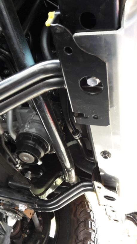

The shop where I got the bumper installed did not put this part back on and as you might guess they never could figure out how to put the oem front skid plate back on when i asked them to do so. Thankfully these were at least returned to me along with all the other stuff that came off during the bumper install. When i went to install the RCI skid plate, Josh from RCI was very helpful in pointing out that I had a missing part. So today I was able to find the part, get under the car and get the install done.
And here is a photo of "front suspension member brace sub-assembly" for 2015 SR5 (no kdss) should somebody someday ask for one down the road. It is installed over the Shrockworks front plate, which is barely visible because of the shiny aluminum glare.
