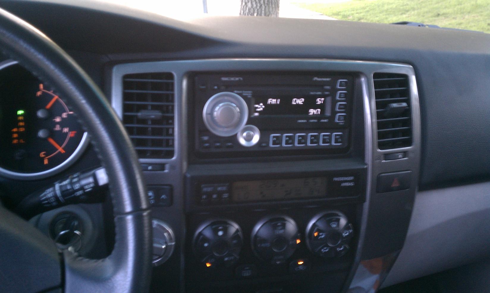

Quick and to the point, the AUX connection does not work on the T1814 Pioneer unit. So I will be looking for an aftermarket fix for my iPod as the FM transmitter sounds like crap and I will only be able to handle this so long...
On a bright note, the T1814 sounds great and looks good. Definitely an upgrade from the base stereo (keeping in mind I have already replaced the speakers with Hertz). CD sound and even radio have improved. Install took just under an hour.

broke e7 - in case you overlooked it above, here is a link to my post that will show you how to solder an inexpensive USB cable to the head unit that will give you full USB and iPod functionality - I installed the T1814 in my 99 4Runner and my wife uses her iPod 5th Gen with no issues. It's not that difficult to do and so much better than an FM transmitter.
I even swapped out the 29 tiny surface mount LEDs on the faceplate from amber to green so it matches my wife's 4Runner illumination.
