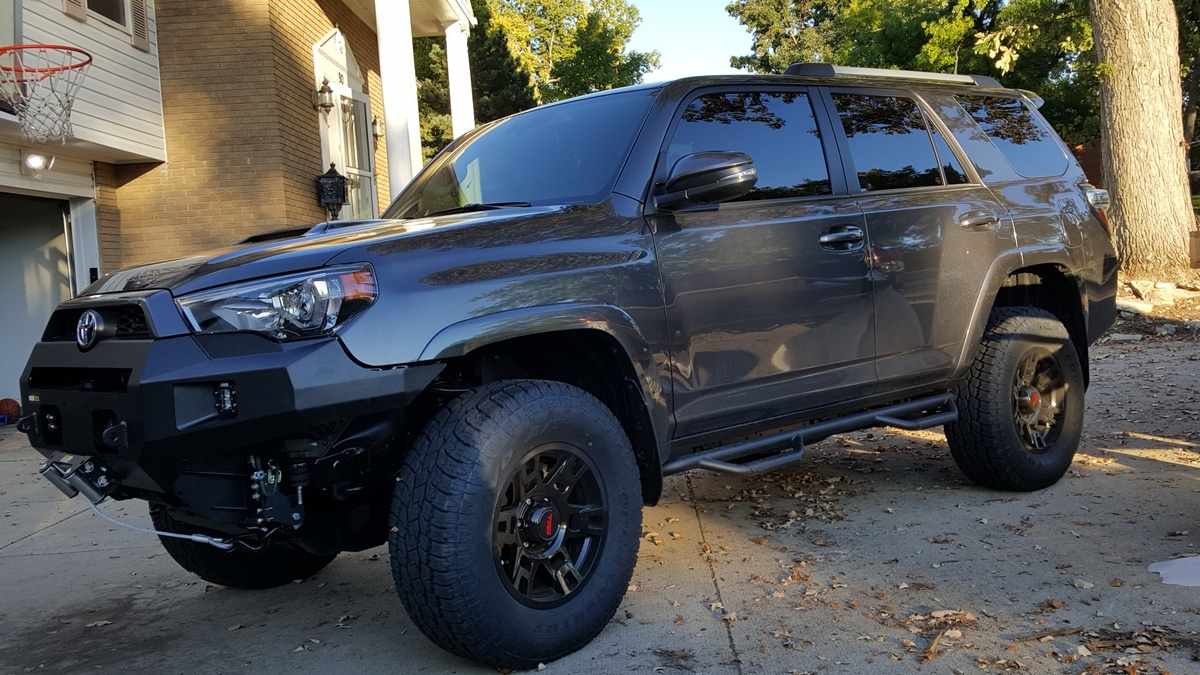

Here is my personal assessment.
1. Ordering a MT4x4 Pro Front End is really just adding a plate to sit on top of this (see pic). There are a total of 4 holes up top center. 2 per side by where the toyota emblem would meet the front bumper.
2. NON Pro bumpers can order their add on PLATE and then order the black grill from Toyota.
3. I don't know the additional plate will mount or sit (flush or not, etc) but take a look at the pic and you'll have an idea. It looks like it'll sit on top, not being a "smooth" look.
IMO, still all good... Not as CLEAN as some may prefer.
I personally think MT4x4 should've just gone with a straight "PRO" no cut front bumper and advise buyers to buy the black grill (top) from Toyota. or, manufacture their own.
Good luck!

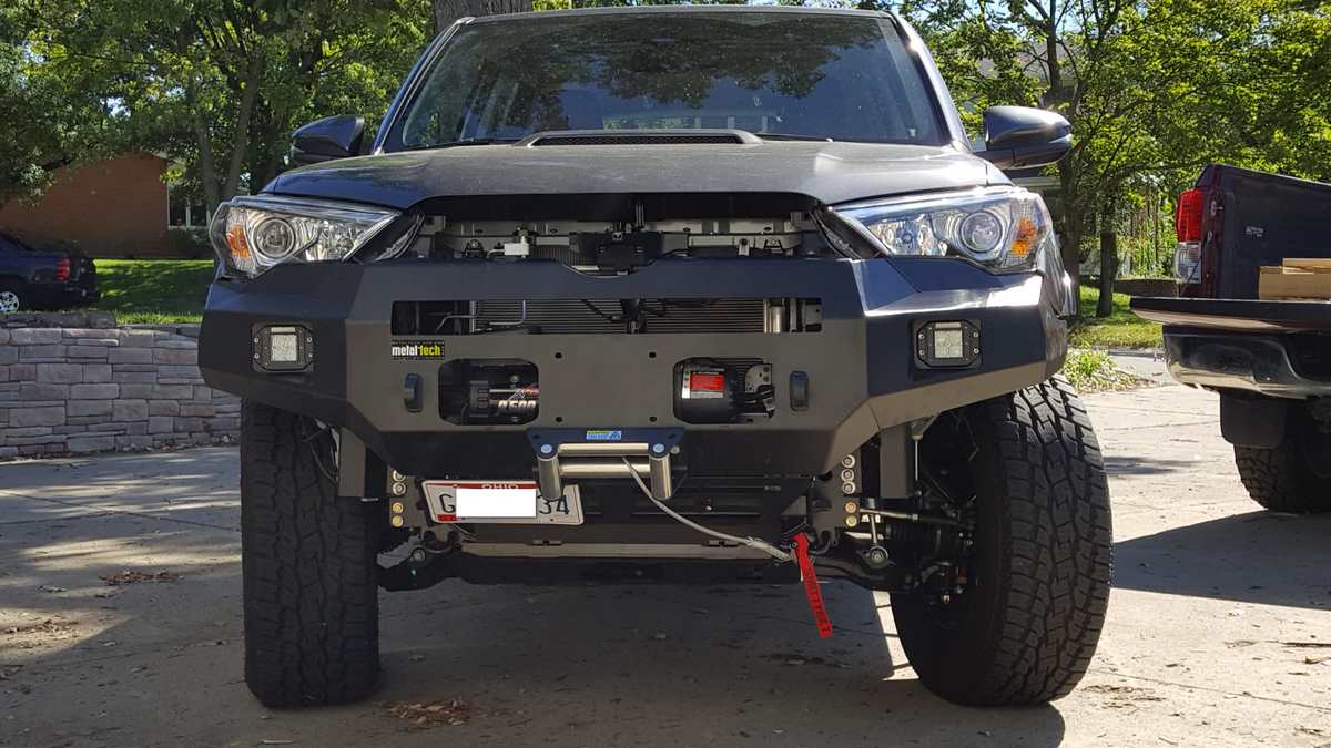

Given that i just went through the installation. I find that it is easier to mount the auxilary mounting plates to the primary bumper chassis (winch mount) prior to mounting it all up to the chassis. Alignment, ease, would be simpler.
I installed the auxilary plates after the primary bumper (winch mount). It was a bit tough to align everything up so I had to unloosen the bumper (winch mount) and bust out with the airtool to get it all in place.
Those two black metal pieces are meant to sit by the power steering lines. I didn't use them. It is cut and angled to seat by the bracket on each side.
lastly, I'll note that I completed the install with extra BOLTS and other MISC. hardware.
* this pic includes other misc hardware not part of the bumper kit*
Thank you.

Just got done installing mine. Overall AWESOME look, fit and improvement. I will go down the list of pros and cons.
Pros:
-They had it in stock and I had it in about a week (truck ship from Oregon to Ohio)
-Easy fit and fairly easy install* (see cons)
-It looks BAD ASS
-Great communication
Cons:
-2 medium sized bag of nuts and bolts and zero instructions
-4 extra parts aside from the obvious ones. I figured out the bumper support bracket, but not the hose guards (until i found this thread)..again, zero instructions
-the 8 bolts that attach the bumper needed washers to get a good bite. They weren't included, which isn't a big deal if i knew that before i had it all torn down
-There is a bolt that attaches the bumper support bracket that is not included nor was it in the factory threaded hole. Had to go to ACE to get that bolt and the above washers.
Overall, it was an annoyance not to have instructions, washers, and the 2 missing bolts, but in exchange for the bumper looks, design, and overall quality, I am happy.

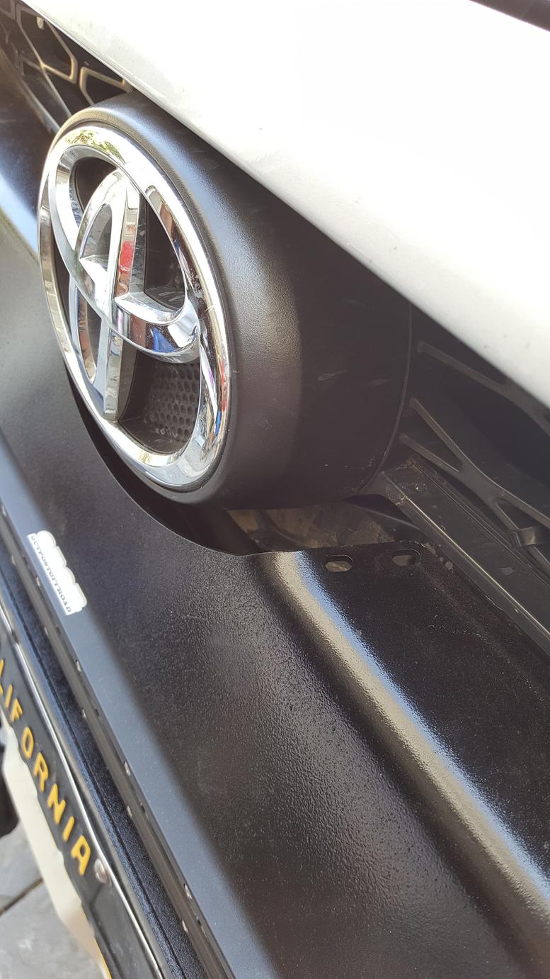

One thing I did on this install to make the license plate less obtrusive was to mount it lower. Not sure how this will fly with the cops, but if you have seen how sport bikes mount their rear plates (under the fender) it's not bad all things considered. do it at your own risk. but with my windows illegal, i'm already a scoff law..LOL.
Next step is to spray the exposed bolts with truck bedliner for protection from Ohio salt and cleaner blacked out look. (grill not installed on picts. was in the process of spraying them with gun metal gray paint).
