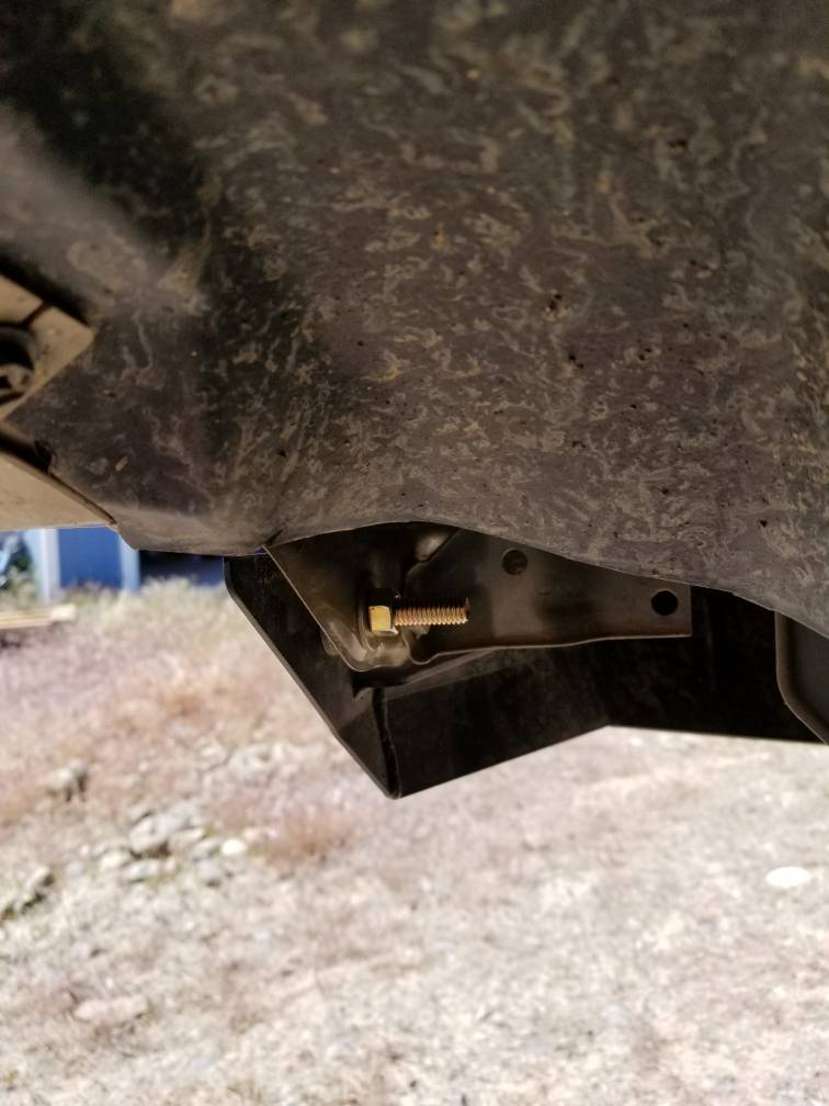

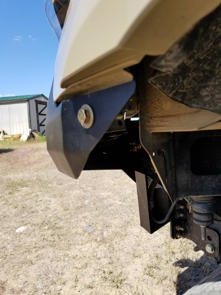

These little wings would bounce up and down smacking the fender above it. There is a 3/8 hole on the back side fender where a support piece for the old shell was. It's about 7/8ths inch down from the top of the wing and 3 inches from the end. Drilled a 3/8 hole. Bolted with 6 or 7 washers as spacers. No more bang.

I would challenge that this wing rubbing is due to incorrect installation.
There is absolutely no reason to drill the wings to eliminate that rubbing.
I think so too. I installed mine two months ago and have been on many trails from Ouray to Moab and never have my wings contacted my fenders.
