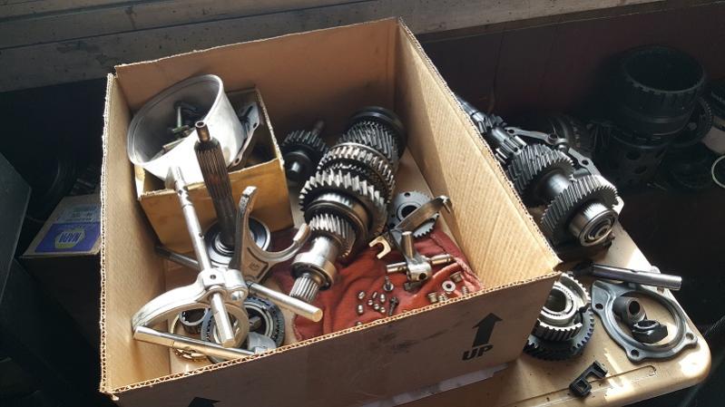

Here's a pic of mine apart, so you get an idea on the gears.
