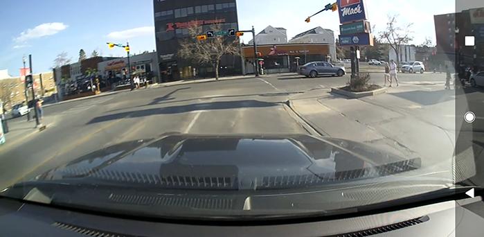

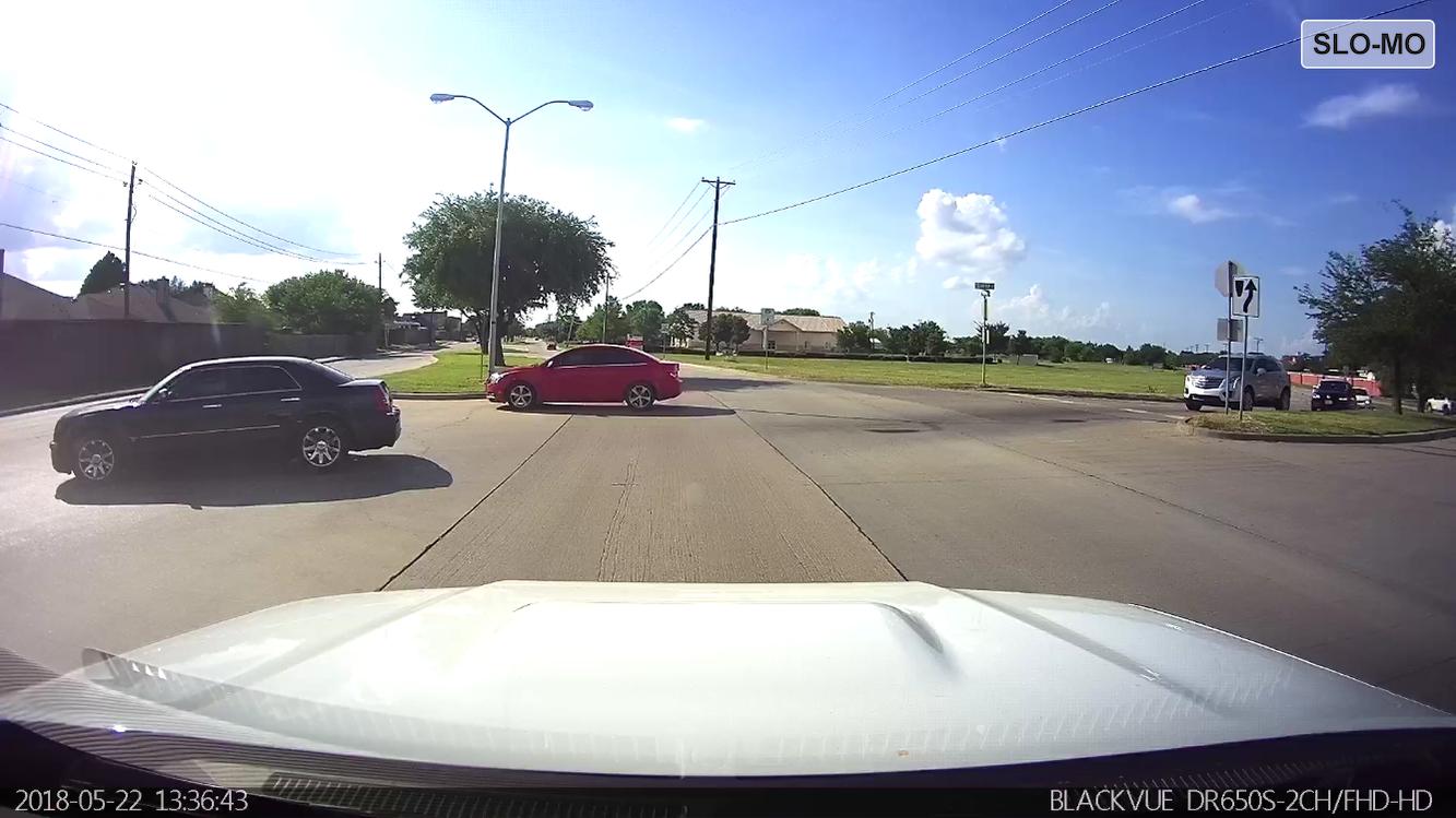

Your camera seems to be pointed up high. Do you find when you are watching play back that your camera often fights brightness?
Here's mine. Some might argue that it seems low but it doesn't often change when driving.
I know what you mean, but I wanted to maximize what I could pick up on screen. Mine was originally pointed like yours, but I realized that 1/3 of the video was of my hood. Not much point in recording that. Now I can see more sky...maybe I will catch a meteor shower! UFO! Wild eagles!

I also have my camera pointed in a more downward viewing position. As much of the hood as possible, still plenty of upward view. If someone were to impact your fender more from the side, the view dedicated to meteors may not be useful. Accidents are rarely directly in front of you. I know from experience and wish I had even more of a wide angle view. I have since then lowered my cameras' view.
I have mine set kind of in the middle.
I would opt for what you guys have too, if not even a little lower, so you can catch more of the periphery, I reckon you could see almost to the pillar. It makes no sense to record so much sky. This is to catch accidents (unless I guess if your looking for planes or meteors dropping out of the sky) I want as much of the truck in view while still showing the extents :)
You may be right. I will experiment a bit and adjust as appropriate...
