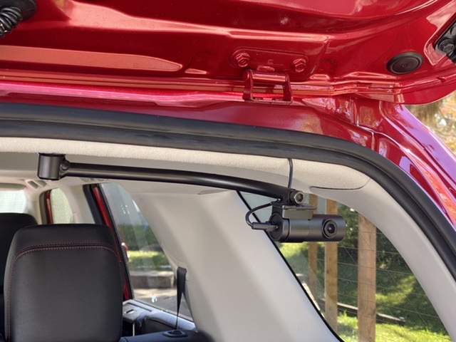

I just used the factory mount and screwed it into the headliner clip. No issues, out of the way, and not obstructed while recording.
I’ll try to get some pics from the rear view mirror view and recording view tomorrow.
I like this clean setup. How stable is the camera? Are you using a special screw to stabilize?
It’s very stable. Just a regular screw I found in the garage. It did take some force to slide the camera back into the mount over the screw, but nothing broke or got scratched.
I drive with the rear window down majority of the time with no worries of it flying into the car behind me. Smooth video on and off road.

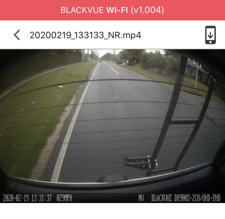

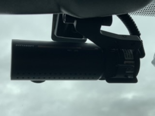

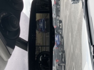

Here is a camera view and some pics of the front camera. The rear camera is not visible in the rear view mirror due to the Rago deck. But prior it did not obstruct my view. I’ve never had issues with it being in the way when loading/unloading junk. I did hit it a few times to test sturdiness, no movement. The camera has a wide angle view, so slight rotations will give you a nice view of the front and rear.

Very nice! I know I have a different camera, but here is what I did for mounting the rear view dashcam. I basically bought a little piece of aluminum from Home Depot (or your other local box store) drilled a hole in it and cut it to length. I bought a screw and washer to fit into the headliner attachment point. I don’t see it at all when I’m back there.
It actually sticks out past the weather sealing to get the camera as close to the rear window without touching.
I just recently moved it off the center headliner attachment point and put it on the one closer to the passenger side so that it would be in the wiper path.
