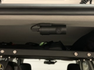

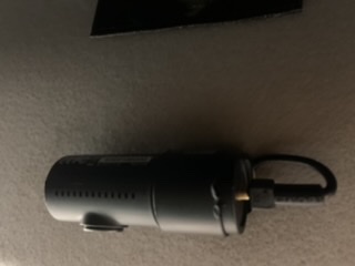

I just used the factory mount and screwed it into the headliner clip. No issues, out of the way, and not obstructed while recording.
I’ll try to get some pics from the rear view mirror view and recording view tomorrow.
