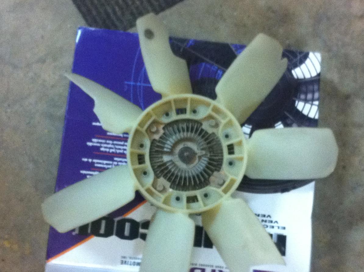

my cooling fan on my 03 V8 4runner exploded yesterday after a badly placed
radiator hose clamp on the lower hose. thinking of converting over to an electric fan set up looking for everyone's input what's better what's gonna last longer who's done this?? looking forward to y'alls responses thanks y'all!!

so the plastic fan blade is a dealer item only priced at 126.00
clutch is like 60 at parts store
Efan at 1400cfm costs 73.00 controller 20 bucks so I'm trying out the
Efan its 16" in diameter made by Hayden from orielys I'll post up
how it works out just couldnt break down an pay 126 for a piece of plastic

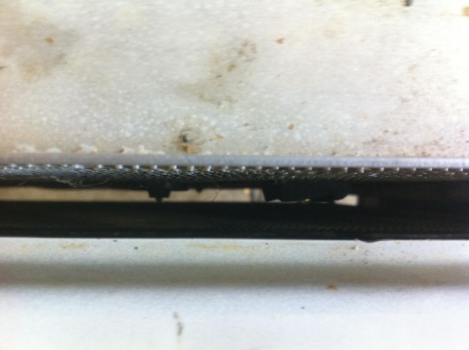

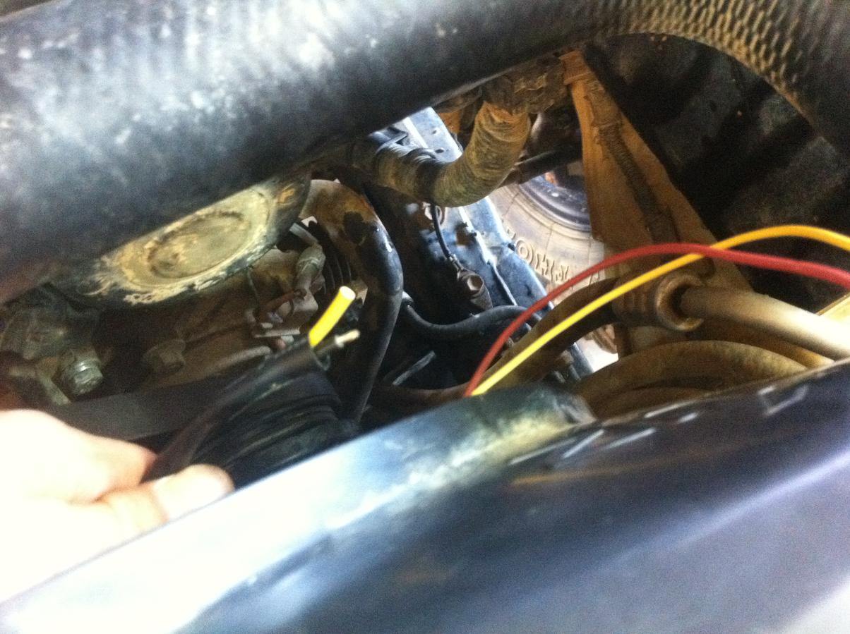

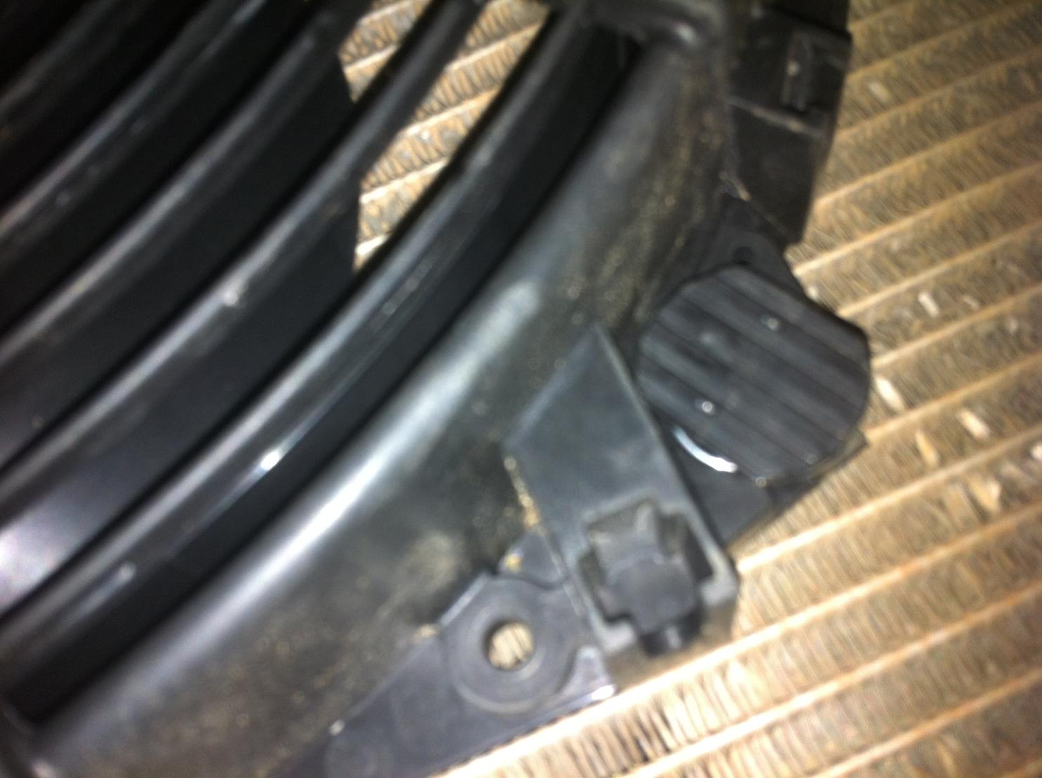

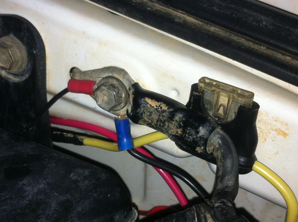

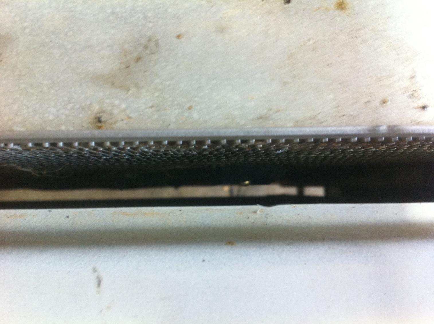

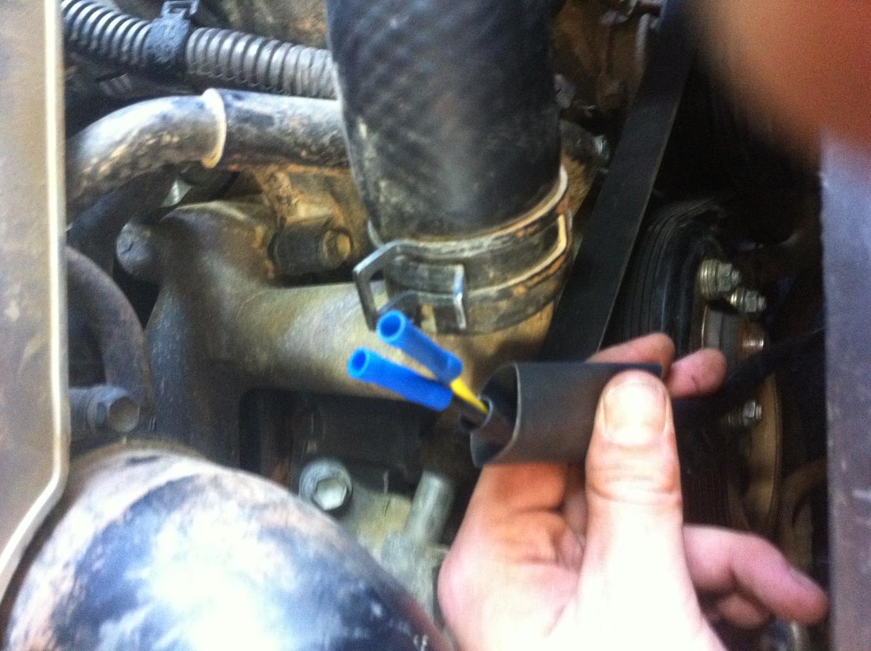

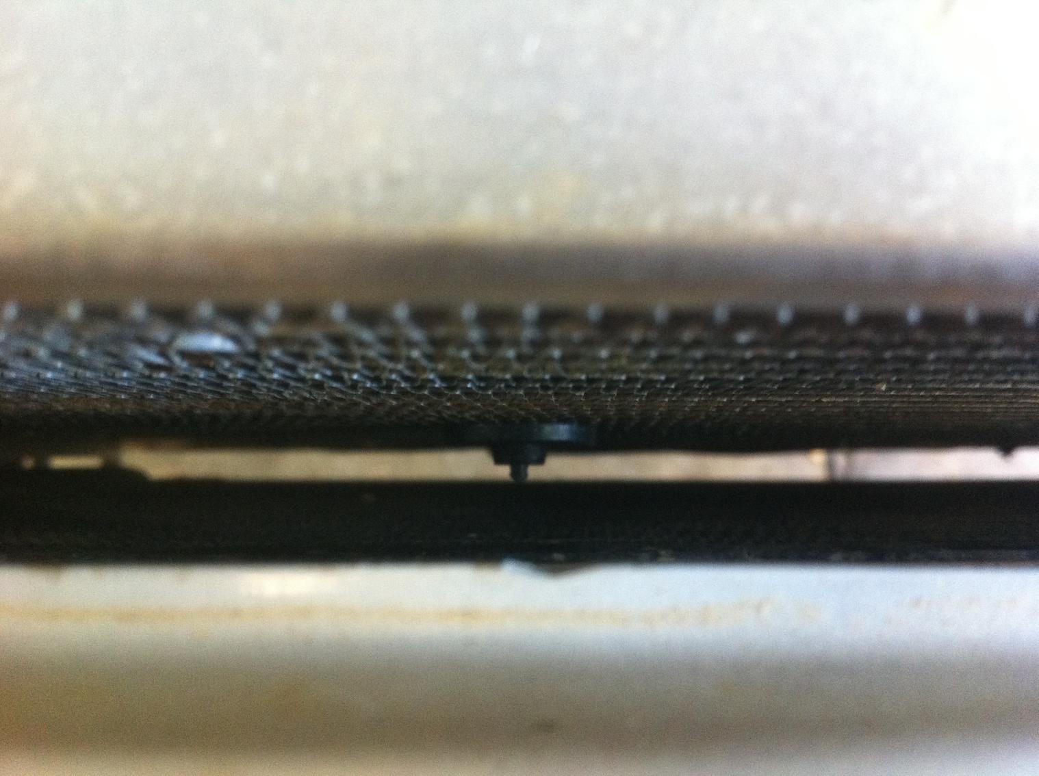

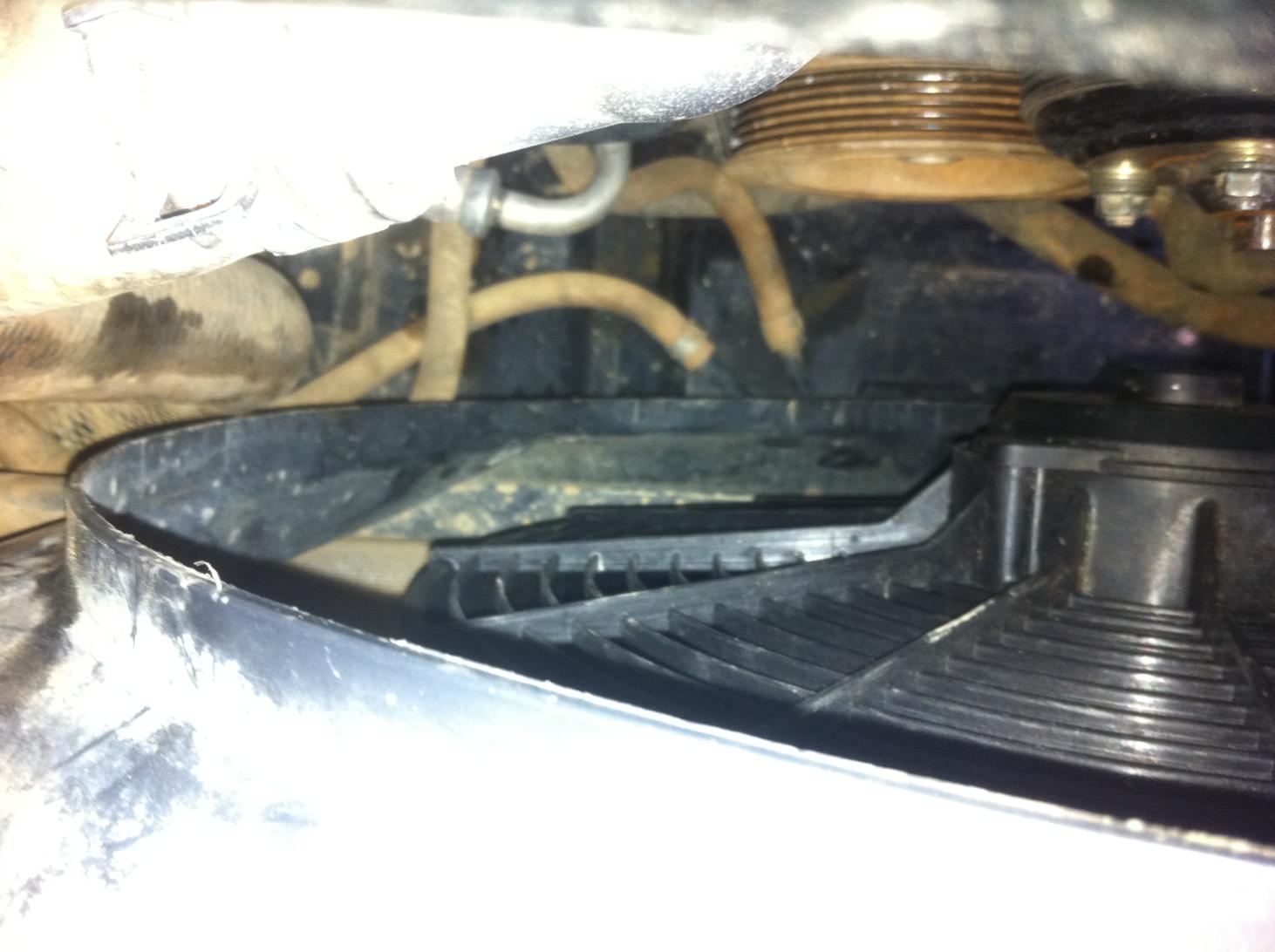

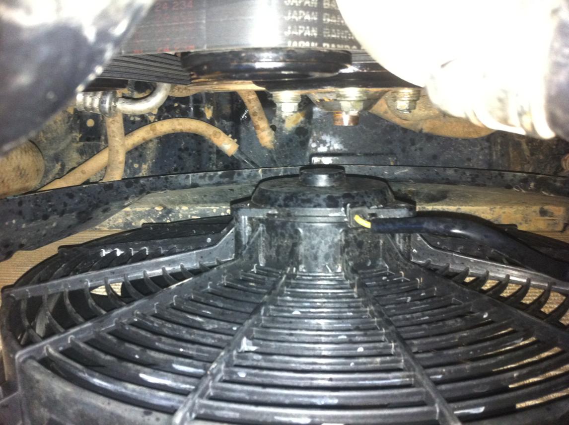

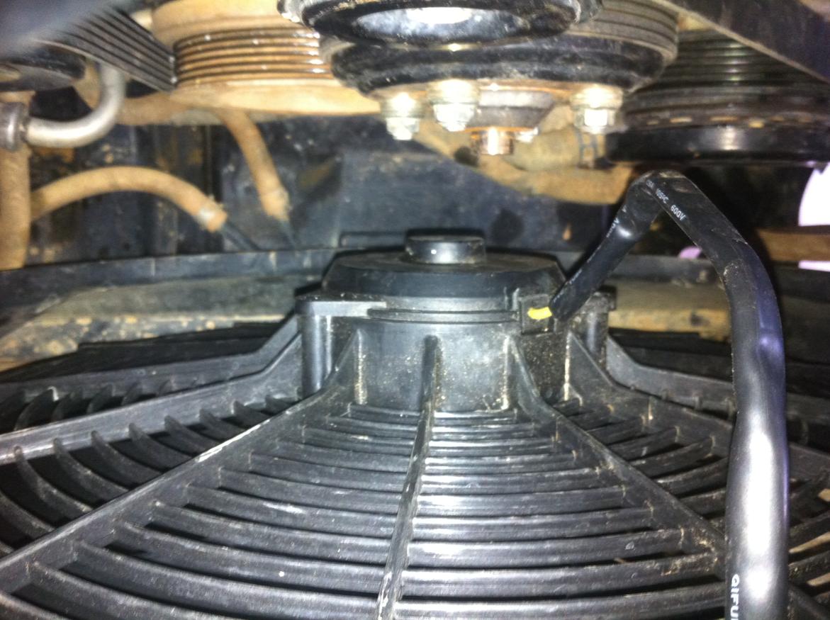

So I picked up the 1400 cfm hayden electric fan with relay controller. payed 107.39 for the combo (saved $100.00 from replacing stock fan) intsall was fairly simple; however, wiring everything just took time. I spent about 5 hours on the hole job but that includes looking for electrical connectors and what not diggin around the shop for random supplies so heres what it all boiled down to...
supplies:
10mm socket wrench
12mm wrench
14mm wrench
12mm socket w/ 3" extenion (recomend 1/4" drive & 3/8" drive)
Electric fan your prefrence (needs to fit between orginal clutch fan pully & radiator and not cause removal of original fan shroud)
fan controller with thermostate switch
12- 8mm bolt washers (three stacked together should be close to 1/4" thk)
25ft 14 gauge wire (12' red 12' black)
6ft 16 or 18 gauge wire (single colors fine)
14-16 gauge wire connectors (see pics)
16-18 gauge wire connectors (see pics)
3 - terminal post wire connectors (see pics)
Wire crimper
wire striper
wire cutter
electrical tape
(wire connectors for piggy backing into fuse blocks)see pics
1.) remove 4 12mm nuts that hold original fan clutch (try not to damage stud threads)
2.) unbolt the three 10mm bolts that hold the overflow reservoir from the fan shroud remove over flow hose and cap set aside you dont have to dump out the radiator fluid from the reservoir unless you feel like it. I just stood mine up next to the workbench.
3.) unbolt radiator fan shroud as well unclip radiator hoses from the bottom of the shroud passenger side of vehicle
4.) pull and prod at the clutch fan (dont damage threads) until it pulls free from the pully remove the fan shroud and the clutch fan assembly at the same time (works best that way)
5.) At this point youll see the nuts that hold the clutch fan on also hold the drive pully to the water pump drive. Using a 14mm wrench turn the head of the bolt on the tensioner pully to the left loosing the drive belt and remove the drive belt
6.) place three 8mm washers on each stud between the old clutch fan pully and the old clutch fan 12mm (hex head) nuts (see pics) when tightening the nuts back in place turn the first stud to the top position alow washers to hang towars middle of pully evenly and tighten, follow the first stud by tightening the stud on the opposite side of the pully; however turn the pully so that the washers hand down toward the center of the pully (this places all the washers the same distance from the center of the pully in attempts to balance the pully while the engine is running.)
7.) replace drive belt

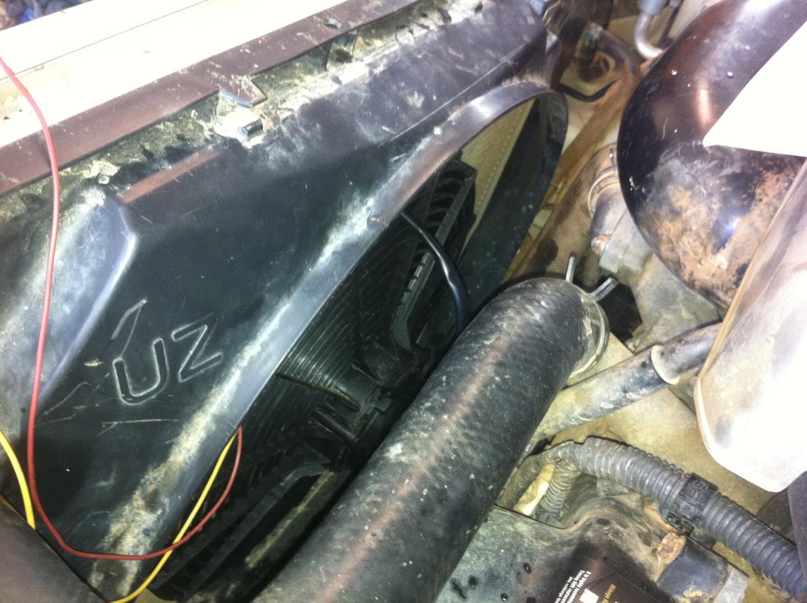

8.) unbolt the radiator (dont drain just allow it to slide forward towards the engine for ease of fan install)

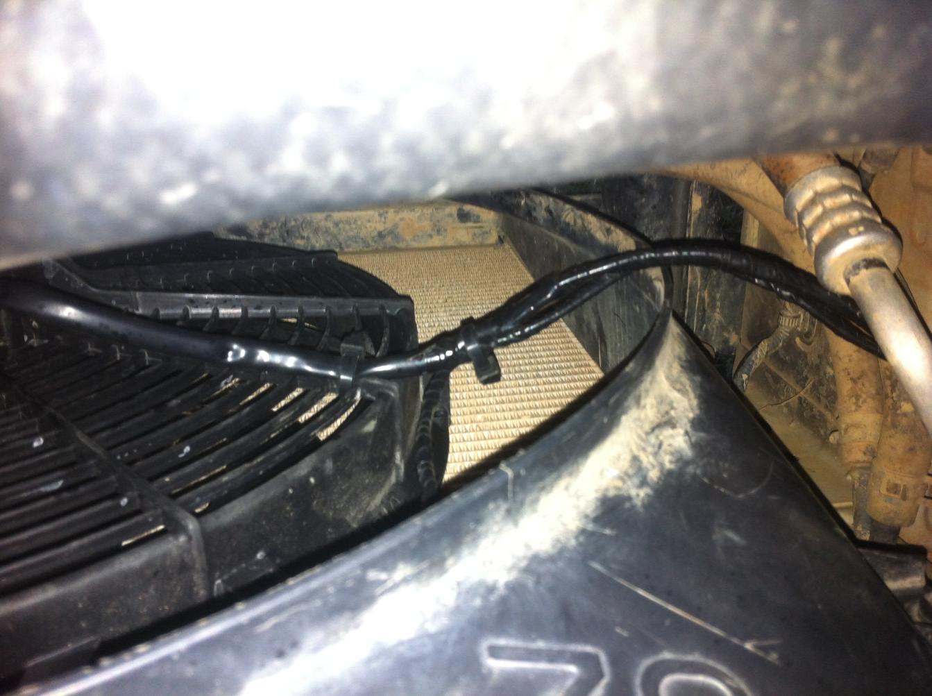

9.) depending on what type of fan you purchase or yank out of another vehicle will determine how it mounts and what controller is needed the fan i purchased used tie downs similar to zip ties. In four corners of the fan a plastic rod is slid through passing through the radiator securing to a plastic clamp (thingy) I just placed the fan as closed to center of the pully as the old fan and tied it up. you'll need access to both sides of the radiator to secure the ties.

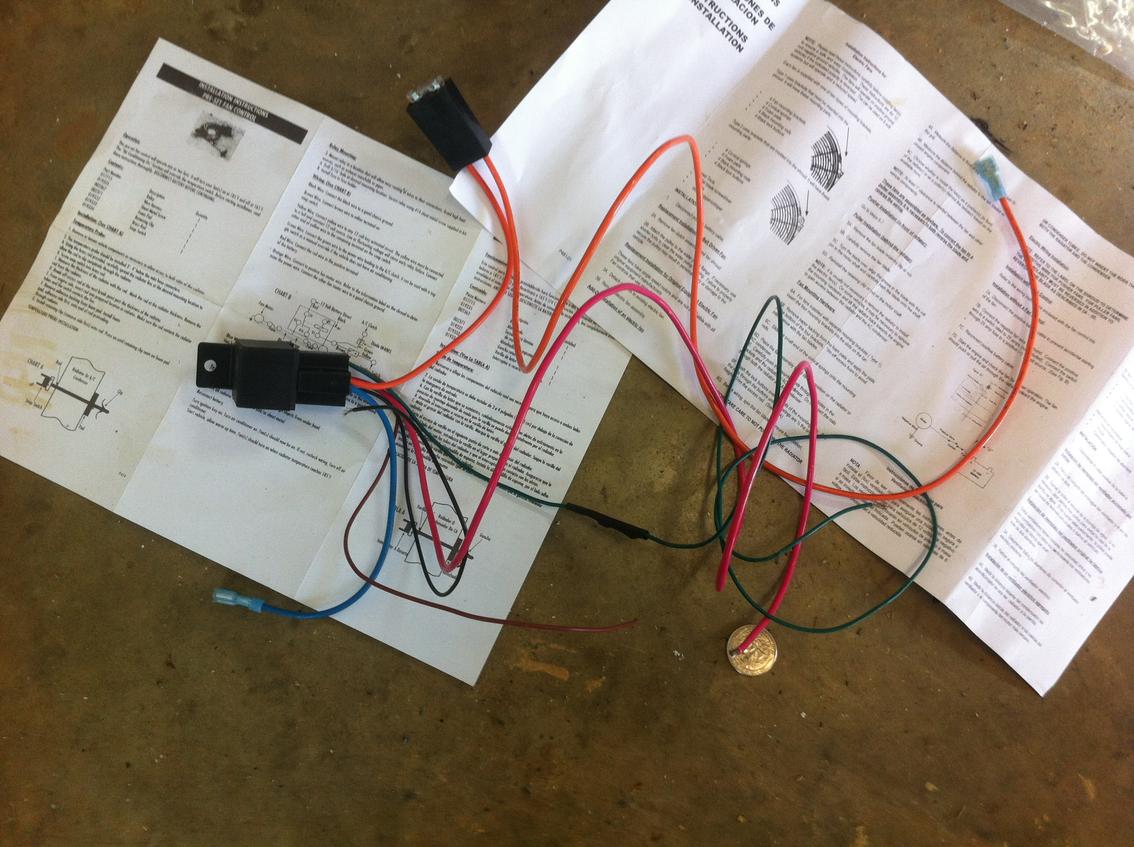

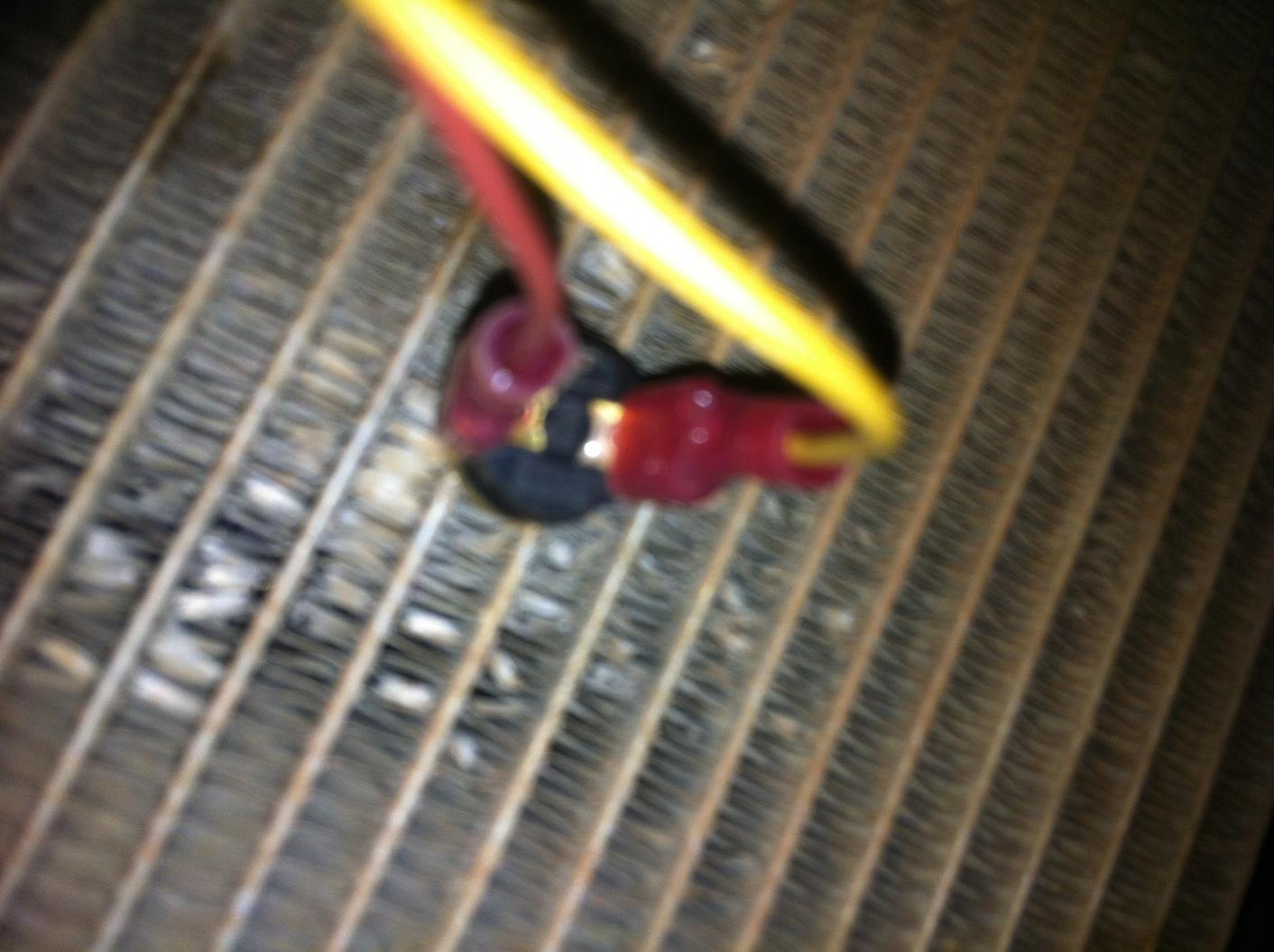

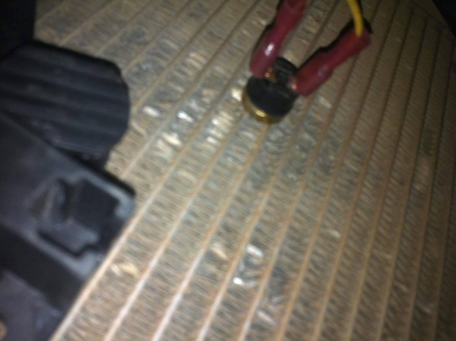

10.) The controller i purchased runs off a thermostate as well as the A/C compressor clutch power wire. When the thermostate reaches 185degrees the fan cuts on and or when its hot enough for me to run the air condition as long as the A/C runs the fan runs. The thermostate for my controller mounted similar to the fan the thermostate protrudes through the radiator fins and has a clamp on the other side. I intsalled this at the top right side of the radiator closes to the inlet hose of the radiator (the part of the radiator that heats up first.)
11.) bolt the radiator back on. This was one of the pain in the ass parts A.) the lower bolts of the radiator are somewhat barried you'll need a 12mm socket wrench and a 12mm wrench as well as a 3 to 6 inch socket wrench extension. B.) this is when the fan shroud goes back on. as you remember the fan shroud came out with the old fan and now the new fan is already installed in your way youll have to slightly bend and manipulate the shroud to get it back in place i was able to do this with my fans dimensions i would keep this in mind when looking at dimensions of other fans and modify the shroud and mount the fan to the fan shroud. this would be owner preference.

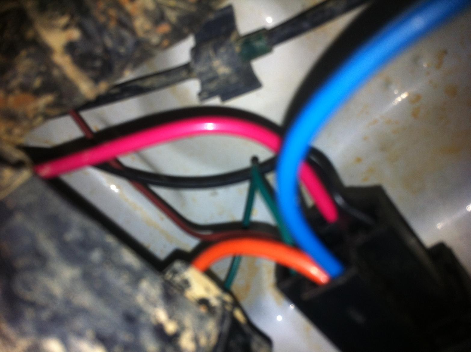

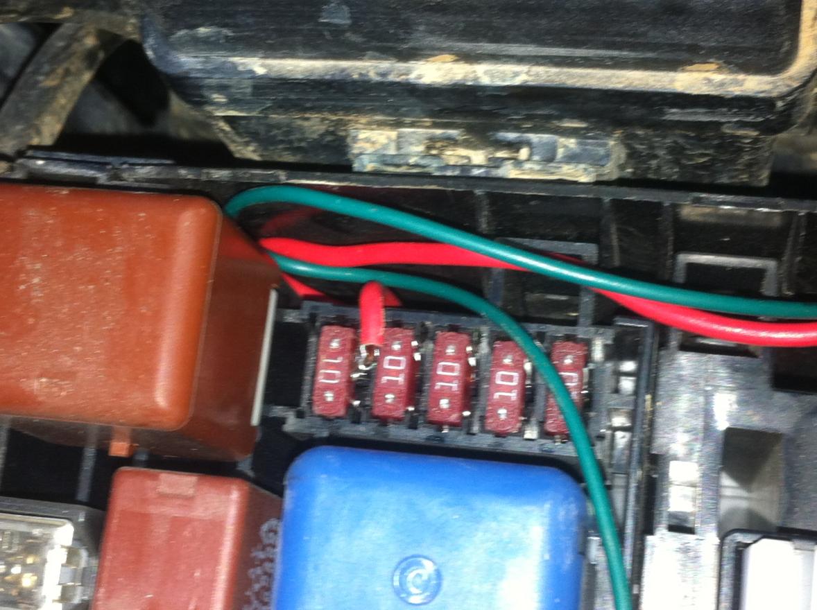

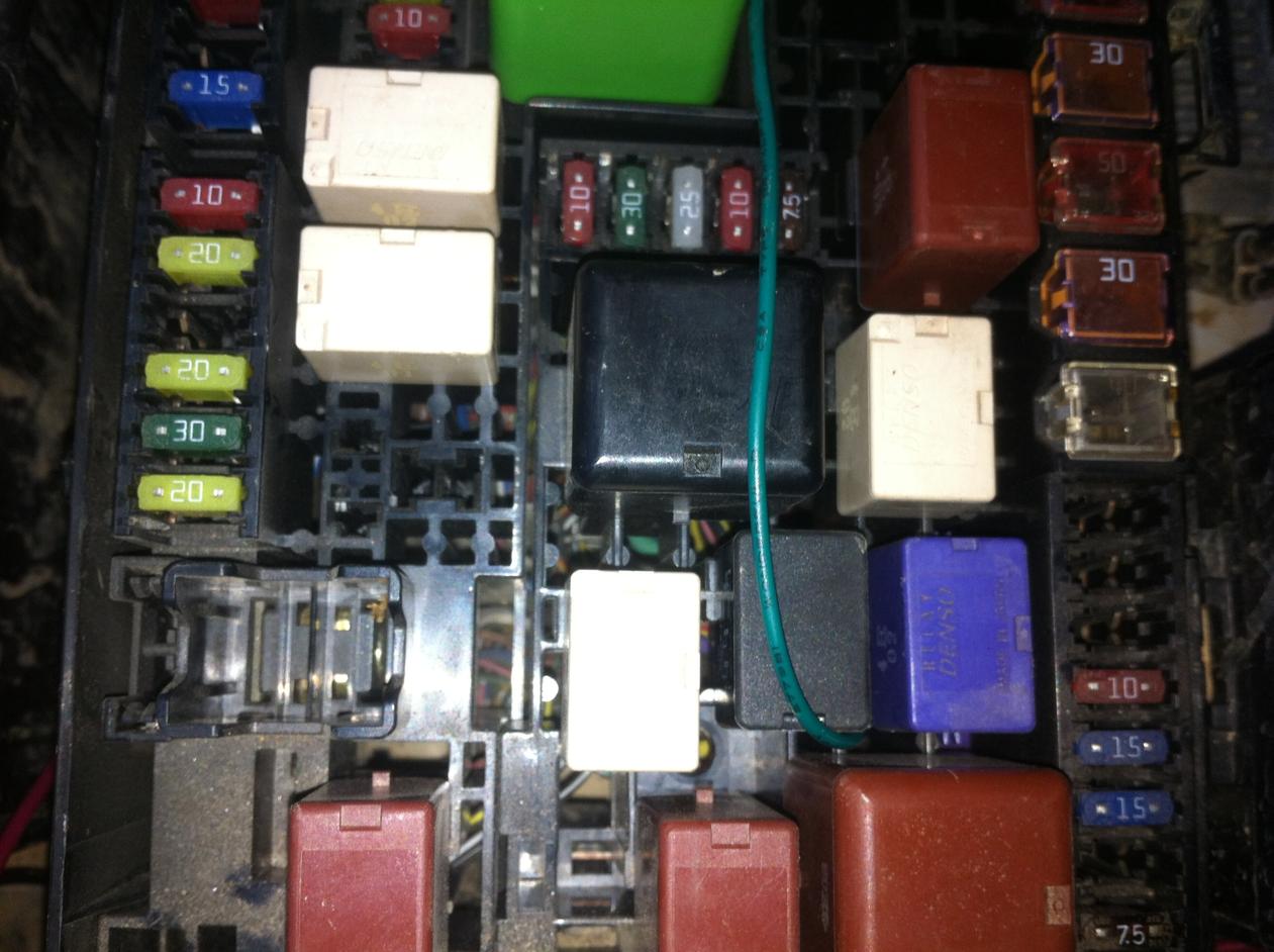

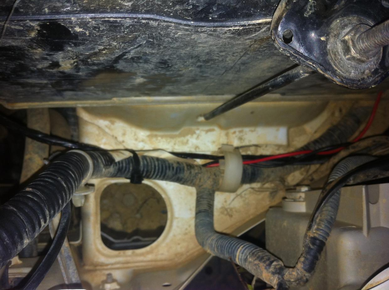

12.) follow the wiring instructions givin by the fan an fan controller. The instructions will explain where you can even wire in a toggle switch for a manual override if desired i didnt do this today but i plan to befor getting in water or mud again. just couldnt find a switch

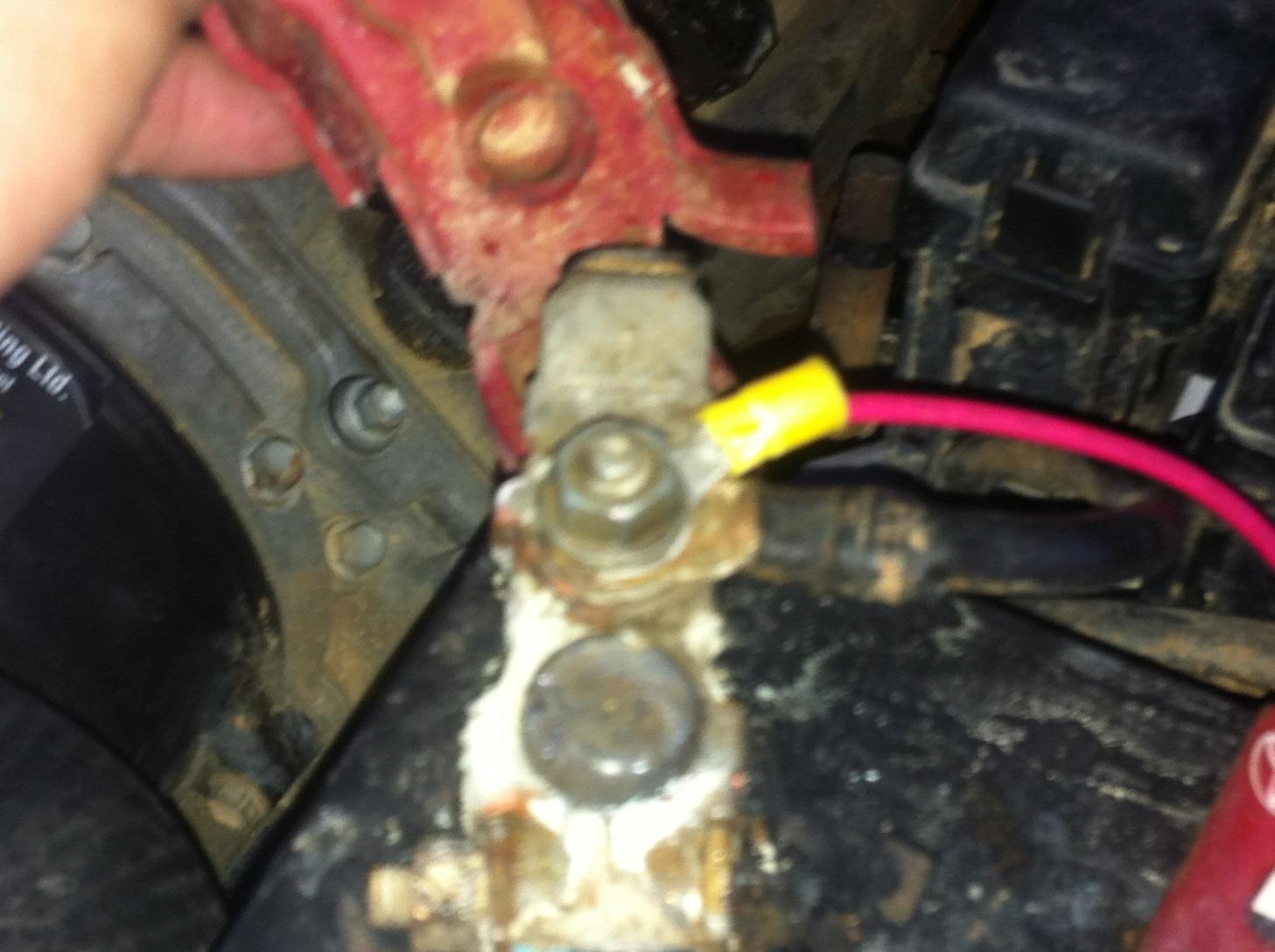

13.) run the wires coming from the fan and the thermostate to the driver side of the truck (see pics) i ran my wires under the battery over towards the fuse box for simplicity of grabing power here an there.
14.) to pull off the power wire of the A/C clutch but the MG / CLT relay and tie the conrisponding wire of the controller to the leg closest to the outside drivers side of the truck. The constant ACC switched power i grabed was the First 10amp fuse on the other side of the box from the relay i used (see pics)
15.) Try to keep your wiring need and if you plan on extreme conditions with your truck i would seal up wire connections as best as posible i wouldve used heat shrink wraps on every connection but i didnt have any lol i just settled for electrical tape
16.) once everything is installed start the truck turn the A/C off make sure your old fan clutch drive pully isnt dancing or showing signs of play turn A/C on and insure the fan comes on.
17.) allow the truck to sit an idle preferably in the sun heat try to get it as close to worst conditions as you can for a true test. mainly get the truck as warm as you can with the aircondition off and ensure the thermostate switch kicks on the fan when prompted. a meat thermometer in the front of the radiator can give you a good idea plus its a good time to see what your thermostate in your dash compares to actual tempeture of the radiator.
18.) Enjoy your better gas mileage getting, smoother idling, cooler running 4runner
