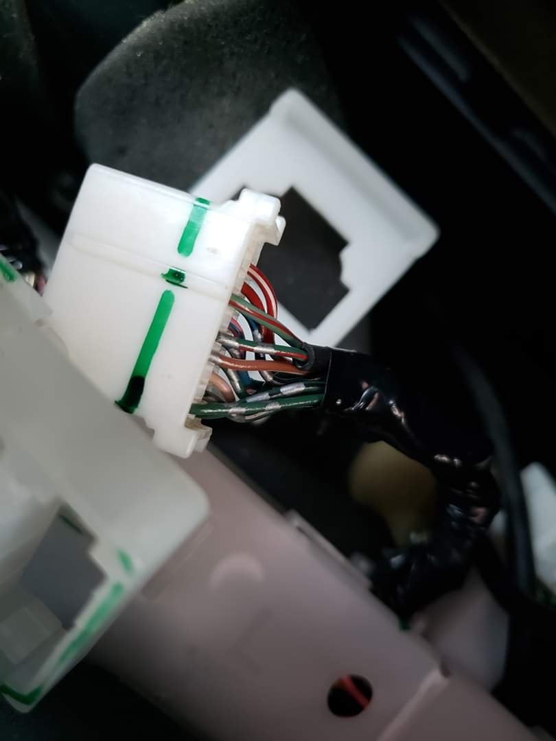

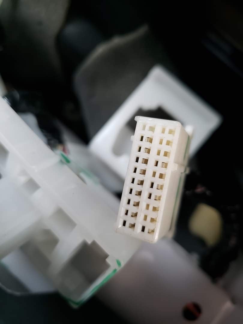

Here's the pics he sent and message after he opened it up again for me. "So it's spliced into #6, green with red. There aren't any other orientations that wind up with pin 6 and a green wire..."
Does this orientation look correct?
Sent from my Pixel 3 using Tapatalk
Yes, the second wire from the top is the one. Just to confirm. He cut it, connected one piece to the orange, another one to the yellow - right?
If so, please disconnect the mod from its harness and try to lock center diff. It should not light the led when the diff is locked.
If so, please change orange and yellow wires orientation, connect harness and check the mod once again.
