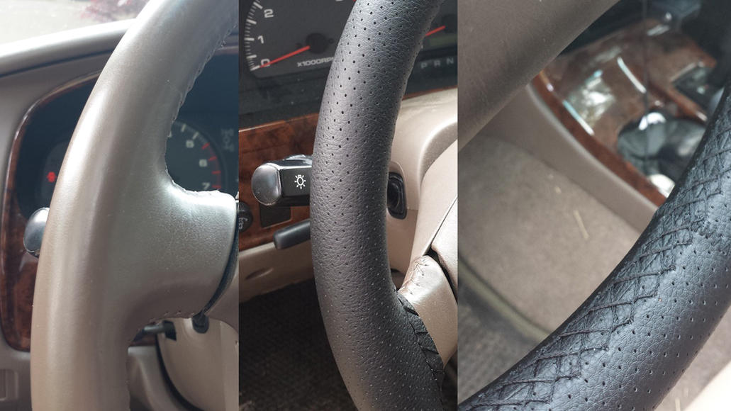

Looks good! I tend to drive with just my index fingers too ha, didn't know that was a "3rd gen thing". As far as covers go, I recently put on a stitch-on leather cover that was like 8 bucks with free shipping from Amzn, was skeptical at first but it doesn't look cheap at all and feels great. Did it to preempt my oem wheel from tearing up like the one you replaced. Brand is Lemonbest if interested.

Thanks guys, I appreciate it!
Seabun: those covers look good, however, My Home Ec teacher always told me I was the worst sewer she'd ever seen. Lol. I'll look into those though.
