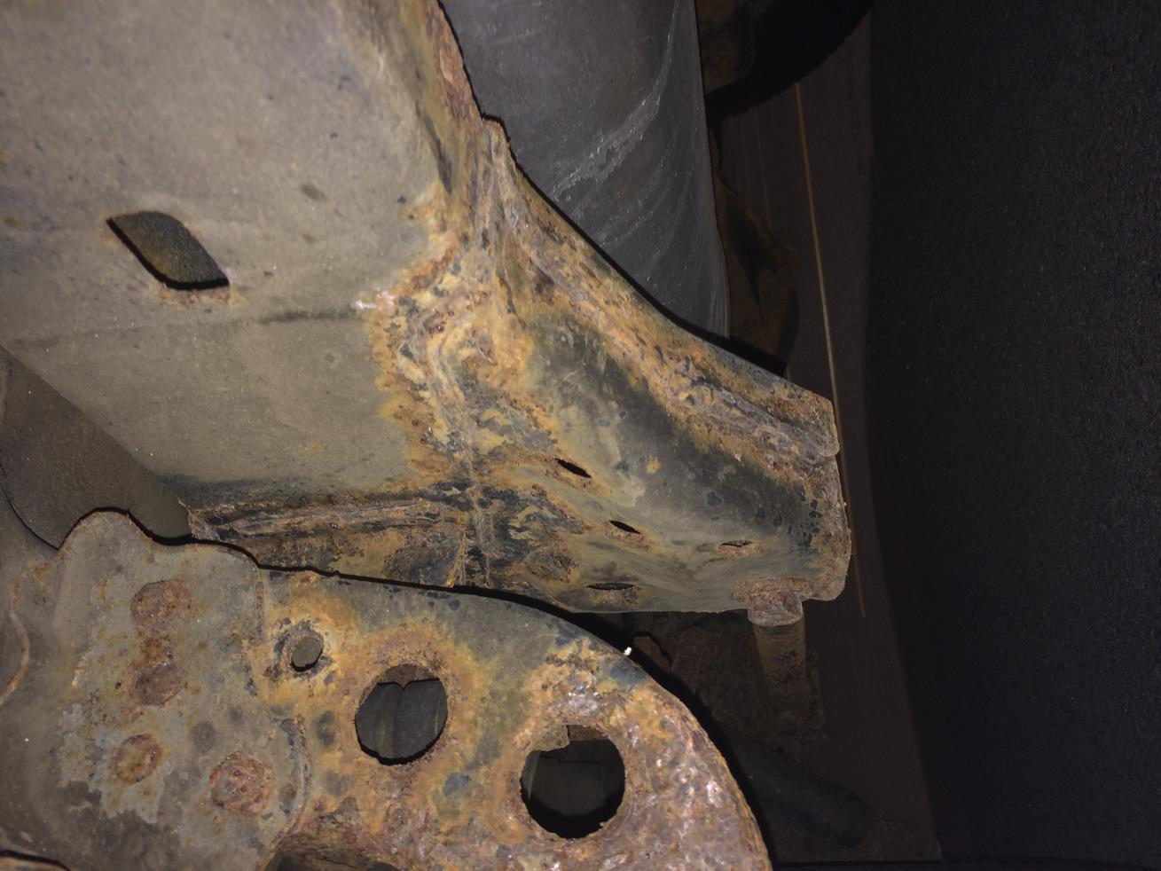

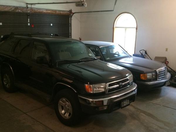

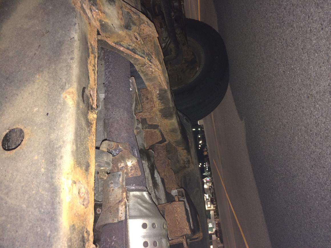

So I have recently acquired a 2000 4WD sr5 4runner. Story is grandparents bought it brand new in 1999, drove it daily until 2005, then they just stopped driving, parked it, and that was it minus some rare exceptions when they took it out. In the past 3 years, it has only had 100 miles put on it (just to drive it to get inspected then back home). Last month after not being started all year, i charged the battery that night, and in the morning started right up and drove it for a week and everything was great. The car now has 45k miles on it, and I was wondering what i should do to get it ready to start driving it as a winter car as I'm trying to save my GS300 from the elements here in western NY. The power steering, coolant, oil, brake, and transmission fluid were all been changed when i got it inspected. I cleaned the throttle body and MAF sensor, replaced the air filter, got new tires, a new muffler, new rear brakes, and will be getting new front calipers, pads and rotors this weekend (they are really rusted). Will also be getting it "rustopped" this weekend, sort of like krown rustproofing (i guess its a canadian thing?) Some issues are the antenna still goes up and down, but doesn't retract all the way into the fender (i probably wont fix this), the a/c doesnt work (needs to be charged?) the starter takes a while, sounds like normal, just takes a little longer. Could this be because of to small a battery? The one in the car is bout 3 years old, and looks like its a smaller size or something. Also, there is some rust, not structural, but to much for 45k miles i feel like. Also, the bulb? for the diagram showing a transfer from 2wd to 4wd is burned out and nothing shows on the dash. Is this easily changed? Before i got it, all that was really done was oil changes. Is there anything else i need to get done before i start driving it again? I'm not trying to modify it at all as I just need it for driving to school, work, and the occasional ski trip. As stated before, last month when i was driving it, it drove and rode great. I just need a reliable car for winter, I don't mind putting money into it, but I don't want to go replacing everything just because either, if that makes sense. For those interested, here is a picture (the 560sel next to it only has 10k miles). I will say this, i didn't expect to like this thing as much as I do. Its just so different from my GS300 and just has this indestructible feel about it that reminds me of the LX470 we used to have, that being said any input would be great. I've read the threads, and looked for the common problems, but I am not nearly as familiar with this thing as most of you guys are. Sorry for rambling.

OP: Congrats on your truck and I'm incredibly jealous of that mileage. Hopefully the rust isn't too serious. Honestly, I wouldn't do much else with it other than what you've already done and plan to do. I would only add a radiator replacement. I'd pull old one out and put a factory one right back in its place. I wouldn't bother with the external cooler or anything like that. It's a pretty cheap part considering the preventive benefit and potential costs of failure, and it'll last another decade. Otherwise, I'd just leave the rest as is and fix anything that breaks if anything happens to do so. As for the long start, it could be the result of some issue, but these trucks very commonly turn over several times before they start. I wouldn't spend any money or time chasing a problem that may not even exist. Just look into it if it becomes an obvious problem like no-start.
