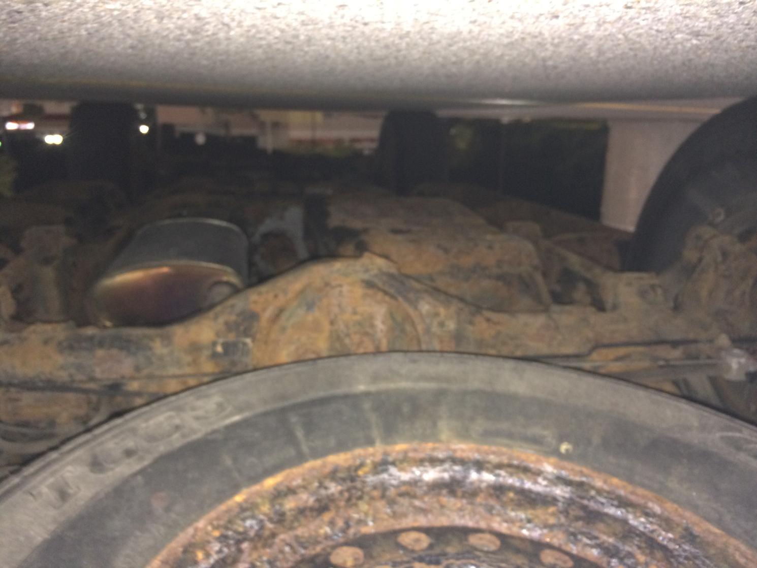

I live in the rust belt, and I've seen worse rust.... That said that's significant for a truck with 45k. If you're serious about keeping it for a long time... Replace that maf, and before you "treat" the rust, paint it with por 15. It works. Clean off the grease, get rid of the loose stuff, the. Just paint on the por 15... Costs a bunch, and it's a royal pain in the ass, but it works! I spray fluid film on mine every fall, and my truck looks so much better than anyone else's up here(rust wise).
I missed that. Damn! Did it spend that 45k driving on a beach? Start sanding off that rust and painting. Then, spray over the frame with Fluidfilm and inject the inside of the frame rails with it.
45k miles in buffalo and not really ever being washed.
No big deal... Just some time, money and elbow grease ;) VT uses some brine formula that I swear adheres to the underside of vehicles! Some preventative care and you will be able to pass it off to your grand kids!
