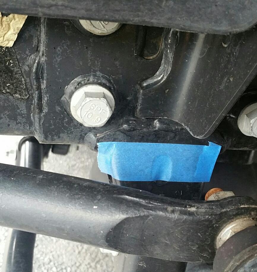

I took a quick look at my neighbors 2018 truck and this is what I saw...
I looked at a 2015 and didn't even see that it was welded, on this side.
Wow no wonder the welds are seperating. its just tack welded on the side in the picture.

About time. Heard about it from other forums, posted pics months ago myself. Every JL I've seen has crazy weld porosity on the frame mounts. I'm not an engineer but I do know a thing or two about welding over the years and I won't step foot in a JL until after checking out the welds. So far haven't test driven one. Not trying to spread a wildfire here, but from my experience it's a widespread issue. Sucks for such an iconic brand.

that's just one of the problems, the terribly ugly porous welds are another. those will definitely need another recall, especially when they all come apart from the smallest amount of rust.
it's also hilarious that one of the photos that had the weld nowhere near where it was supposed to be had a paint pen QC mark on it, so a human looked at the weld and didn't notice how wrong it was. leave it to the italians i guess to find a way to make jeep quality even worse

After looking into this a bit more...I'm thinking the rest of the welds should be suspect.
In my line of work, this would be a hard stop, with every single weld, every single 0.001" , X-ray'd for defects.

Those welds look great compared to some of the welds I've seen online, lots of porosity. That could've been easily corrected after the first few instead of 1,000's later. This isn't a new thing though. When the JK was first launched one of my customers purchased one of the first ones in the state. With less than 50 miles on it, the front track bar bracket broke loose from the frame and sent him into the ditch. He was barely able to keep control of it but managed to just go off into the ditch without much more damage or injuries. Several other welds were absolutely terrible on that Jeep. He was shaken up and immediately complained to Jeep who immediately gave him another Jeep and took that one for inspection but the whole deal was basically swept under the rug. I had seen a few other JK's since then that have terrible welds but nobody seems to be bothered by it (including the owners).
