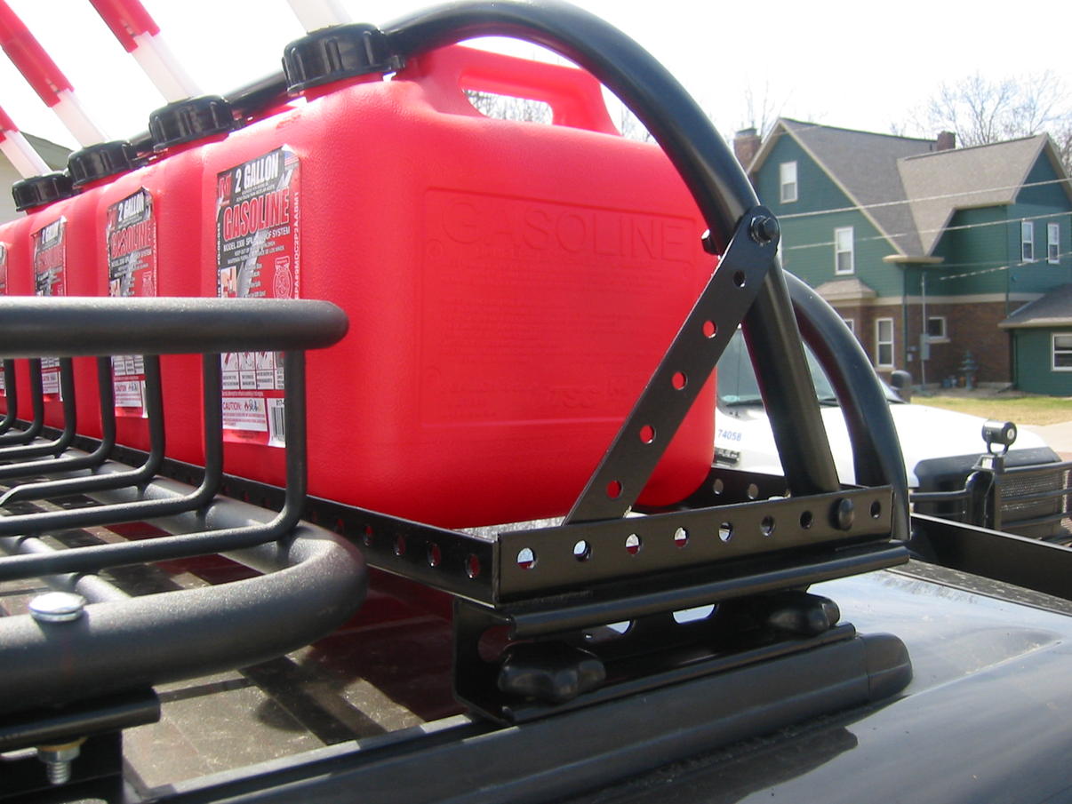

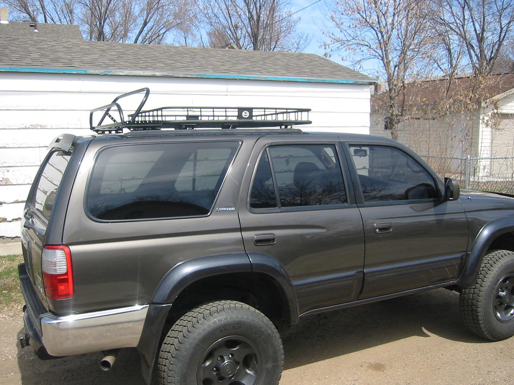

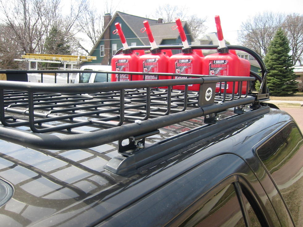

Well it has been a work in progress and I finally got it completed this morning. Turned out pretty good I think.
I made the gas can holder out of scrap emt conduit and angle from an old shelving unit from work. It holds 4 two gallon gas cans. I went with four because two 5 gallon cans would be heavy to get off the roof and they stick up way to high. The cans are really only for when I have my trusty ole 2-stroke dirt bike along on the trip. The cans be padlocked in and you dont have to worry about bungee cords either. Gas cans were on sale $22 for the four so thats all the money I have invested in that part.
The rack I thought was a square rola rack but when i pulled the cheesy sticker it had a bauer vehicle logo. No biggie to me. It measures 39 w by 45 long. With the gas can rack and basket it comes out right behind the sunroof. Couldn't planned it any better. I got the rack for 90 shipped and will work great for what I need.
Just thought I'd share some pics.

Thanks guys! The no bungee cord to hold the gas cans down is what I like. I've seen many red gas cans in the ditch. Plus you can lock them down. Nobodys stealing my pre-mix. haha
