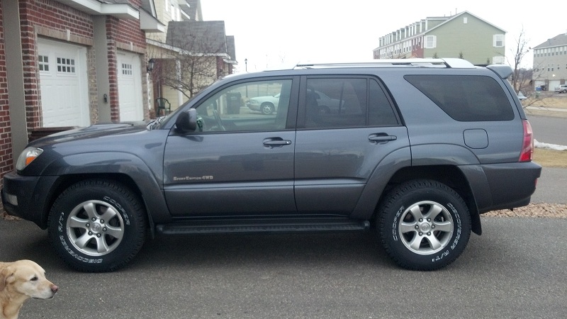

Just got some new Cooper AT3's put on today. LT265/70/17, load range "C". Also got a bunch of 100K maint. stuff done, except for the front diff. as the plug was rusted in, so....a trip to the dealer to get a front diff drain plug is in order for me, and it's likely the plug will have to be chiseled out. :redbrick:
Okay, so here are my initial impressions:
-Ride is not noticeably harsher than the tires I had on before which were yoko geolandar HT/S 265/65/17 P-metric. If anything, even though I'm still breaking in the coopers, the ride seems more stable than with the yoko's.
-I had a fairly significant pull to the left with the yoko's, even in the right lane, and especially in left lanes. The pull appears to be gone, which is awesome!
-so far, these tires don't seem to want to track road deviations (read: the typical ruts in the road caused by semi's) They track nice and straight.
-the noise is minimal even in comparison to the yoko's even given that these are an all-terrain. You do hear a slight howl at lower speeds, but it's not overly annoying and it's a little more pronounced when taking corners, but I'm not concerned about it.
-Unfortunately, there is no snow in MN this year, so I don't have any feedback on snow performance yet, but I'm sure we're due for "snowmaggedon" in the near future. However, I anticipate that these will be better than the yoko's in any snow. Those things were like driving on hockey pucks with even a dusting of snow, I had zero confidence in the yoko's.
-I'm going to have to find an area where I can take these bad boys to try 'em out in some slop yet too, I'll post up my experiences when I do.
-Haven't put on enough miles to see how it affects mpg, but acceleration seems to be the same. And although this statement is purely subjective, I expected some kind of change in feedback upon acceleration with the heavier tire. There doesn't seem to be any I guess.

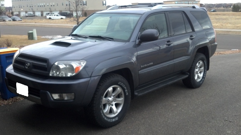

I went with the LT265/70/17's "C"s since I wanted a little more sidewall strength, a bit more ground clearance, and plus there's a little more tread depth. I checked to see if they rub at full lock, but have only checked while sitting still at this point.
edit: I do have very *slight* rubbing only on the driver's side when at right and left full lock, both forward and reverse, it does not appear to be happening on the passenger side at all. I guess that just means I need to put in that spacer lift sooner! :) Not sure if it rubbing on the upper control arm, or on the fender liner & mud flap. Can anyone chime in on this?
However, there's barely any clearance at the fender liners & mud flaps, so next up.....at minimum, a lift for the front is in order I think. At least to ensure that I don't have any rubbing if there is significant articulation of the suspension, since I'm thinking I might get some at stock.
Let me know if I missed any important feedback I should have included, and I'll do my best to answer.

nice tires! I just bought mine and had to do the spacer lift cause of the rubbing (was pissing me off) lol nice runner by the way
Deed, do you have your front end lifted at all? If not, do you also experience the same symptoms I have at full steering lock?
It's good to hear that your tires are holding out well. I can't imagine you've had much time with them in the snow, living in GA, but otherwise, have they lived up to your expectations?
Yeah, i do get rubbing at full lock. I dont have any lift as well. It is nothing major so i am not too concerned. I plan on lifting when i get the funds so i will not have to worry about this someday! And yes they have been exactly what i wanted/needed. A GREAT road tire with a nice aggressive A/T tread. Great on the highway. I have not been through mud but off road on rock, dirt, grass, and hills they have performed great.
