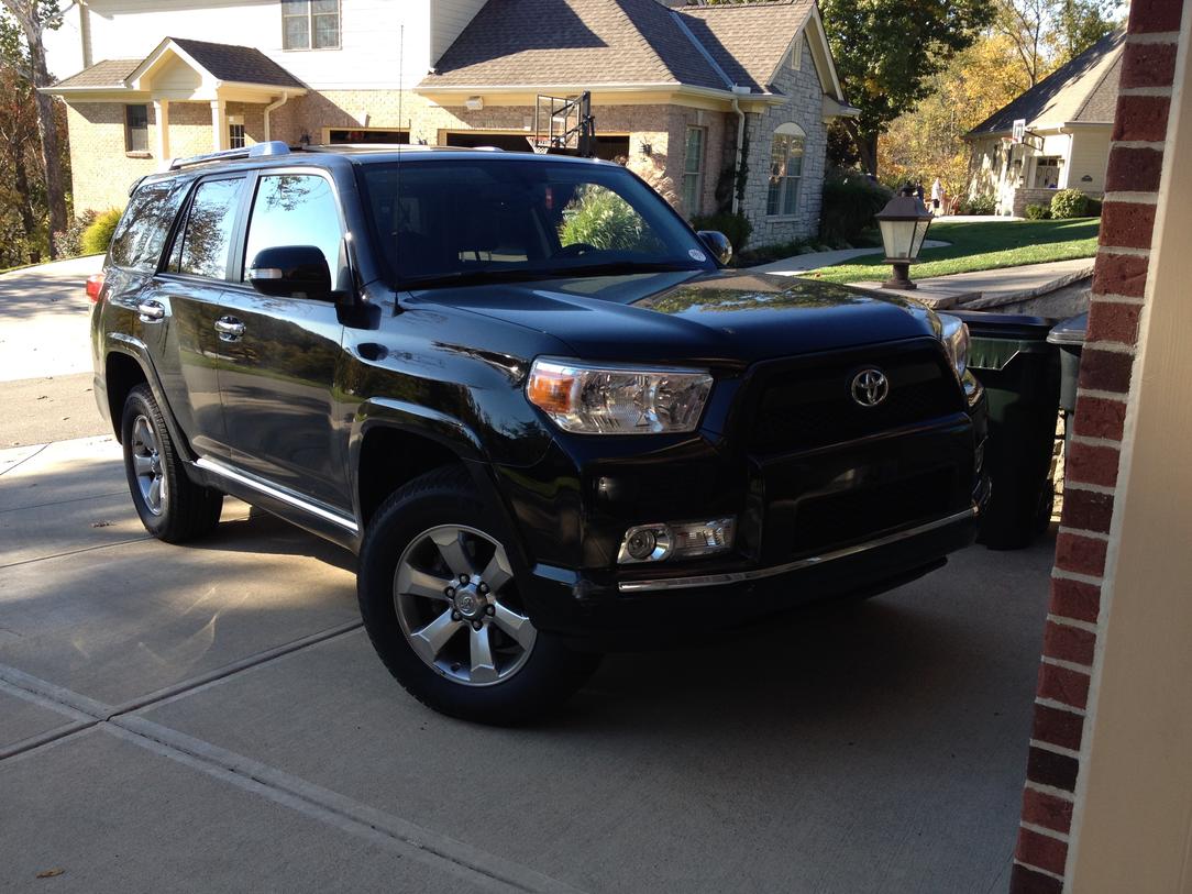

Here's a crappy pic of my new wheels, tires and plasti-dipped chrome wings on my LE. These are my first mods on any car I've owned. Special thanks to Jeff M and MarkWalker for answering my questions about the 4th gen wheels within minutes of my asking them.

Looking good! I need to get mine clean and post some pics of the wheels as well. I'm very happy with them.
Thanks. Very happy with how the larger sidewall and wider tires fill out the wheel wells.
They do look good!
Do you know what the backspace is on those 4th Gen LE wheels? I had a set of 4th Gen Sport wheels and the BS was 5.25" which located the wheel .75"s inward compared to the spec 5th Gen wheels of 4.5" BS.They made the inside of the front wheel/tire sit precariously close(less then 1/16")to the UCA when the front suspension was flexed downward and got some rubbing on the sway bar when the steering was cut the whole way. Those Sports were 17" diameter wheels though so might have a little more room with 18's that I believe 4th Gen LE wheels are.

I found this on a Taco forum. Hopefully it is correct (not a guru on this stuff):
18 x 7.5"
6 x 5.5 PCD
+25mm offset
5" backspacing
I have no rubbing issues but have not "flexed" them so I can't give you specific information there.
