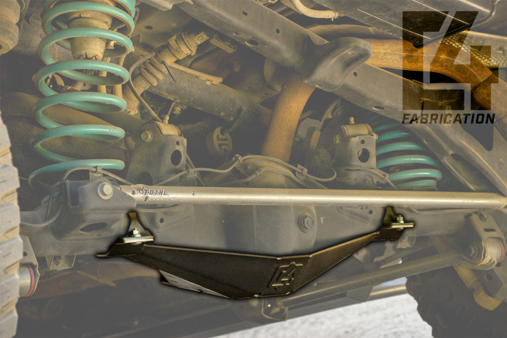

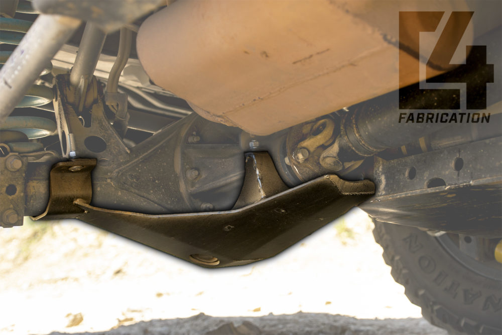

Too close for diff armor.
Bummer, so you don't think it'd work with C4's new skid (KDSS compatible)? What do you feel the issue would be?
That specific one looks like it would be fine. Worst case scenario you would need to grind back the rear lip so it does not stick out more than the furthest part of the bump in the axle tube where the diff is. From the photos it looks like the diff bump stick out more.
That specific one seems fine.
