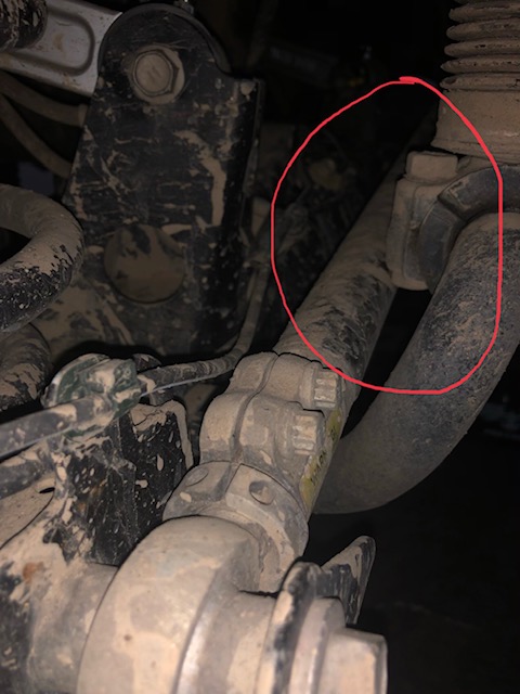

Ordered myself this new bar. Additionally, I'm going to pair it with the Panhard correction kit that has been all over this forum to correct the rear end geometry as well as provide clearance with this bar. Attached is a picture I took yesterday. This is the Panhard bar contacting the KDSS sway bar system. This is even with the icon adjustable Panhard bar with the 5 degree bend in it that is supposed to "prevent" this ???? from happening. You can see it still contacts. Should arrive soon.

You CAN NOT use this part with the Panhard correction kit, if you do it will be a colossal disaster. No joke.
If you are really going to do this, contact me and cancel your order, it will not work. Once again, no joke.
I have not installed the Panhard correction kit onto my vehicle yet. I think I would rather have the added clearance from this Panhard bar vs. correcting the geometry with the Panhard correction kit. Is there a reason you know this will not work? I won't go forward with the correction kit if you feel this strongly. Thanks for the warning.
