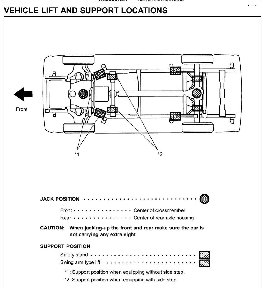

On the rear, there really isn't an issue with this 21'' jack and jacking by the pumpkin on the rear differential...
But on the front... I'm kind of confused.
As you can see in this picture, utilizing this jack point in the front which seems pretty safe, at 21'' maxing the jack out, I can't even get a tire off the floor!!!
But... at this point which is lower... I can get the truck far off the ground... I just don't like this spot as much :/
My newbie questions are as follows...
  • Is this jack point OK? I don't really see where else will work for the front (I know some people suggest the control arms, but sorry - I'm not too comfortable with that).
  • If it is OK, is it OK for me to be jacking just one side and placing a jack stand? I feel like on the driver side there is undue pressure from having passenger side jacked up. I don't have any technical basis for what I'm saying; it just seems like a lot of the weight is shifted and forced on opposite side... in a bad way. Am I just new and stupid on this point or is there any legitimacy to it?
  • Lastly, and kind of related to my last point -- Should I jack from the middle of that bar and but jack stands on both sides? Or jack one side at a time and then put the stands on?
All these questions relate to the front as I stated the back lifts both sides at the same time when you use the middle of the rear diff.
Thanks guys! :thumb:
Theres a crossmember above the rear smaller skid plate. Use that as your jack point. If you need a spacer use a chunk of solid wood (4x4, 2x4, etc) to give yourself more height.
Looks like your missing the rear half of your skid plate. I'd trust making from there or right Inst your steering rack.
As for jack stands I personally just jack one side up and slide it under then go to the other side but either of your ideas would work fine I do it the way I do mostly due to the fact I can't get the jack stands at the same height if I do them at the same time .
