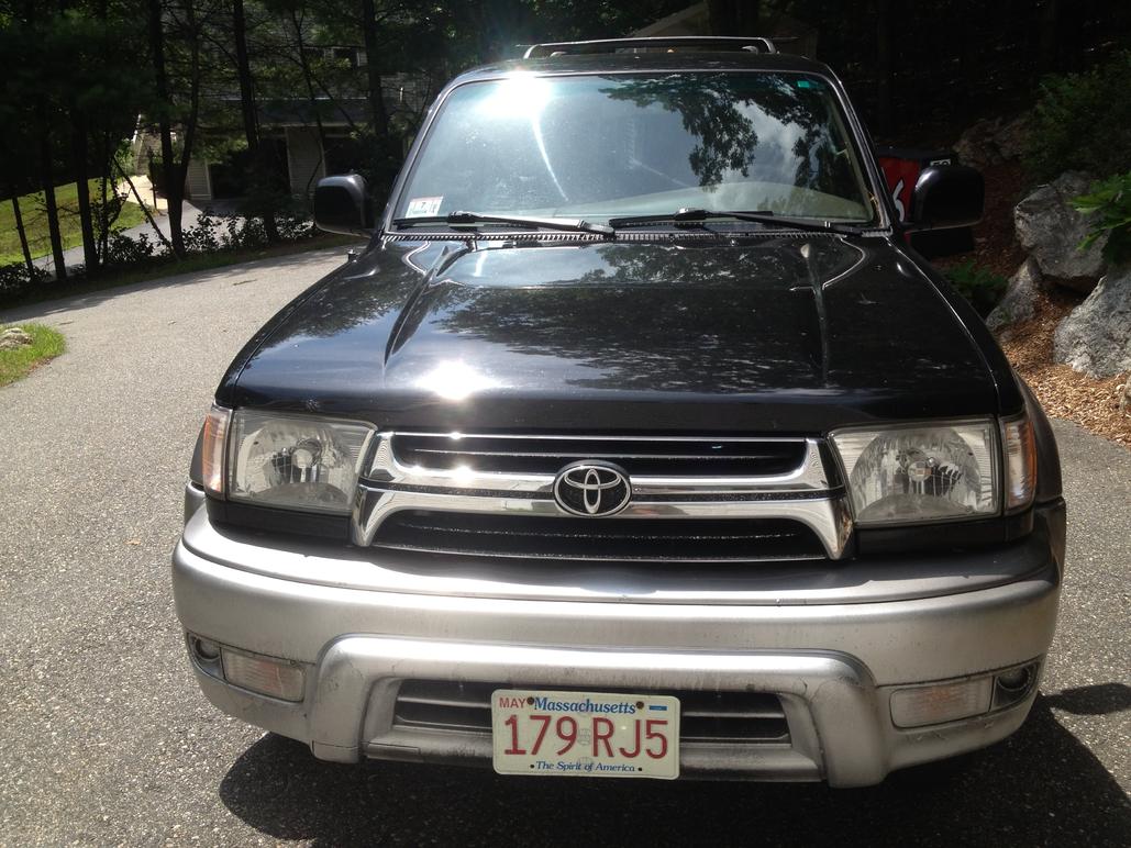

I was thinking of wheeling it for sure, and I definitely would be willing to sacrifice some creature comforts lol.... unfortunately there aren't many places around where I live to do offloading/mudding (I live in NE Massachusetts) I really want to bring her up to NH where there are lots of good places for wheelin... I agree the possibilitys are endless!! I have a job now but I need to cover my own gas and insurance so $$ is a little tight. is my t4r alright for offroading now? what mods do you recommend for taking her on her first trip??
heres the truck, sittin pretty :D
