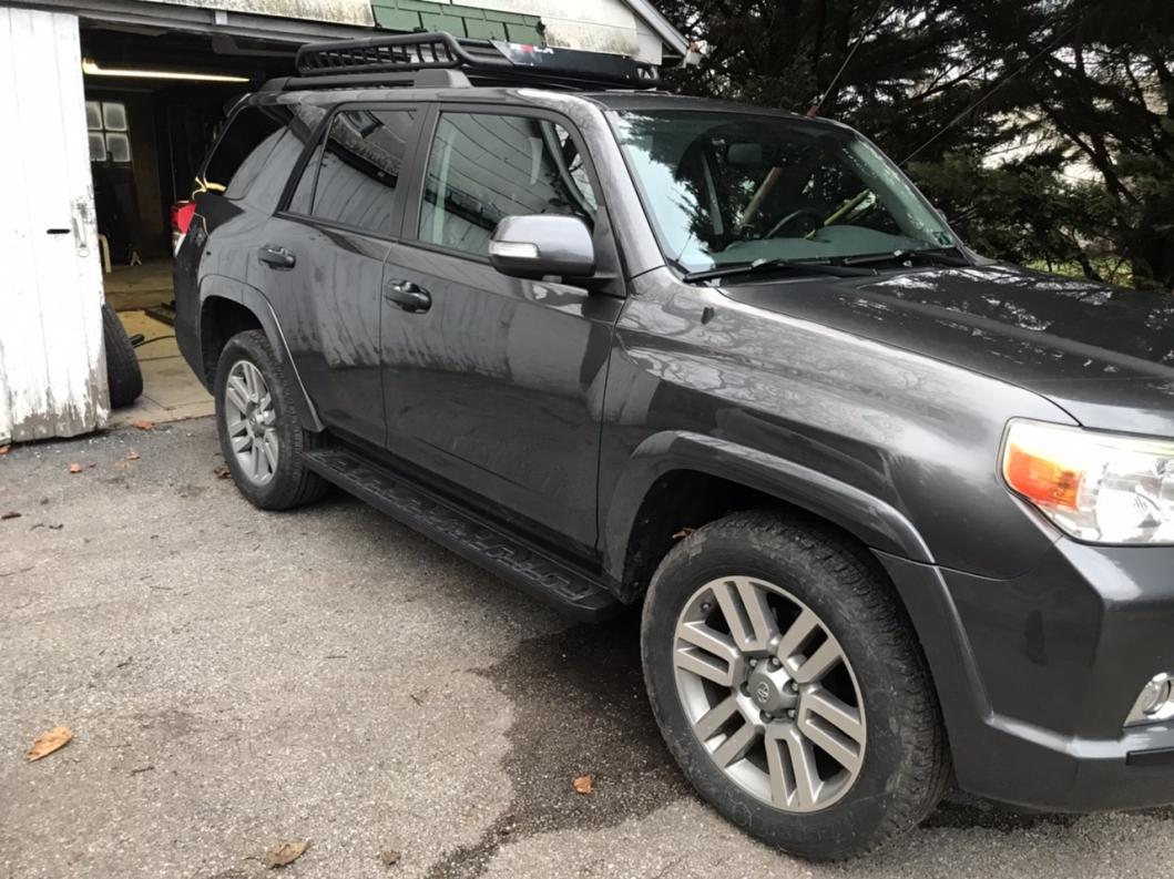

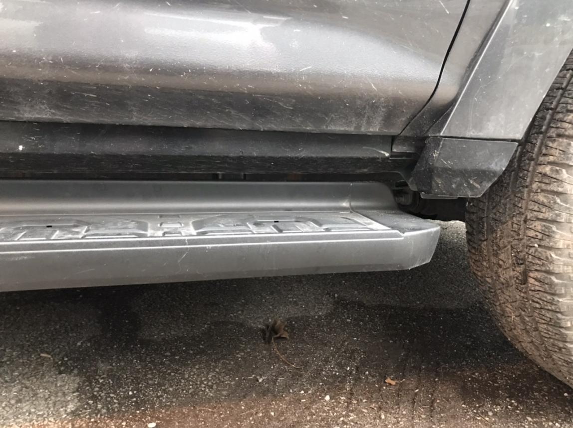

They fit! When I was taking the sliders off last week I must’ve been looking in the wrong areas. The Shrockworks Trail trim doesn’t cover the mounting locations, nor does it interfere with the trim itself.
