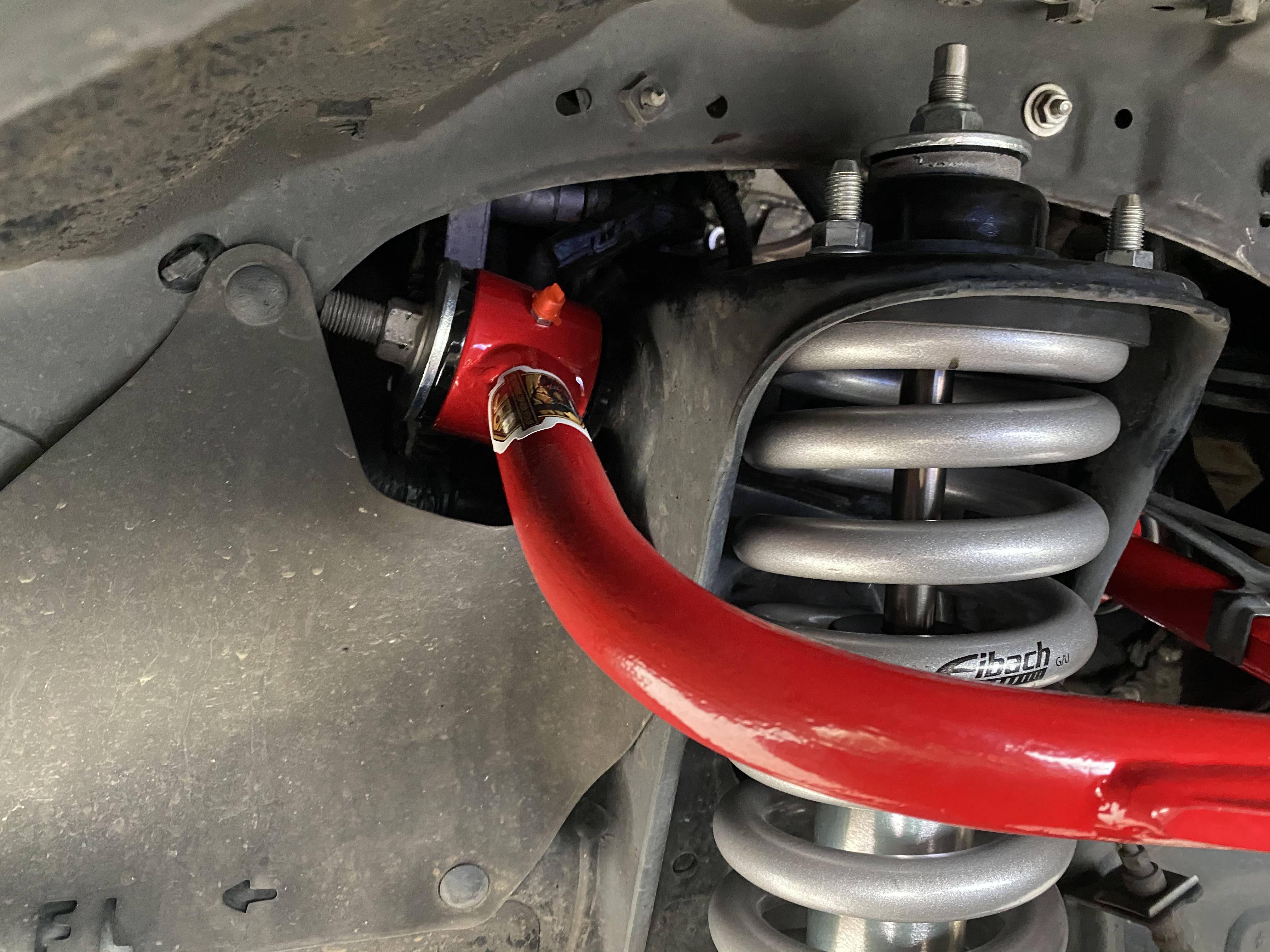

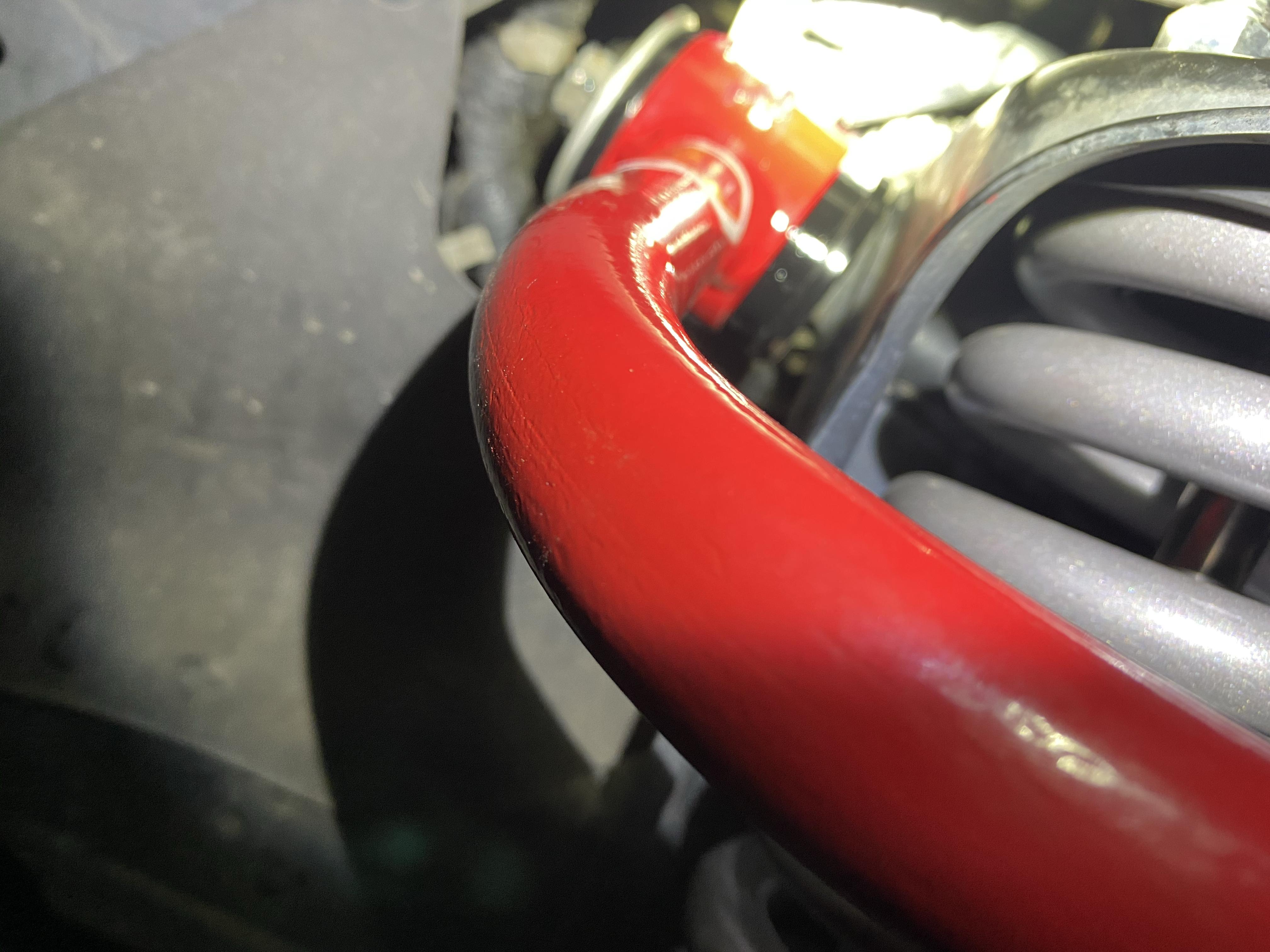

What’s up everyone! I bought and ribs had pro kit with JBA UCA’s. I paid a shop to have them install it because I’m moving to Az and just don’t have the time to do it right now. They seemed to have royalty f*cked this up. UCA boot was in backwards and then they didn’t even use the hardware that JBA supplied with the kit! I’m gonna have another shop fix all this shit but do I need new bushings? Are these ruined now? I know I need to contact contact JBA for new hardware but should I get bushing too?
I guess they didn't use the inner washers that retain the bushing in the UCA? How many miles since the butcher job? They might be ok if you don't put too many miles on it and get the washer installed properly. The inside of the bushing that the bolt slides through might be damaged though. Do you still have the inner washers?
Worse case scenario is you overnight some bushings from JBA and get it fixed right, or if thats not possible, you roll with the damaged bushings with the inner washers installed and once you get to AZ, you replace the bushings.

Ive got about five miles on it then I noticed that they screwed this up. I contacted JBA and am going to see if he will overnight me some washers. Hopefully this is an easy fix. No im guessing the ship just threw them out. I will call them in the morning.
It would seem UCA installation is not this shop’s forte. Curious if you contacted the shop and called them out on their error?
How did they install the UCA bolt backwards too??? It's so damn long that I left it in place as I didn't want to take it out, only to have issues reinserting it lol.

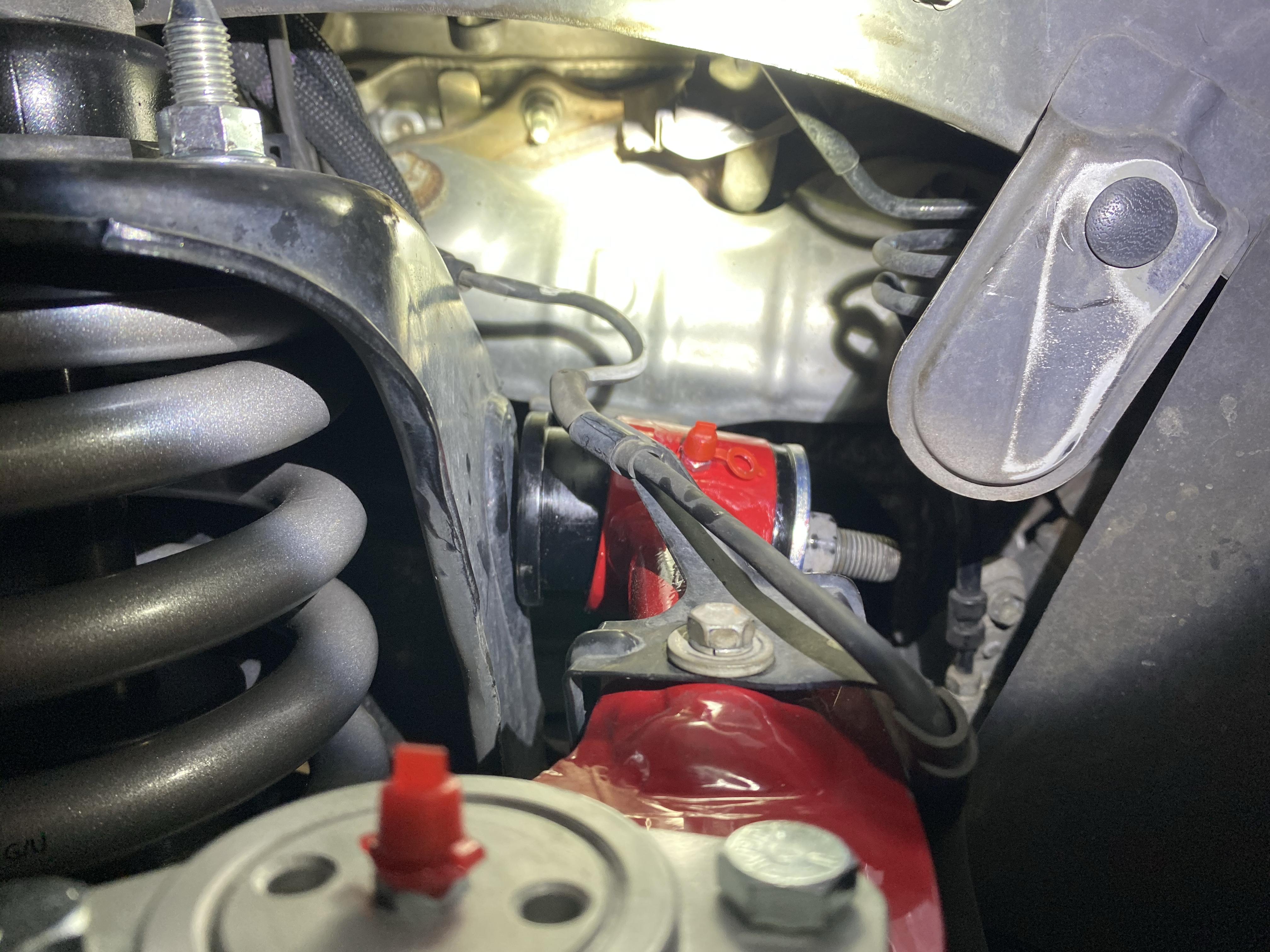

If they are a decent shop any costs to correct the situation should be on them. I get things happen but that's a pretty obvious install issue. Is the other side the same way?

The washers didn't fit, OMG mechanic thinks he's an engineer. I think worst case is you'll need new bushings. How'd the alignment go?

Luckily I noticed it before I paid for an alignment. Also lucky that JBA is overnighting me new washers and bushings. Now it costed me an extra $127. I’m hoping that it just needs the washers put in and nothing else is damaged. Idk I’m still unsure of what to even do.

Agreed! I just can't. I mean the guy literally told me he has the washer but didn't put them in because it was a tight fit! I didn't even know what to respond.
