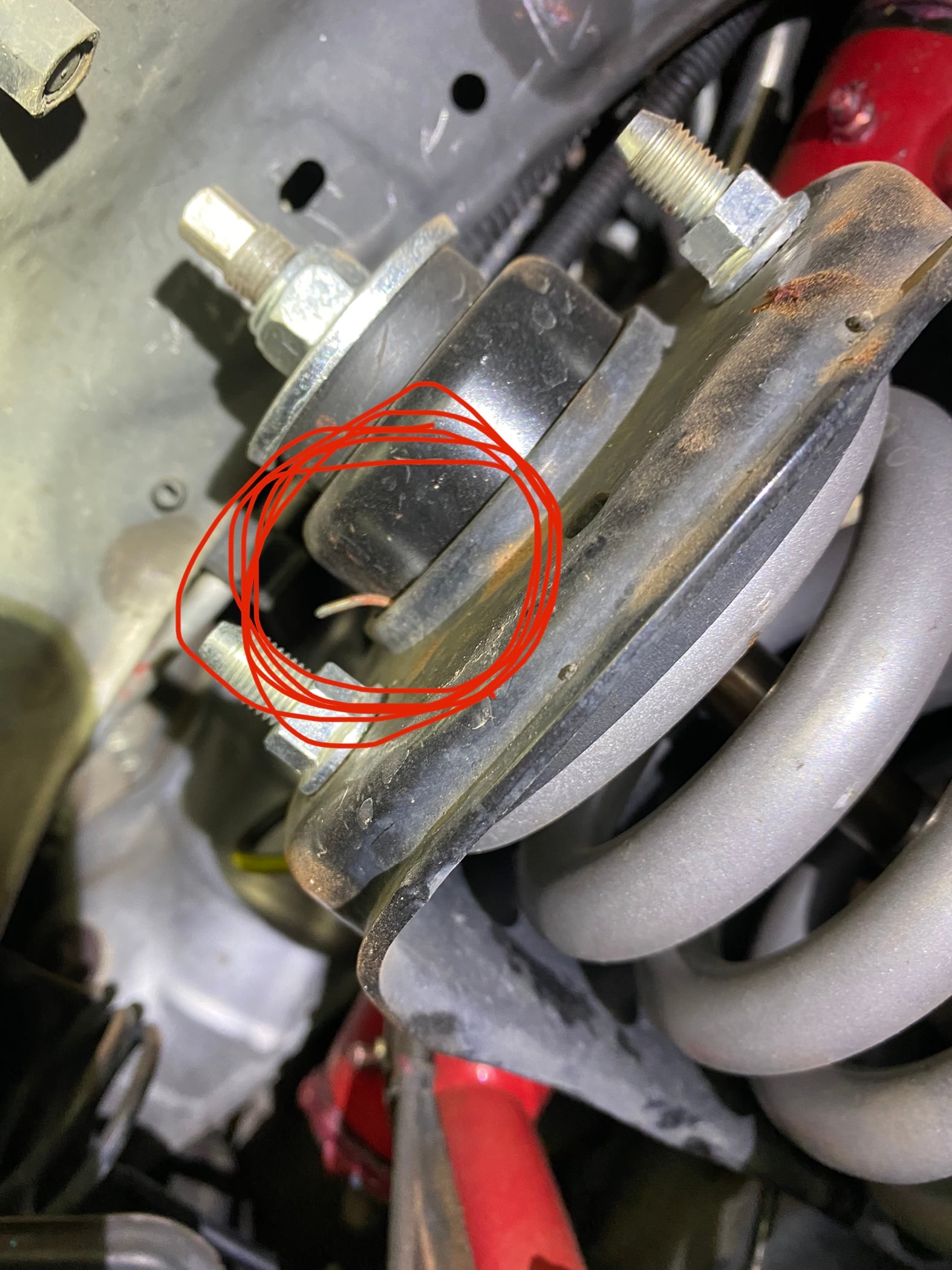

Can anybody tell me what this wire is? I just got back from Sedona the vehicle was fine. I went to visually check everything out and noticed this wire sticking out? It’s hard metal? Is this from improper install?
Have you tried pulling the wire out? Hopefully, it's just a loose piece of wire kicked up by the tire that some how happened to land in that spot. If so, that's great, otherwise ...
I'm guessing the installer used a length of wire to help hold up (or in) the coil over assembly, and forgot to remove it when he tightened up the bolts and decided to just clip off the ends. Your photo shows the upper end of the wire. Can you see the other end of the wire? Is it wrapped around something? The answer to these questions will help determine if this is an issue that must be resolved as soon as possible.
It appears to me the wire is embedded between two hard surfaces where the lower surface is the top hat and the upper surface is the frame mount. Verify the three bolts are still properly tightened. I'm strongly leaning towards having the shop remove the wire because the fit between housing and top hat is not what it should be with the wire between them.
If you decide to have the shop fix this, then I think they should loosen and re-torque the lower shock mount bolts with your vehicle lowered onto the ground or driven onto an alignment rack (so they can easily get under it). I think they torqued those bolts with the vehicle on a lift and the wheel assemblies were unweighted as described in a previous post.

I attempted to remove the wire but it doesn't want to go anywhere. I can't imagine its interfering with anything and I have no clue what its doing there. As bad as it sounds I might just leave it until I absolutely have to do something about it.
You will prob be ight. I wouldn't sweat it.
Yeah agreed. That said, given the nightmare you've been through, not surprised there's some paranoia about it.
