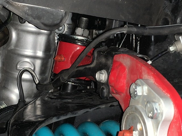

Do yourself a favor and get some needle nose pliers and bend the larger clamp on that brake line so it’s loose. With a lift, you risk stretching that cable (which you can see in your picture).

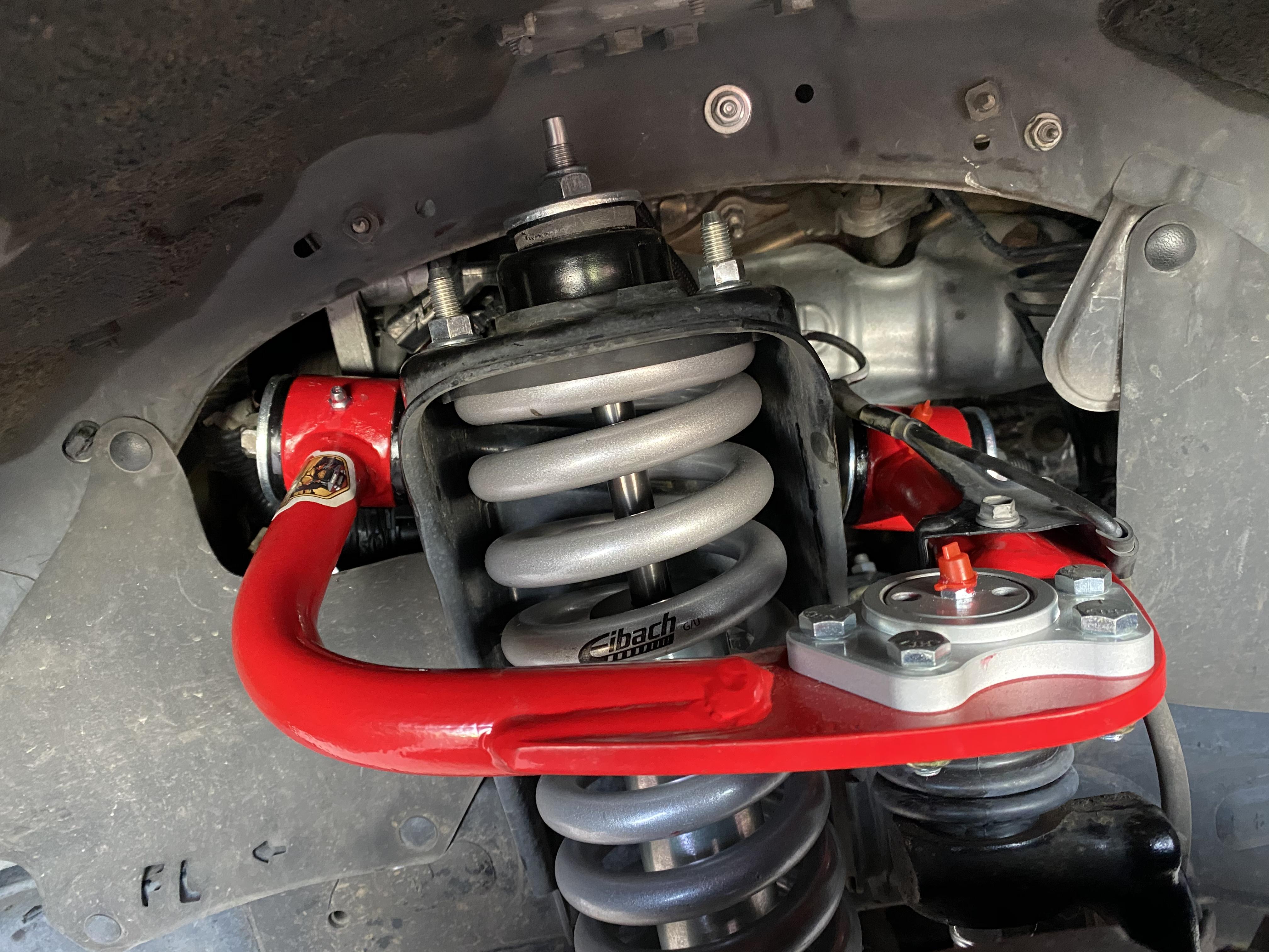

This is from my self install. Notice the upper guide on the UCA bracket is still intact.

This might be stupid but are you talking about the side of the bracket? Can you draw an arrow to where you're talking about?
Yes. On the ABS bracket that screws into the UCA, there are two formed clamps that hold the ABS line. The first clamp is smaller in diameter and is on the top of the bracket as the wire leaves the engine bay and the second is a larger diameter and it holds the ABS line to the side of the UCA as it travels down to the brake assembly. The second, larger one, is very tight post lift, but can be opened up to let that part of the line out and give it more slack for any potential increase separation from articulation between the bracket and the brake assembly.
If you look at the picture I posted, look to the right of the bolt that holds the abs bracket to the UCA. Notice how there is no clamp on that side and the brake line is free to move.
Yup. I see what you’re saying now. This seems like a good idea. I will be doing that soon. Thanks
