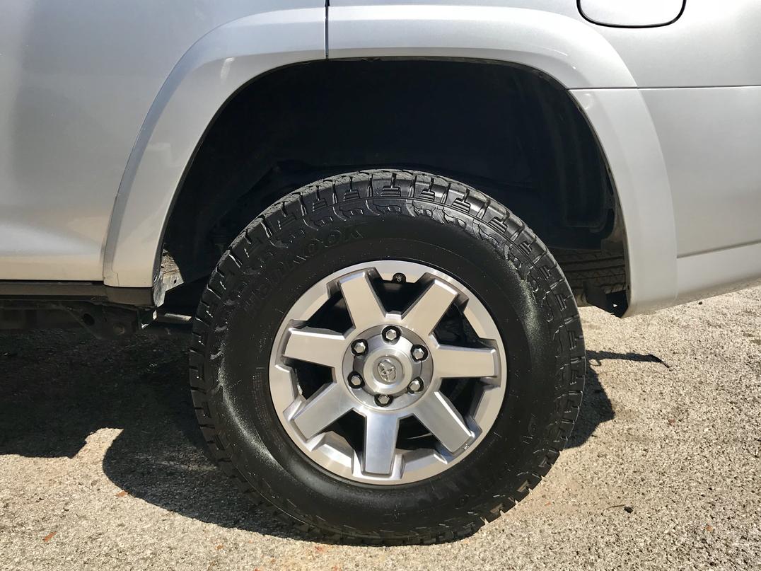

For anyone wondering what 285/70/17 looks like on an unlifted TRD Pro, here's some pictures. There's only a 1/8" gap between the tire and the modded fender liner at full lock on a level surface, so I'm going to be lifting it this week.
These look great. any rubbing on your UCA's?

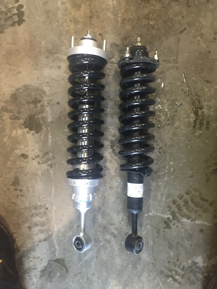

As for the bumper trim, i'll try and get some pictures of mine tomorrow and post them up tomorrow night.

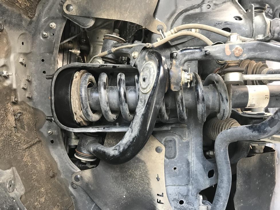

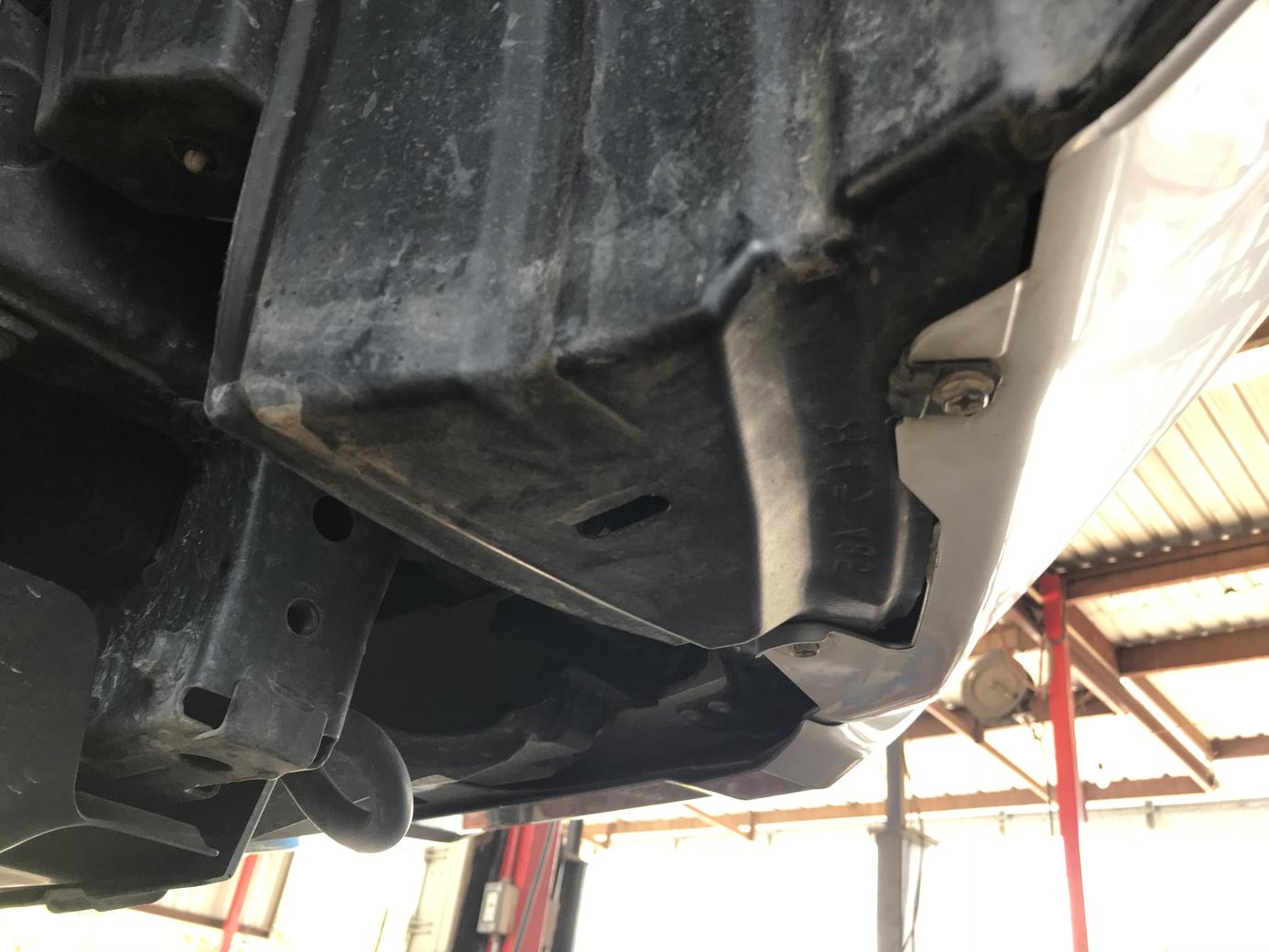

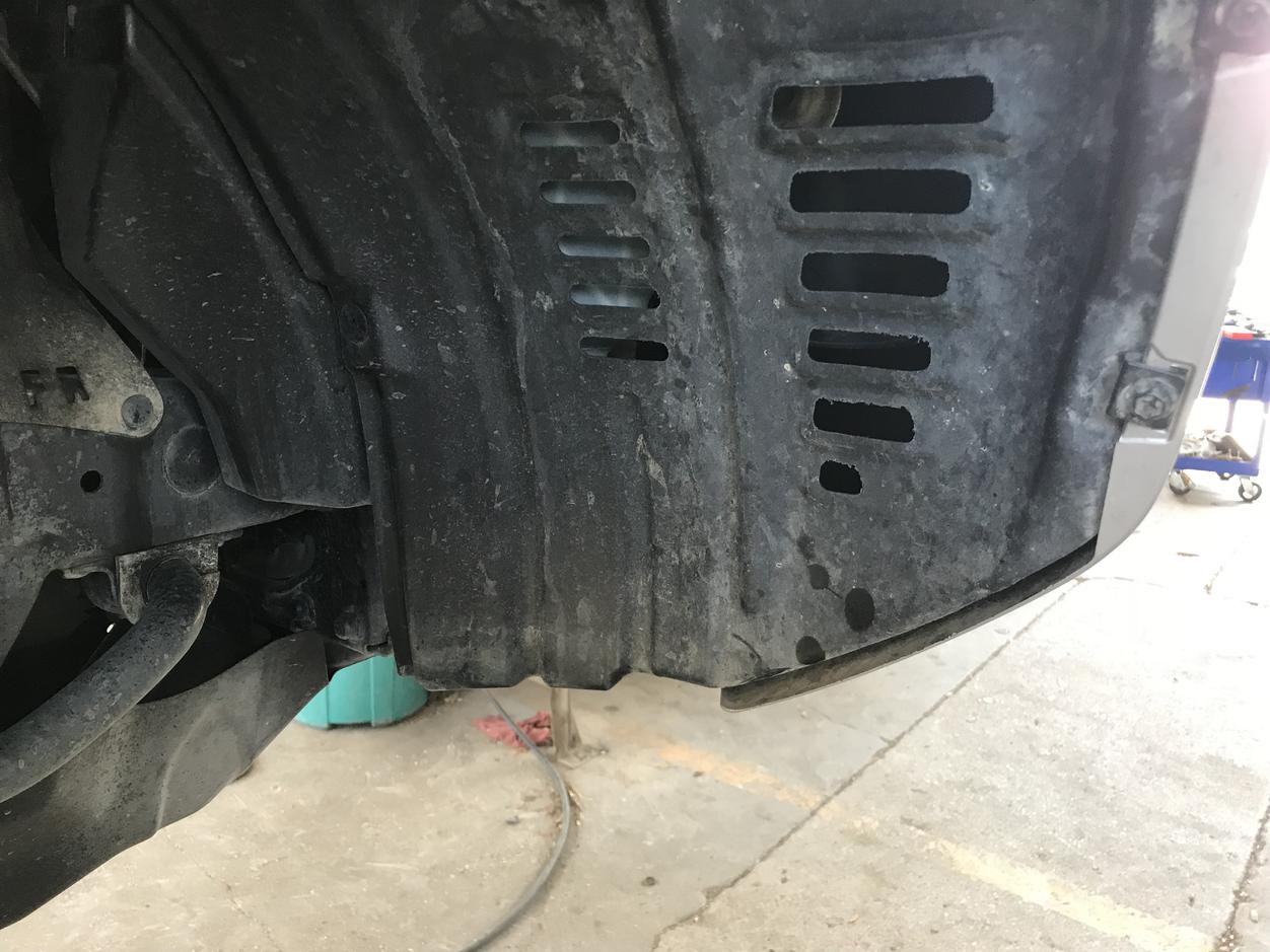

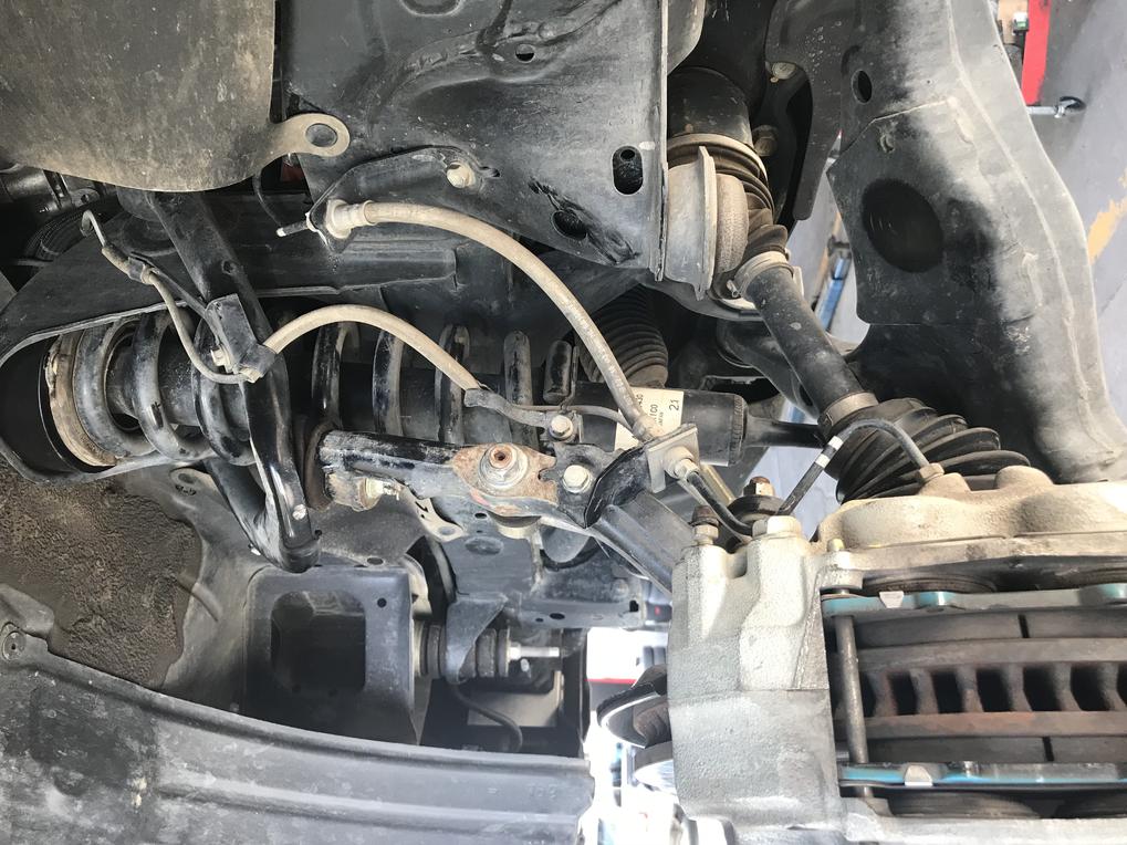

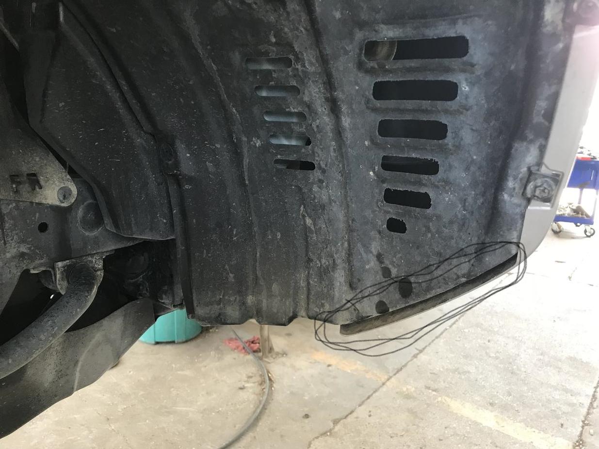

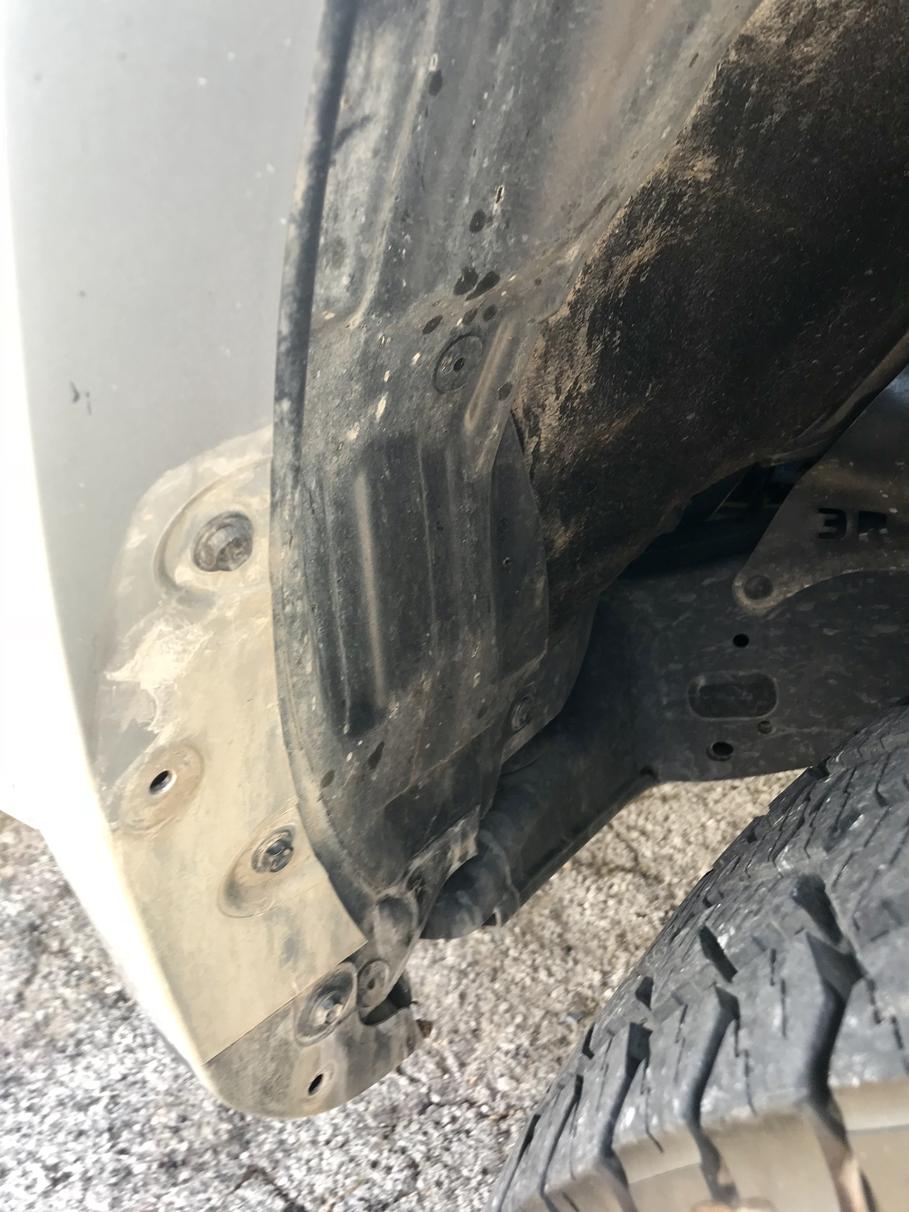

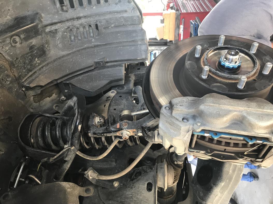

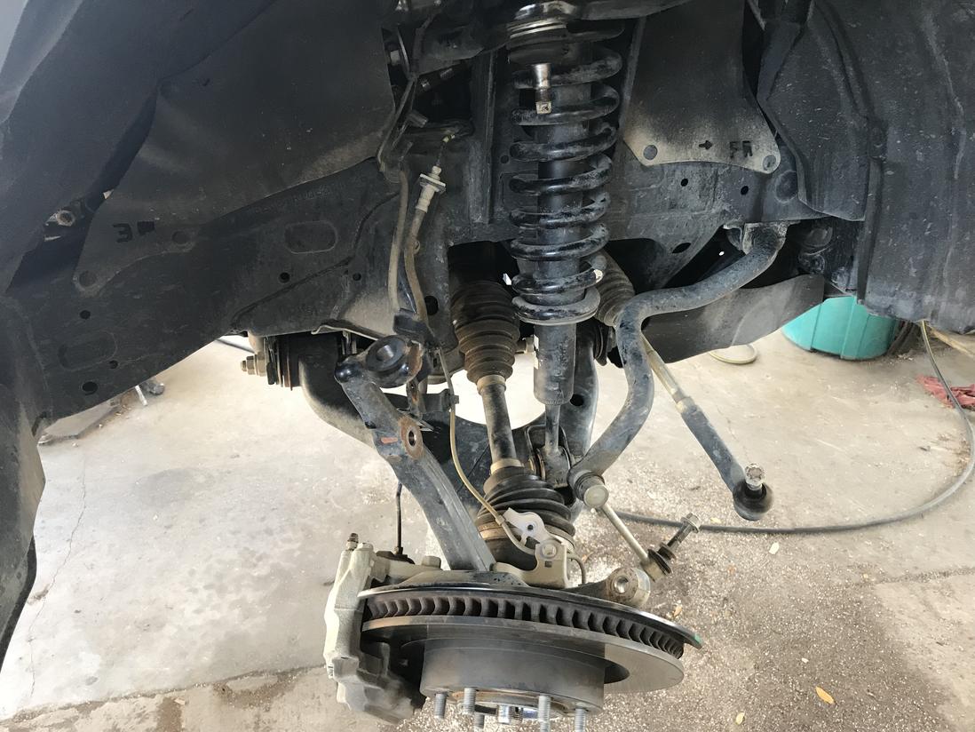

Hopefully, these photos made it. The last two are where I believe you are saying to unbolt and move the fender liner forward. Correct? Also, from what I can tell, I do not have either KDSS or XREAS on this vehicle - can anyone confirm from these photos? I have pics from diff angles if needed. Thanks alot.
Nope just standard suspension which is just fine. Yes, those last 2 pictures are exactly what I'm talking about. Take out those 2 bolts, push the black liner and far forward as possible, then trim! Excuse my art, don't be jealous! Cut as much out of that area as possible AFTER the liner is moved forward to expose as much as possible.
Thanks a million. Would you upgrade to the front adjustable 5100s and just keep them at stock (0) level until the day I pull off the front spacers? Also, what UCAs can you recommend? Im up for doing them while the truck is apart now, but may be limited to amazon unless I can find a pair locally here in DFW area. Thanks again - tons of great advice here. Will post pics daily of my progress.

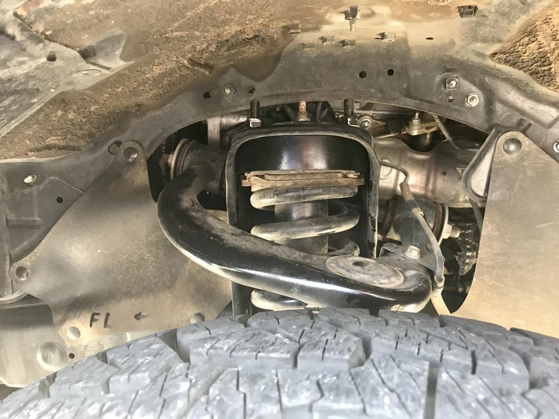

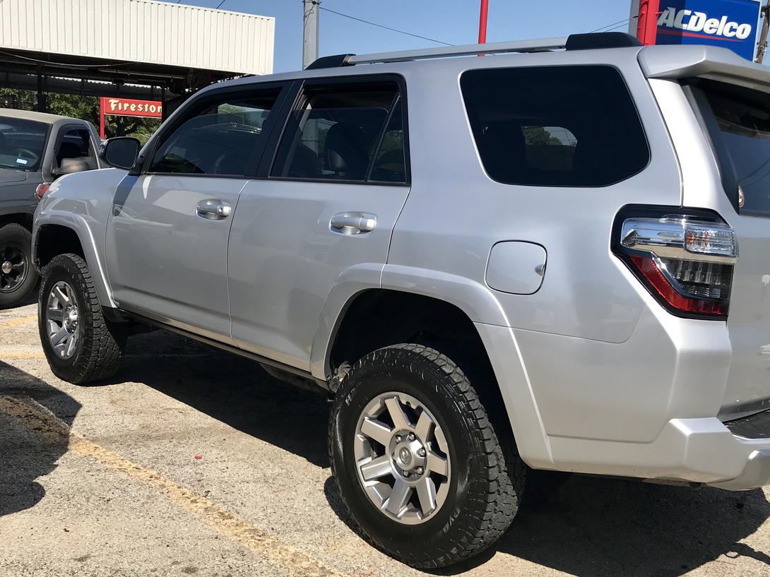

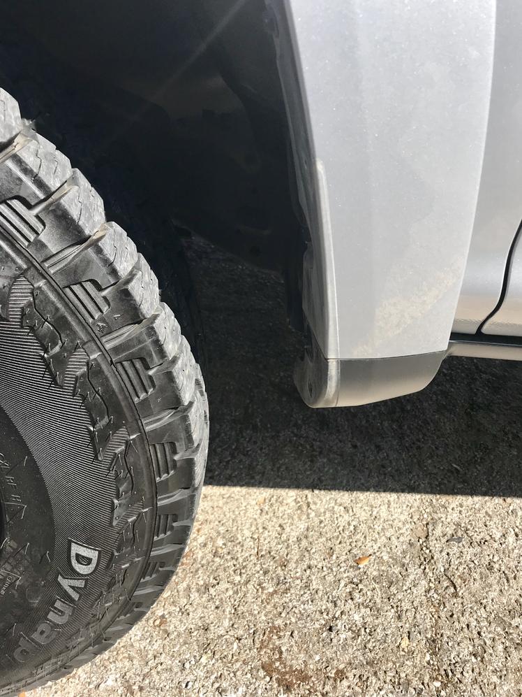

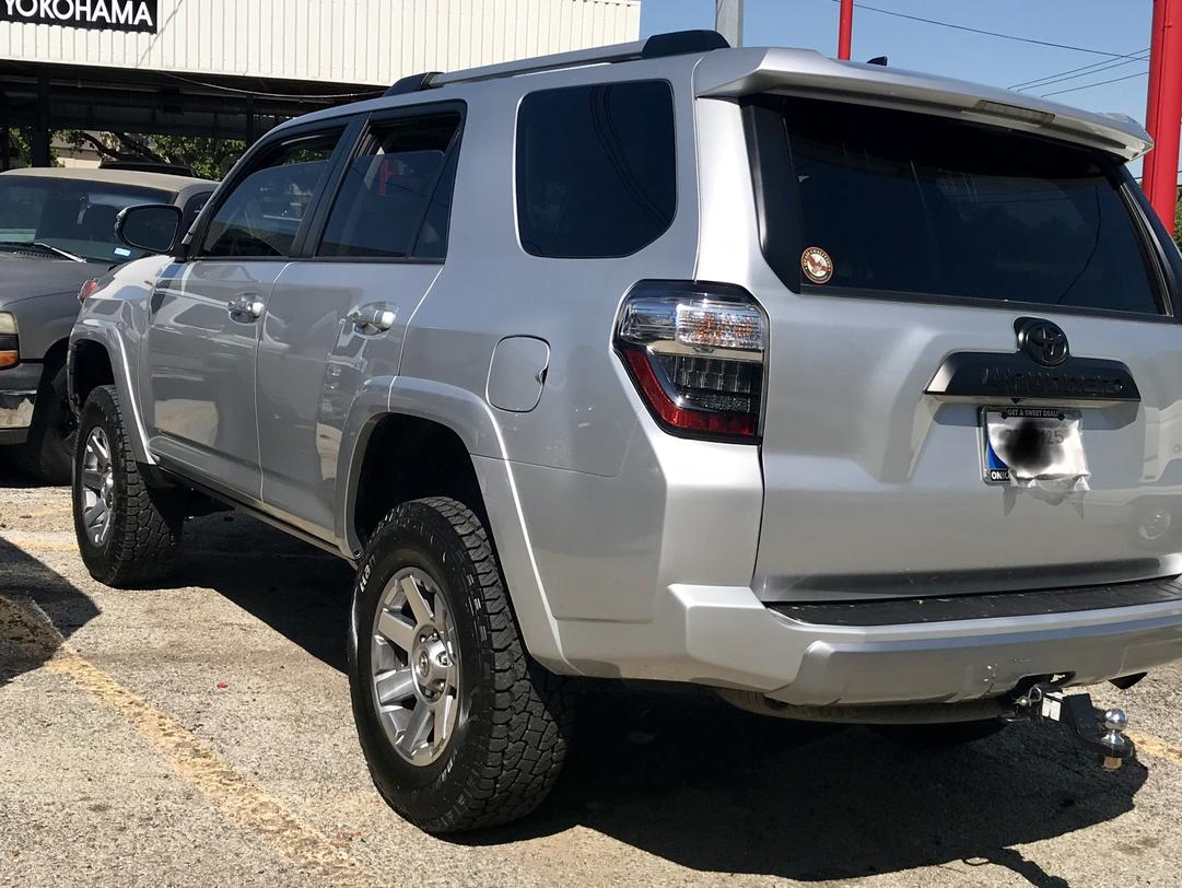

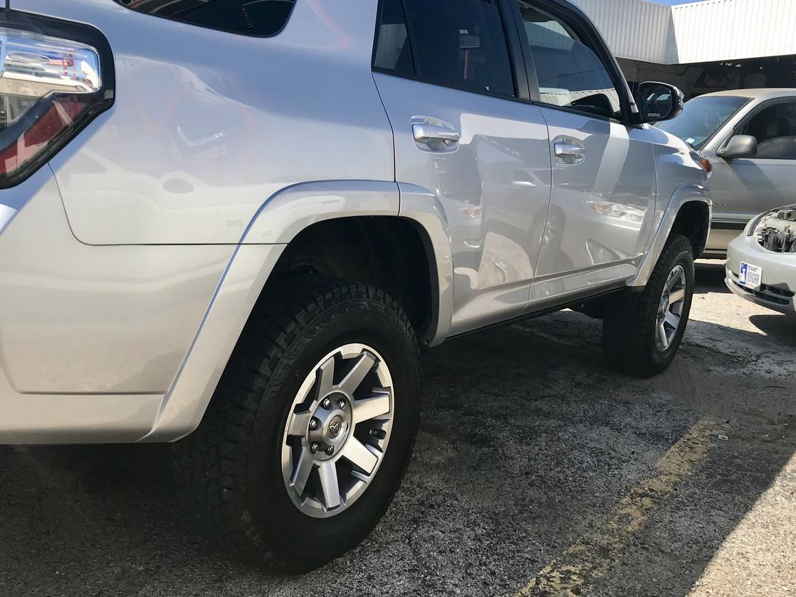

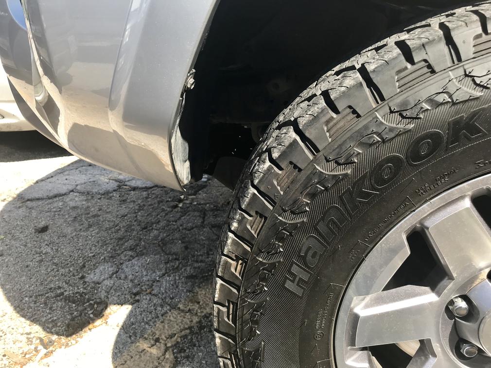

Photos from this morning. Daystar kit has been installed. The 265 Hankook ATMs are still on the truck, but the 285 Nitto RGs are due for delivery later today. You can see that both front and rear mudflaps are removed. Rears will be trimmed per advice above and re-installed. From the photos with the 265s still on the truck, it appears to have plenty of clearance for the 285s. Also, 5100s going on the rear and still hoping for someone to answer my above question on the UCAs from Amazon. More pics to come soon..

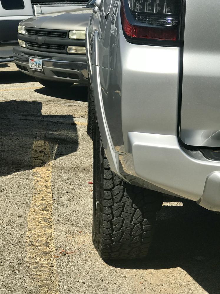

One more photo..
Again, these are the 265s, but I am hoping for a wider stance with the 285 RGs - without the need for spacers, but we shall see...
