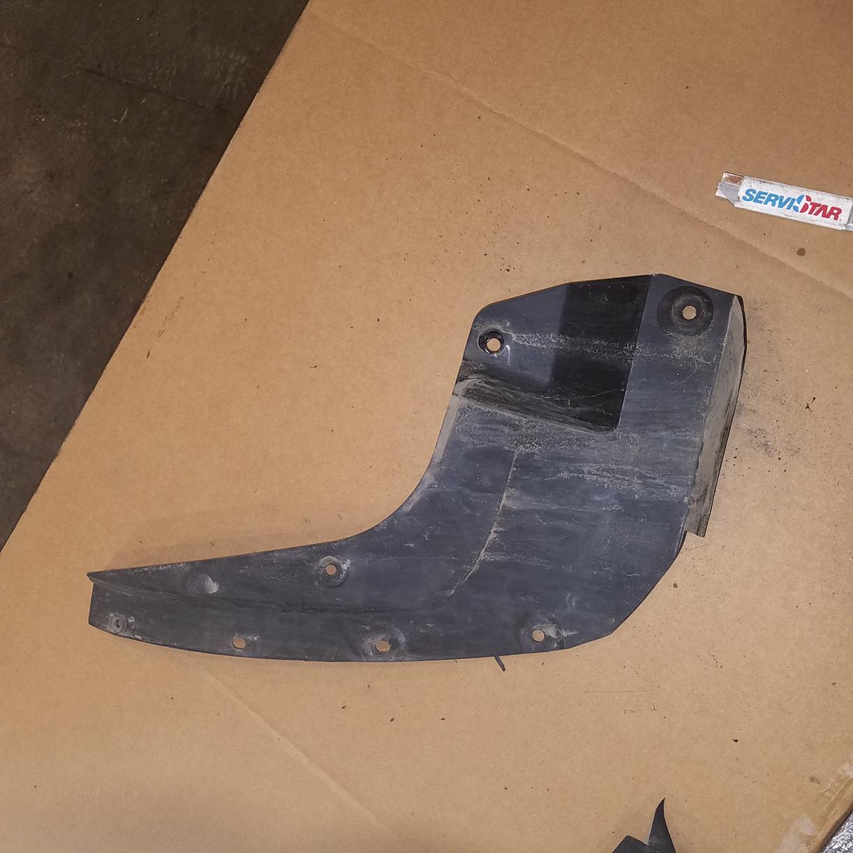

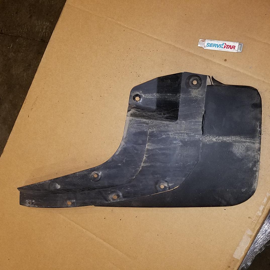

Rear mud flaps are not an issue, front is. If you remove the rear flaps, you'll have a huge hole there since the fender liner doesn't cover behind the flap. You'll have to cut the rear flaps if you want to modify them in any way. Your stock wheels are kinda narrow for those tires also, but spacers are not an option IMO. I think you're going to rub the sidewall on the upper control arm with stock wheels but I could be wrong. As for the tires, the RG is great after the first 3000-4000 wear in process. Just give them time, be extra careful in the rain and on wet roads, and you'll be happy with them.

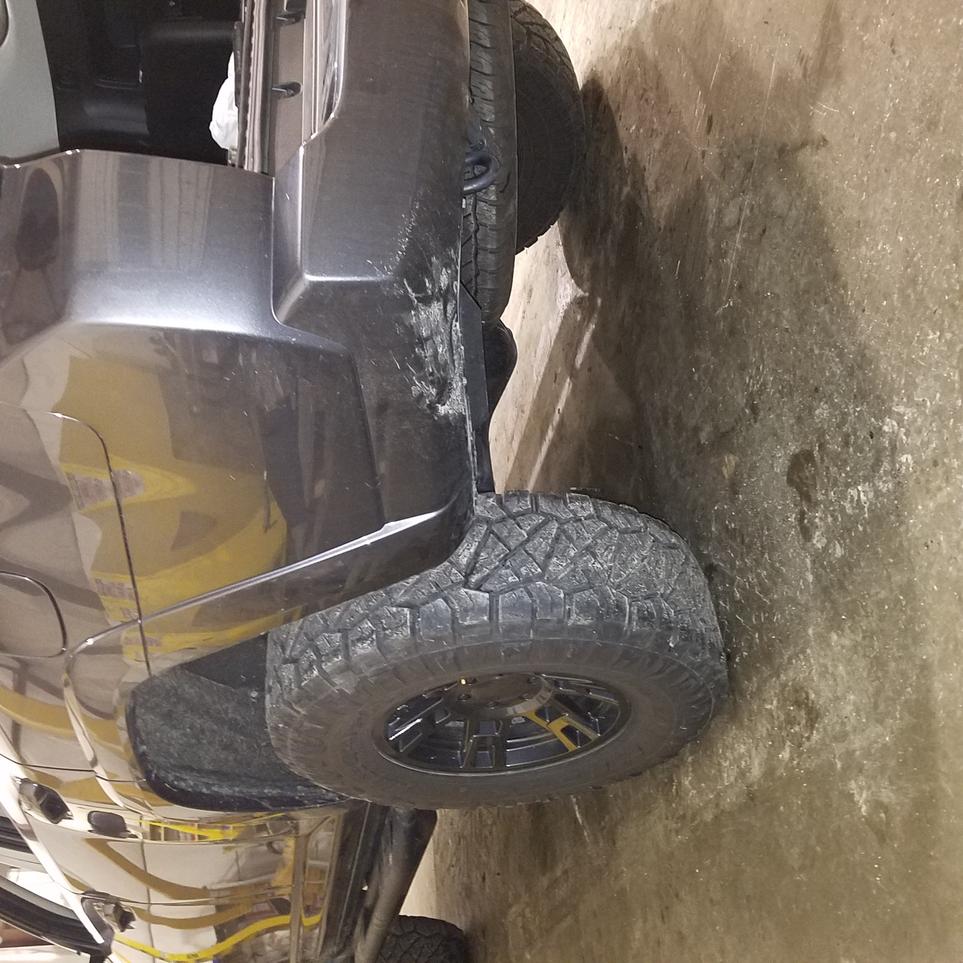

Got it and thanks! I think the TEP stock wheels are a tad wider than the TRO - maybe I misread that?? I read that about being careful during the first 3-4000mi with the RG in your earlier post and great info. Also, did you shave off the bottom of your rear mudflaps to be even with the body so as to match the front?
My wheels are not TRD Pro wheels. They are the FN wheels FX Pro which is a 17x8 with less back spacing and 0 offset. Your wheels are wider by 1/2" but still have the same back spacing which is the issue. Never know, you might get lucky, one way to find out! I did originally trim the rear flaps along the factory line which takes off 2 or 3 inches. I then cut them totally flush so there is enough to cover the hole in the bumper but there is nothing hanging lower than that. I just don't like mud flaps lol.
Got it and thanks. Here’s to getting lucky...���� I cant stand the mudflap look either! I just want the tired to look proper- not that look you see where it is clear that someone has squeezed too large a tire under a under-lifted truck. To me, that looks terrible. I also dont like the tires looking too sucked inward - prefer a bit of a wider, more stable looking stance. Not sure how to get the look I am desiring, but Phase One is underway with the Daystar kit and 285 RGs forthcoming... Your truck looks perfect to me - exactly what my goal look is. Also, I dont have KDSS or XREAS (that I can tell) on mine if that has any effect on this discussion or not. Just also noticed that I am going from a 40lb tire (Hankook 265) to the RG at 58lbs per tire. Surely that will have some negative effect on something - at least fuel economy..? That’s a big jump.

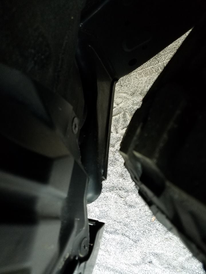

Just a side note I have 285 RGs with the same FN wheels and they rub the body mount under heavy suspension flex. Every truck is different but it looks like I have a BMC in my near future.

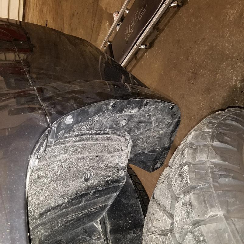

No BMC for me, just the front bumper plastic trim. Just in bolt the liner, move it as far forward as possible, bolt it back into the bottom of the bumper, and trim the bumper flush with the liner.
