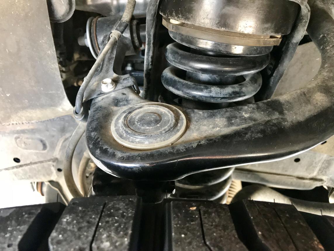

DO NOT buy the cheap junk uniball control arms from Amazon or Ebay. Search around for the failure rate on them and what happens when they fail and they will. Replacement arms are not just for guys that wheel, they make a huge difference on road also. An incorrect alignment is no fun on the road, trust me, I know. at 3" and 1* of caster, it sucks, Going back to 4* makes a huge difference in ride quality and handling.

TC makes a great arm however they are uniball not ball joint. Uniball arms are a lot of maintenance and are really made more for guys that wheel hard. IMO, stay away from uniball arms.

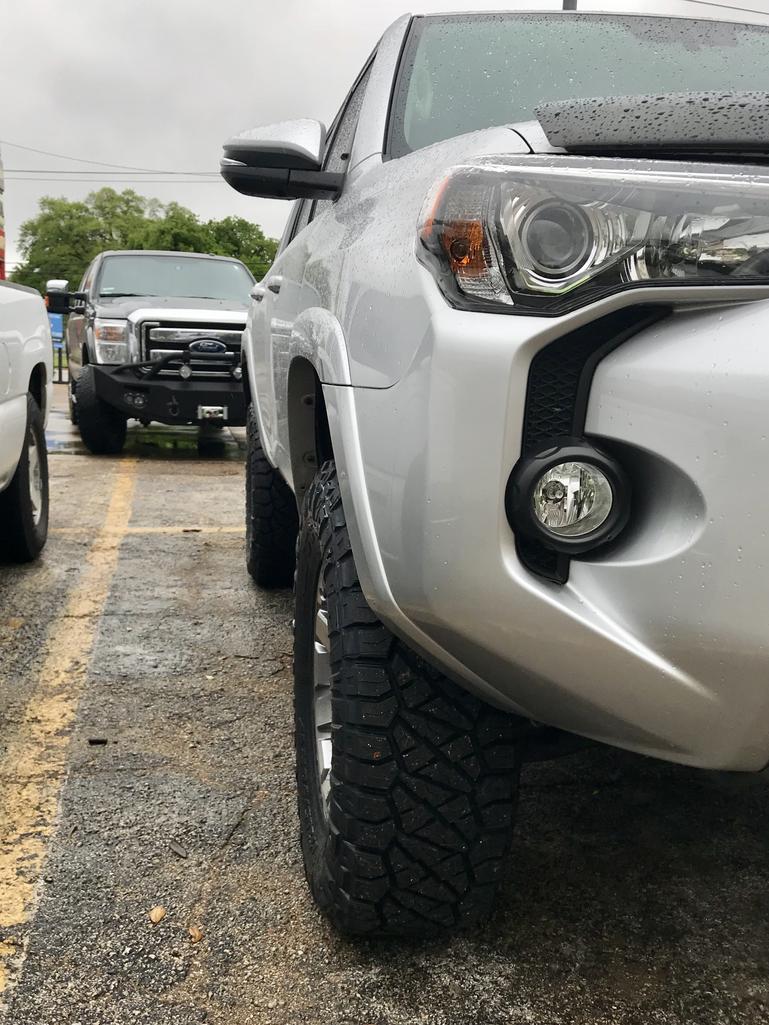

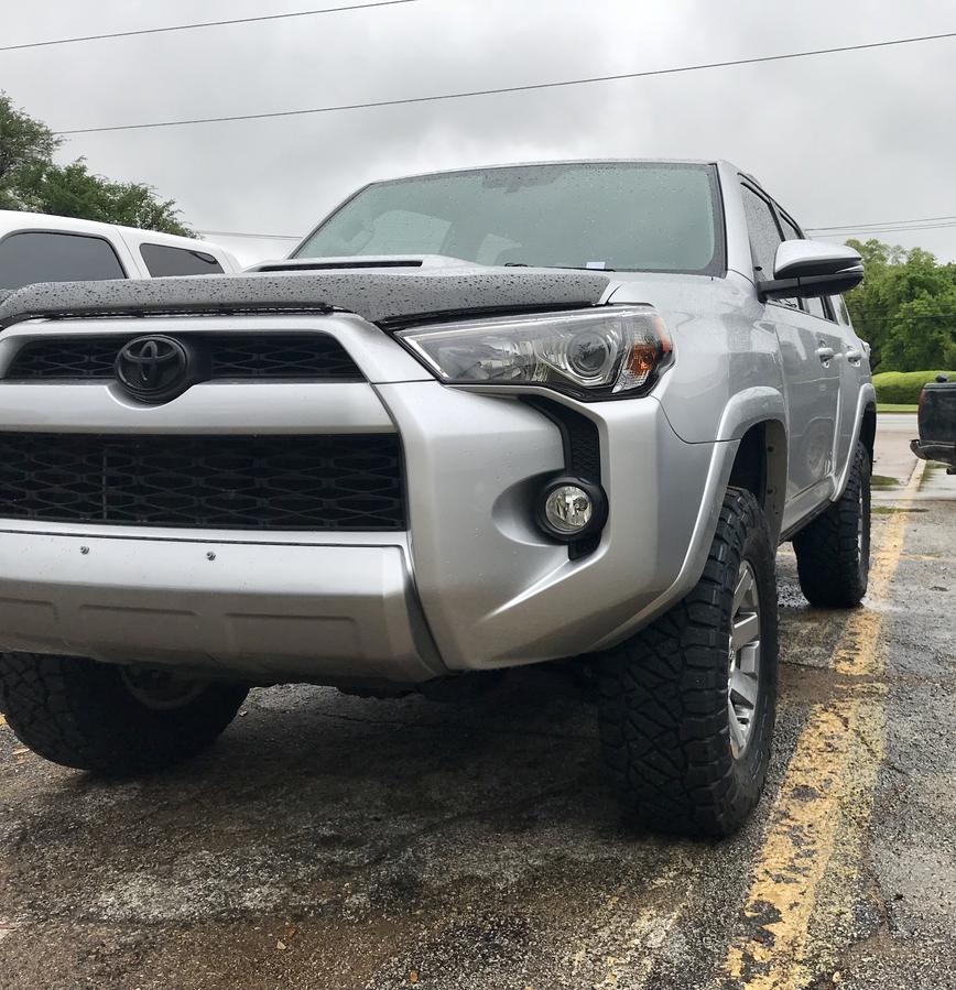

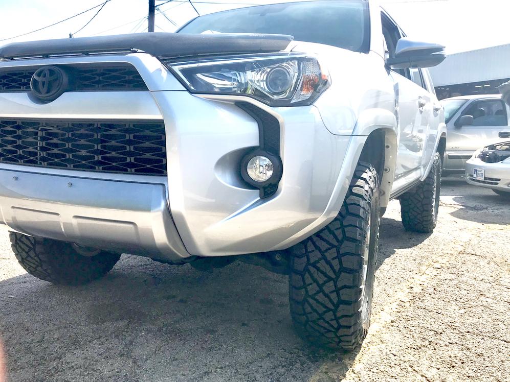

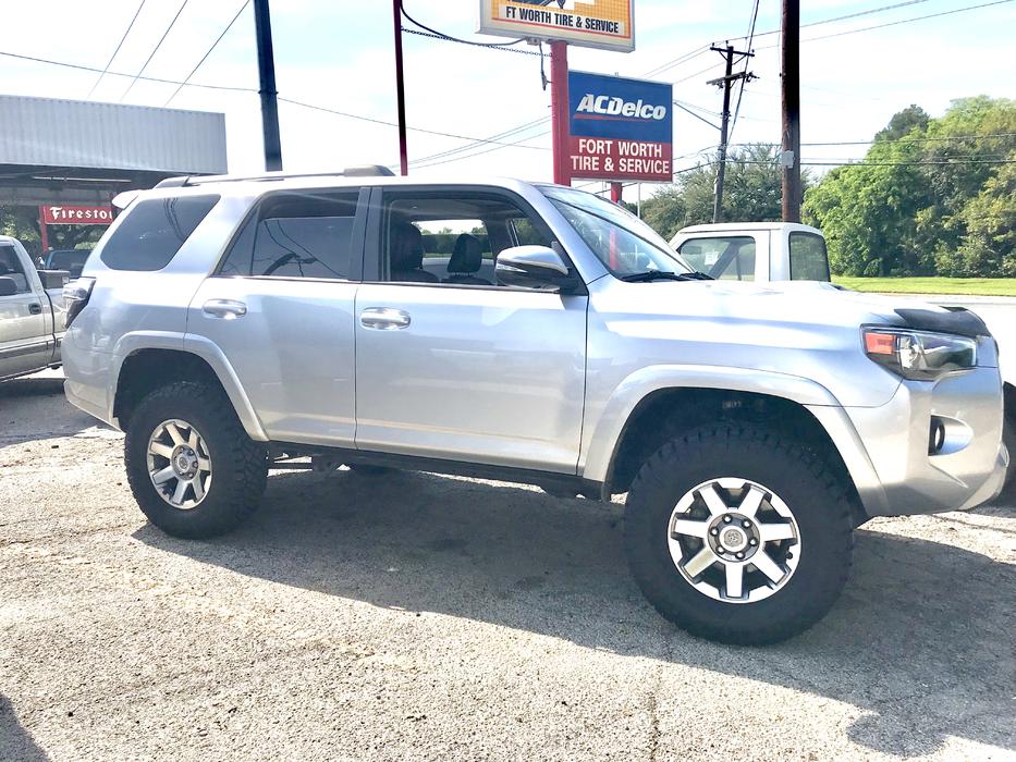

Today with RG 285s installed.
Had these on before I got there today...

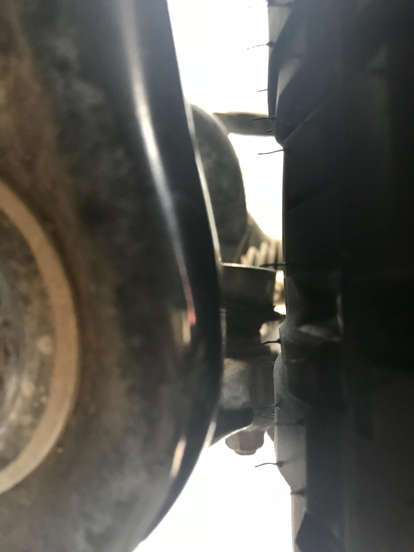

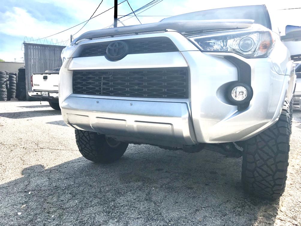

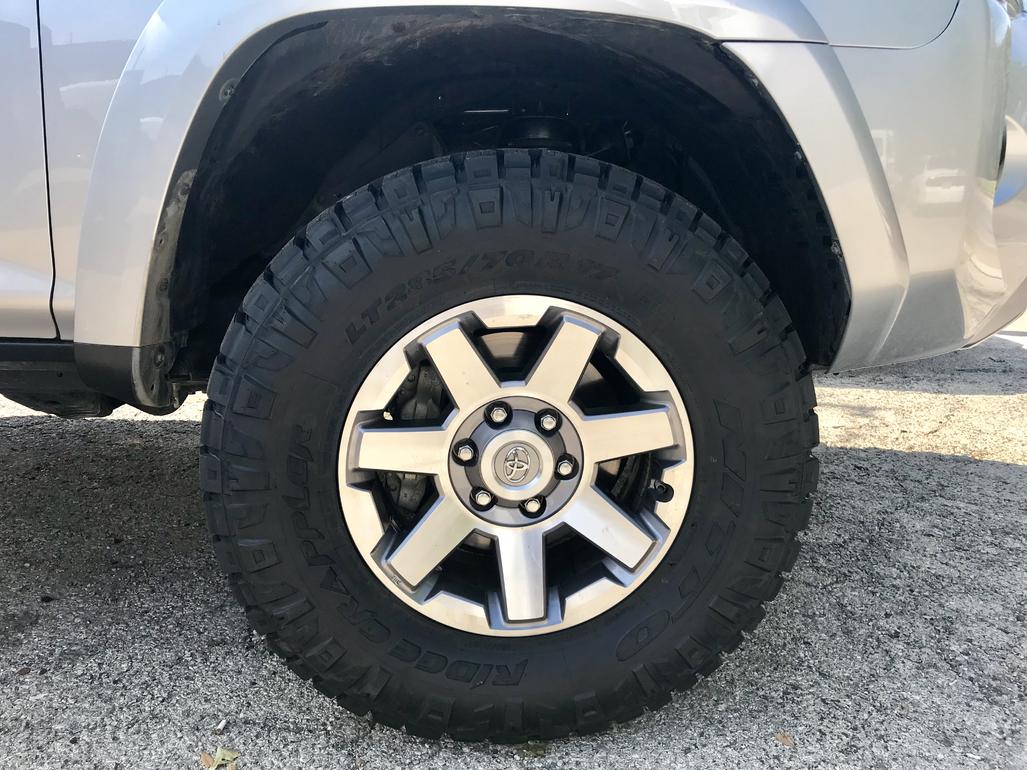

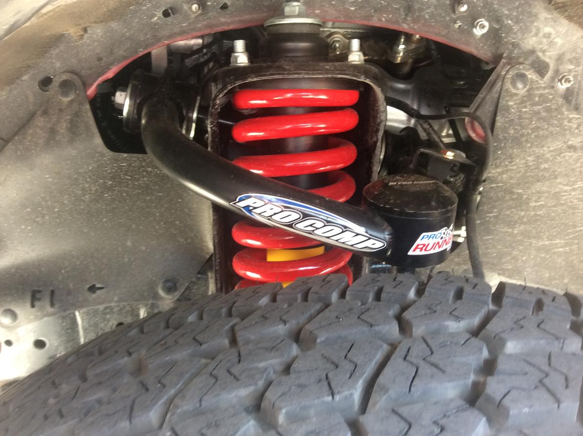

Feels like about a finger width gap between inner sidewall and UCA.
Not sure if this will be a problem or not yet...
That's pretty close but unlikely it'll cause a problem. Looks good with the factory wheels. Just make sure you get 0 camber, 0 toe, and as close to 4* caster as possible with your alignment.

Each have their pros and cons. Ball joint will last just as long if not longer than a uniball. The constant maintenance of a uniball just isn't worth it to me. I know Dobinson uses OEM Toyota ball joints. JBA uses half ton GM ball joints which should last forever. Everyone other than Dobinson also has a zerk on the ball joint which makes things easy. Different strokes though!

The real problem with the ebay UCA's are the misalignment spacers. Replace those spacers and bolts with a Dirt King setup and they are solid. But you might as well pay more and get the TC UCA's. Ask me how i know (experience, not opinion)

just wondering what "constant maintenance" you're talking about? The TC uniballs require no greasing... just wipe them clean and they're ready to go...

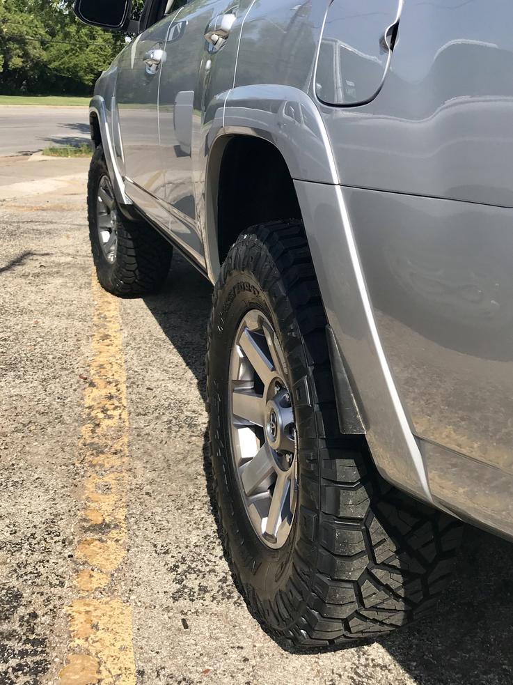

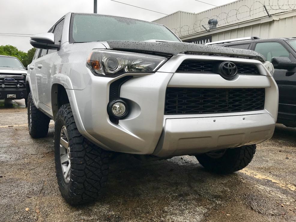

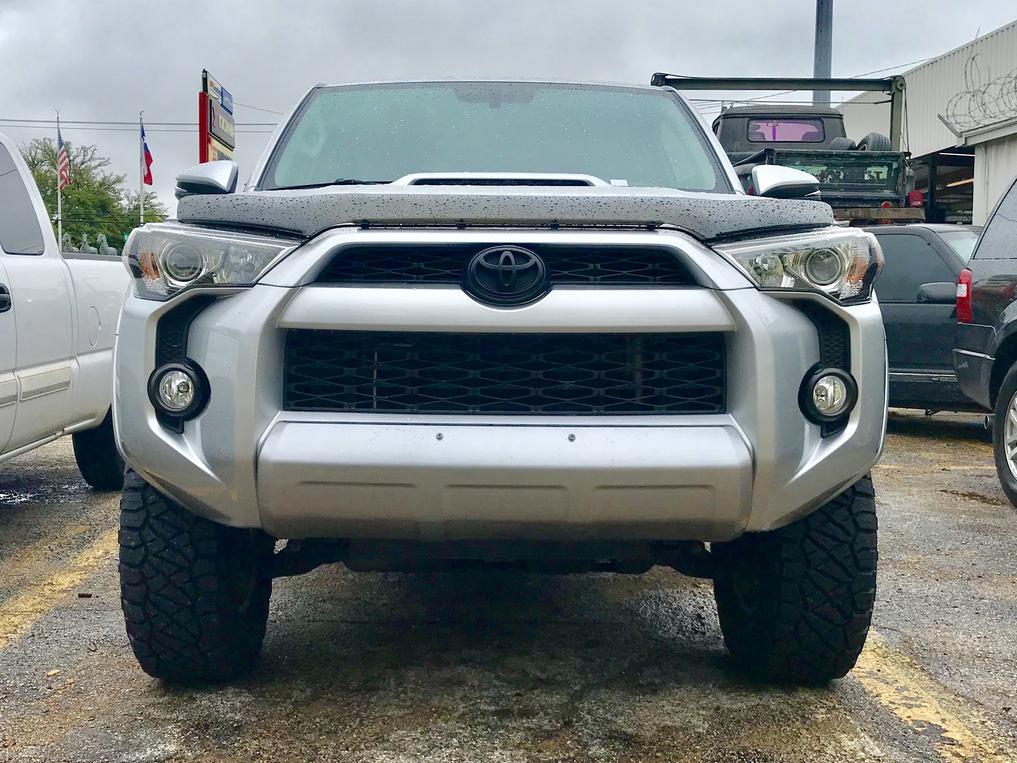

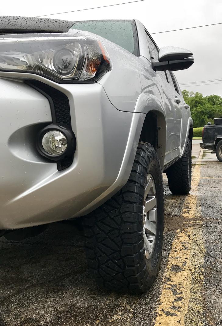

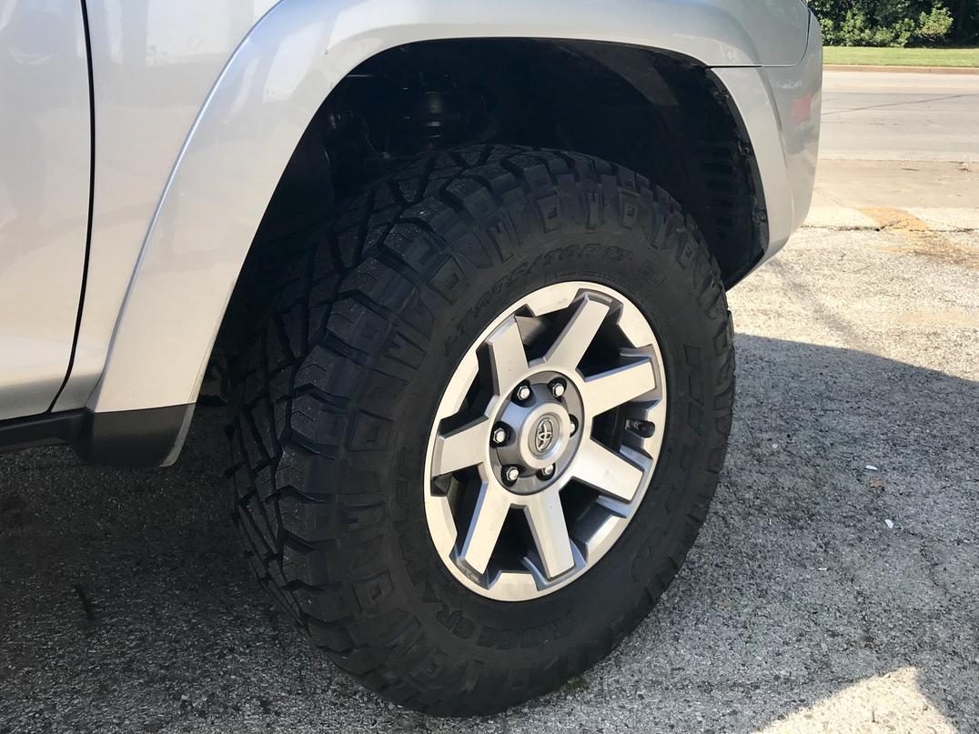

More pics from today w Daystar kit and 285 RGs.
The 285s are growing on me, but still thinking about the 1.25 spacers to move those tires out a smidge for a better look. My installer said that will def cause rubbing issues in several spots. Perhaps a set of aftermarket wheels with proper offset/bs would get them pushed out an inch or so..? He said no rubbing as of now and alignment ended up with 0 camber, very slight 0.2ish toe in (he recommended) and best caster they could do was about 2.5. Set of Billstein 5100s for rear coming tomorrow and he wants to extend rear brake lines as a cautionary move. Front/rear mudflap removal looks 110% better IMHO. Havent decided on new UCAs yet or not. Any comments or thoughts?
