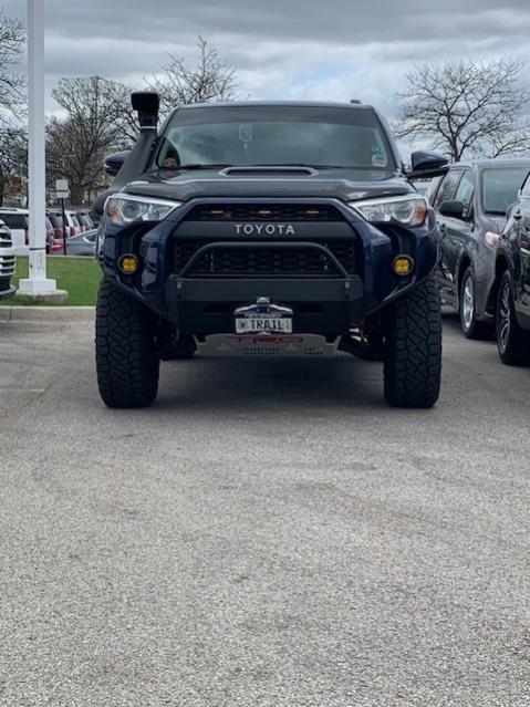

Just mounted my 285/70-17 C-load up yesterday, just in time for a freak late spring snow. I’ll say, right off the bat, these performed nowhere near as good in the snow as either my Falken AT3W or BFG KO2. I know those are both mountain snowflake rated and these are not, but for Illinois I really didn’t think it was absolutely necessary to get the highest rated snow performance short of getting a dedicated tire.
I’m considering a new thread reviewing the three tires in performance since I now have experience with 3 of the most popular tires out there right now. I’m really hoping these do better in other aspects.
Maybe my pressure is too low? Installer set them at 34 and I haven’t played with the pressures yet.
I’ll say, what the RG lacks in snow performance it more than makes up for in off road capability. This is easily the best off road tire of the bunch.
They plowed right through some thick mud that had my truck sinking unbeknownst to me without even a hint of drama. I have 45 days to return them but if they keep up their off road prowess and good road manners (other than noise which is the loudest of the bunch) I may consider keeping them.
285/70-17 C Load
They look smaller than their actual size. This is confirmed by a lack of rubbing where my KO2s would.

Thanks for the advice! I really wanna like them as much as everyone else does. I’m hoping you’re right. I have 45 days to see if they improve but I shouldn’t see snow again until the fall. Tough choice.
What pressure you guys running your 285s at? Installer did 34 and it looks way low. I’ll chalk test them but won’t have time for a few days still.
32 for me. My installer put them at 40 and I nearly lost a filling.
Haha. Thanks. I bumped up to 36. My contact patch looks okay. 34 just looked so low. I’m gonna try it for a little. I’ll report back once I can chalk line them.

So not to whore this thread lately, but I have until midnight to decide if I want to change sizes before the Nitto deal expires on TireBuyer. Given the smaller appearance and less rub than I had with my KO2s, I’m strongly considering ordering 34s (285/75-17) but I’m a little torn. The tires are about 10 pounds heavier (sucks) and I really don’t want to do the BMC although I know many do. Just not interested in it.
Stay with the smaller tire is what I would suggest! That's even without talking body chops.
Thanks. I’m kind of leaning that way since I tow and that weight is going to be insanely noticeable.
