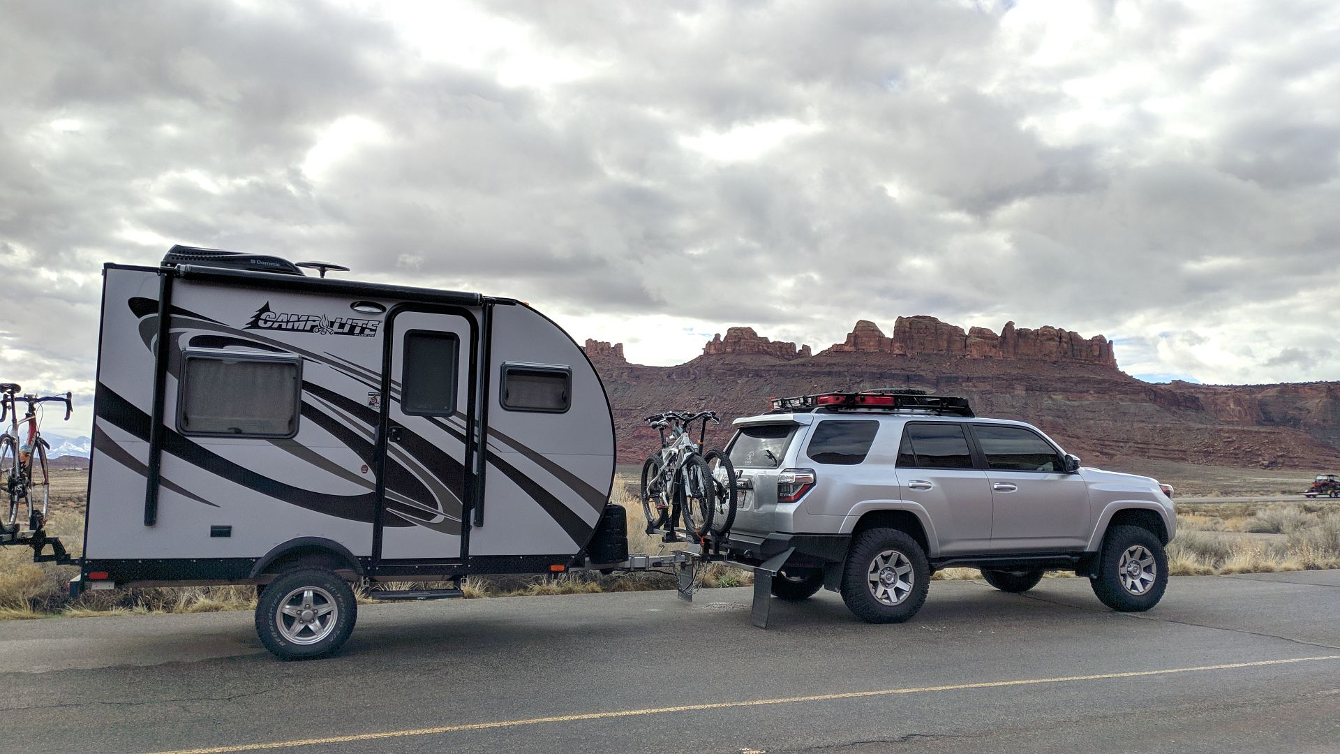

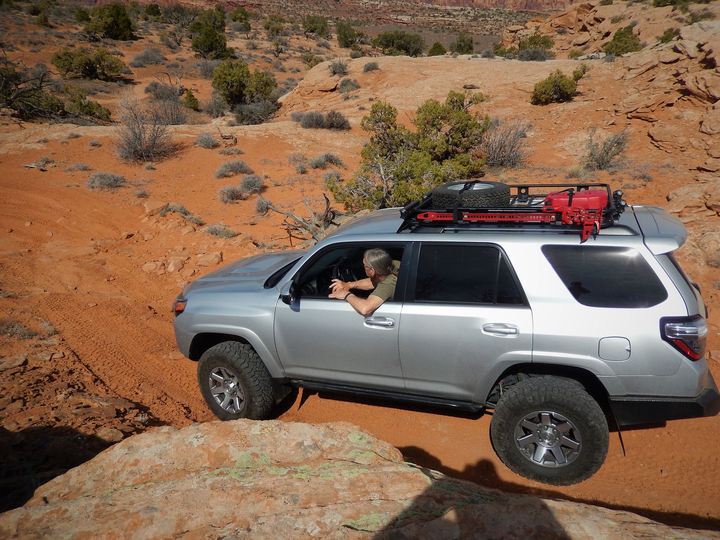

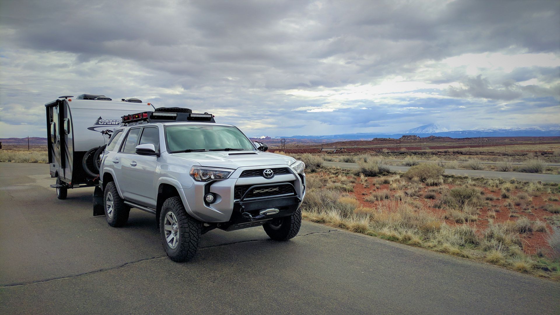

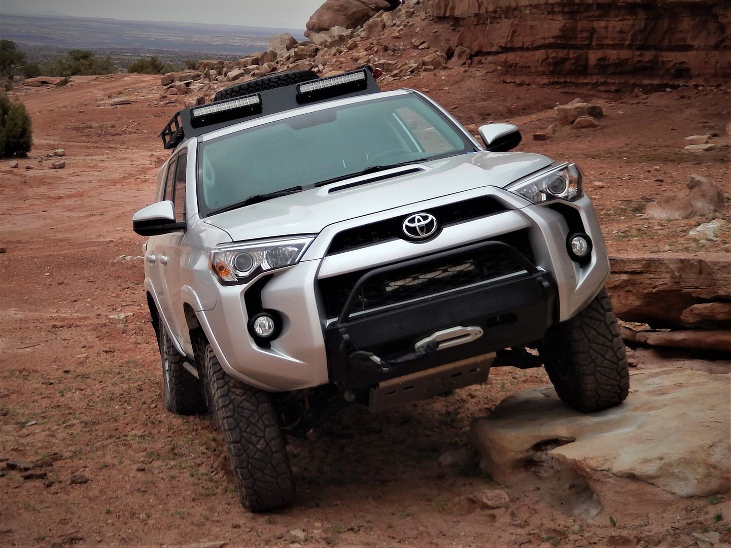

Super happy with the 255's. Front fender was clipped as I previously had 285's. Will the 255's I have no rubbing even with the RockBlokz mud flaps. Tire performs well in snow, rain, sand and redrock. No regrets at all. I have 3" lift and 1.25" SpiderTracks. Ground to top of front fender well is 38.75".

Nice set up. Exactly where I plan to be. We have the same model, color and rims. Did your tire shop complain about the width of tire with that rim?
How does your ride feel? Im new to this so Im going into it lightly. I have the Bilstein 6112Heavy, Bils. 5160 with OME 895e. And see how it goes. Need to choose tires. I want the RGs. My gut and a few say go with 255. Many say go,with 285. Were your previous 285 Ridge Grapplers?
I also noticed the 255 come rated E only. I have no plans to tow. Would this wheel be a waste considering?
Which affects gas more 255 or the 285?
Shop (Firestone) only said they will be more responsive that the 285's. I found they did steer "easier" but not twitchy. The rim size on the Trail is 7.5", right in the middle of Nito's recommended sizes. As for ride, they are truck tires, not Cadillac tires, but I like a truck ride. The E rating gives them a firmer feel on cornering being so tall at 80. Even if you don't tow that's a plus. Gas millage, I get 1.5 miles per gallon better with the 255's over the previous 285's. I have experienced zero downside to going with 255, glad I did, it's all I will ride from here on out.

You are proving my assumptions correct. Nice to read. Were your 285s Grapplers? Last but not least. Did you have to body mount chop? Were the Spidertrax spacers a look thing or needed to prevent rubbing and/or help the ride?
Thanks again!
Thanks again!
The 285's were Toyo AT2. No BMC. Spacers are for a wider, more stable stance, and they look good.

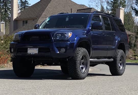

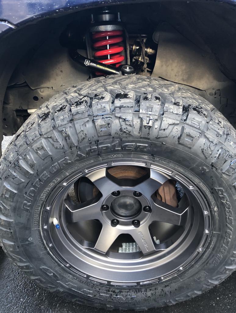

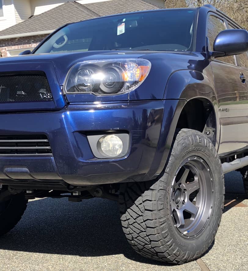

285/65/18 here. Love this set. Super quiet for mud/snow capable tires. Although heavy AF.
