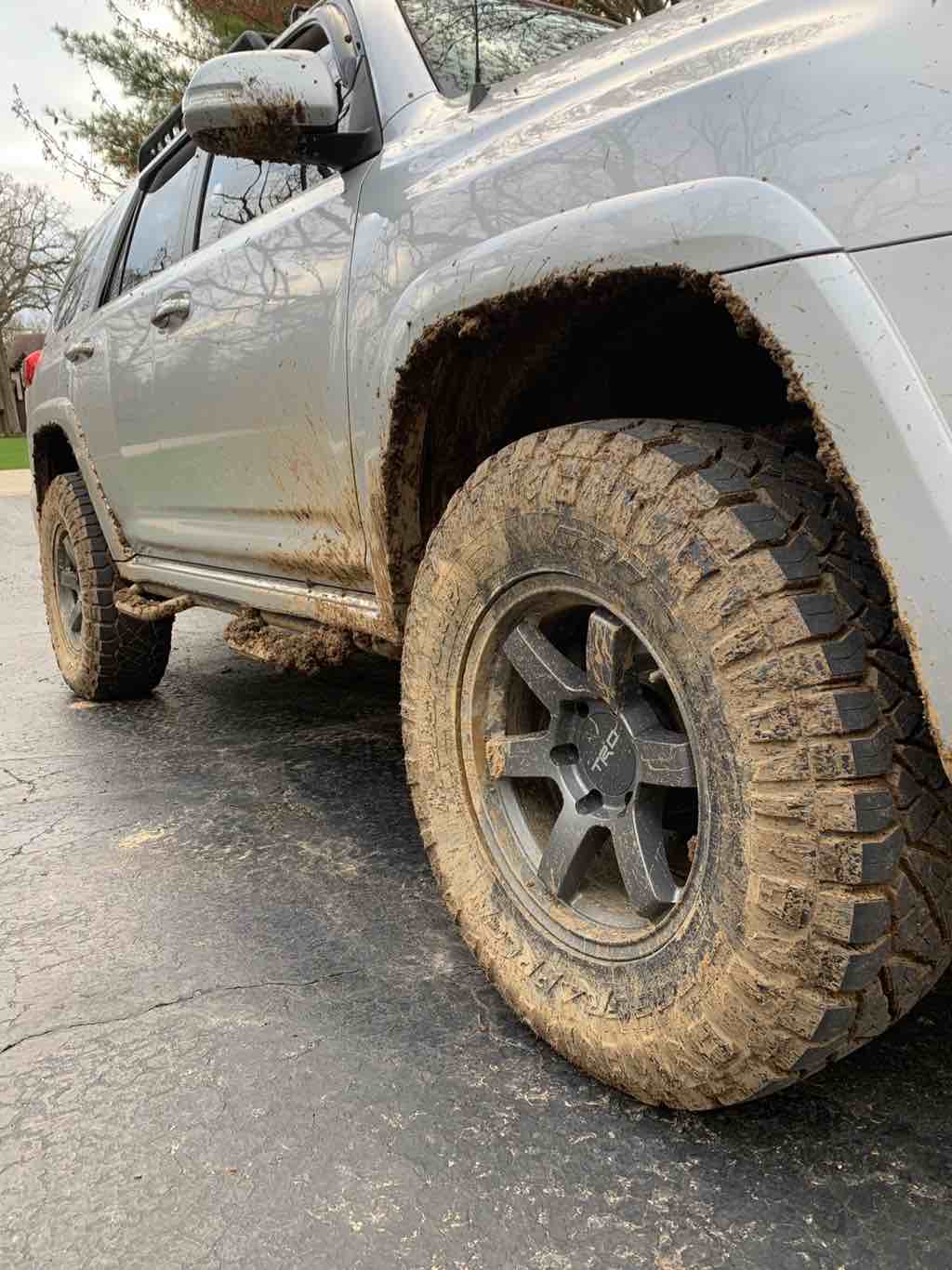

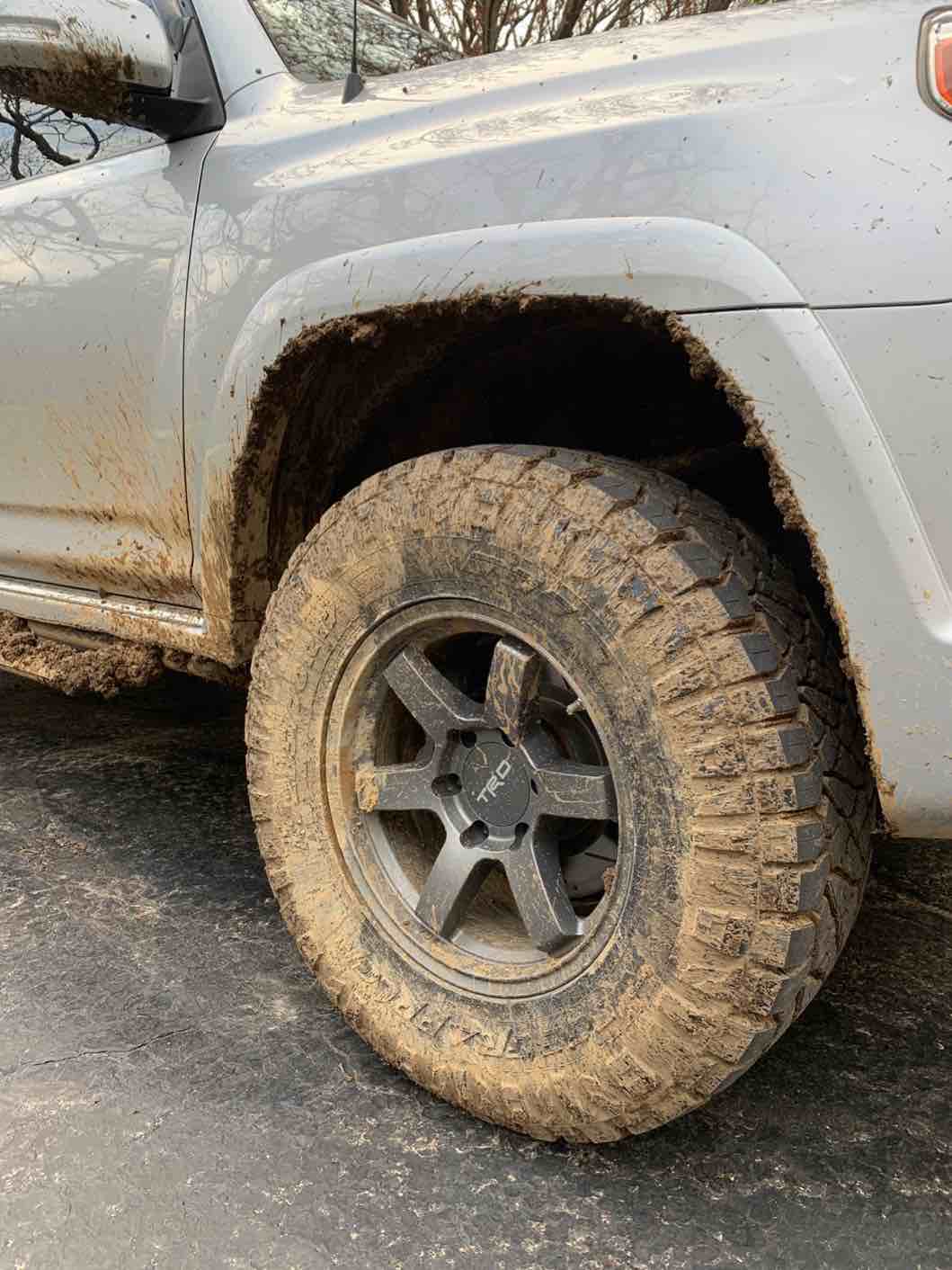

I’ll say, what the RG lacks in snow performance it more than makes up for in off road capability. This is easily the best off road tire of the bunch.
They plowed right through some thick mud that had my truck sinking unbeknownst to me without even a hint of drama. I have 45 days to return them but if they keep up their off road prowess and good road manners (other than noise which is the loudest of the bunch) I may consider keeping them.
285/70-17 C Load
They look smaller than their actual size. This is confirmed by a lack of rubbing where my KO2s would.
