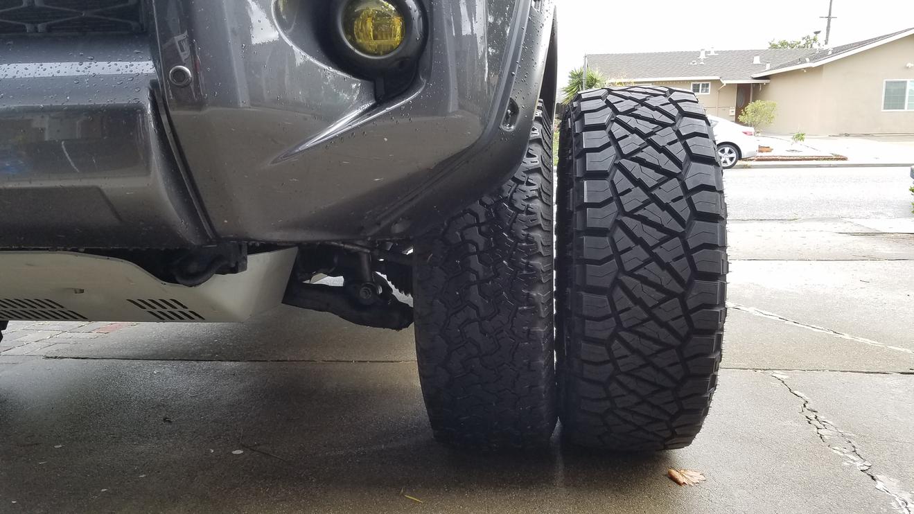

Got some 285's. 58.9lbs
Are they bigger then the BFG 285 or is that just the camera angle?
Anyone know how these compare in weight to the BFG's? I know the BFG's only come in E in 285, so curious is there is any "real" rolling weight advantage with these in C rated 285.
I read a post about the C VS. E weight but that was comparing the Ridgegrappler to the Ridgegrappler...
Curious about the 285 E BFG weight vs. the 285 Ridge C or E.
Those weight specs are hard to find.

You are going to love them!
Good to know. Definitely loving the looks.

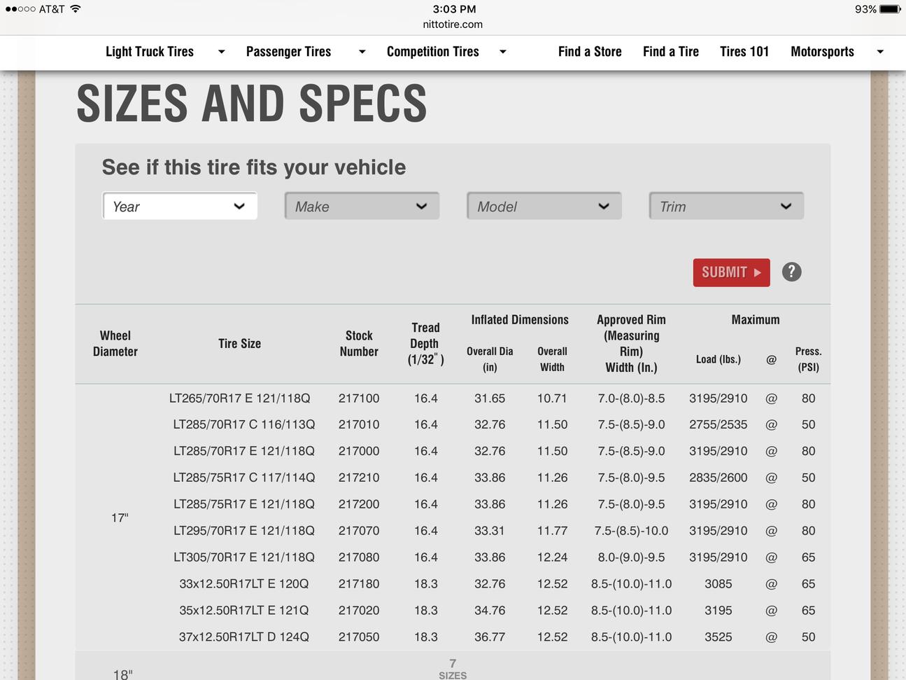

They definitely looks bigger and I believe KO runs smaller then most.
These are E Load, never weighed my KO but they're rated about the same weight. Try emailing them.

I have the numbers written down somewhere but I think the 285 Nitto Ridge are .6" larger in circumference compared to the KOs. Nittos tend to run larger in 285,33" and 35"

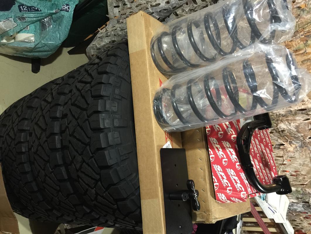

Got my Toytech ultimate lift, new UCA and Nitto ridge grapplers 285 70 on stock rims collecting dust. Need more O.T. Also im modifying that rotopax can mount to fit onto bajarack ladder looks a easy mod to do.

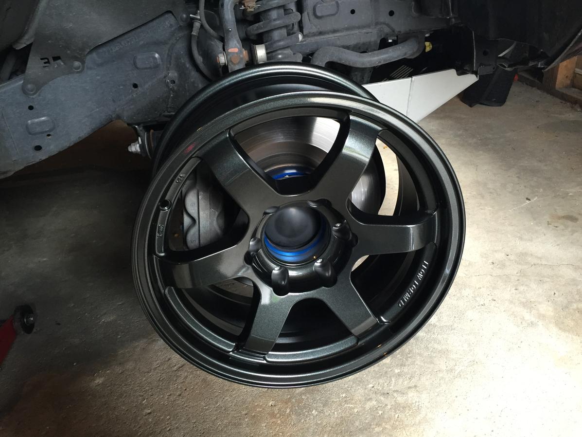

Tomorrow I'm mounting a set of FN's Verge wheels (17 x 8.5) that just came out on 285/70/17 Ridge Grapplers. Will have pics up late Wednesday afternoon....

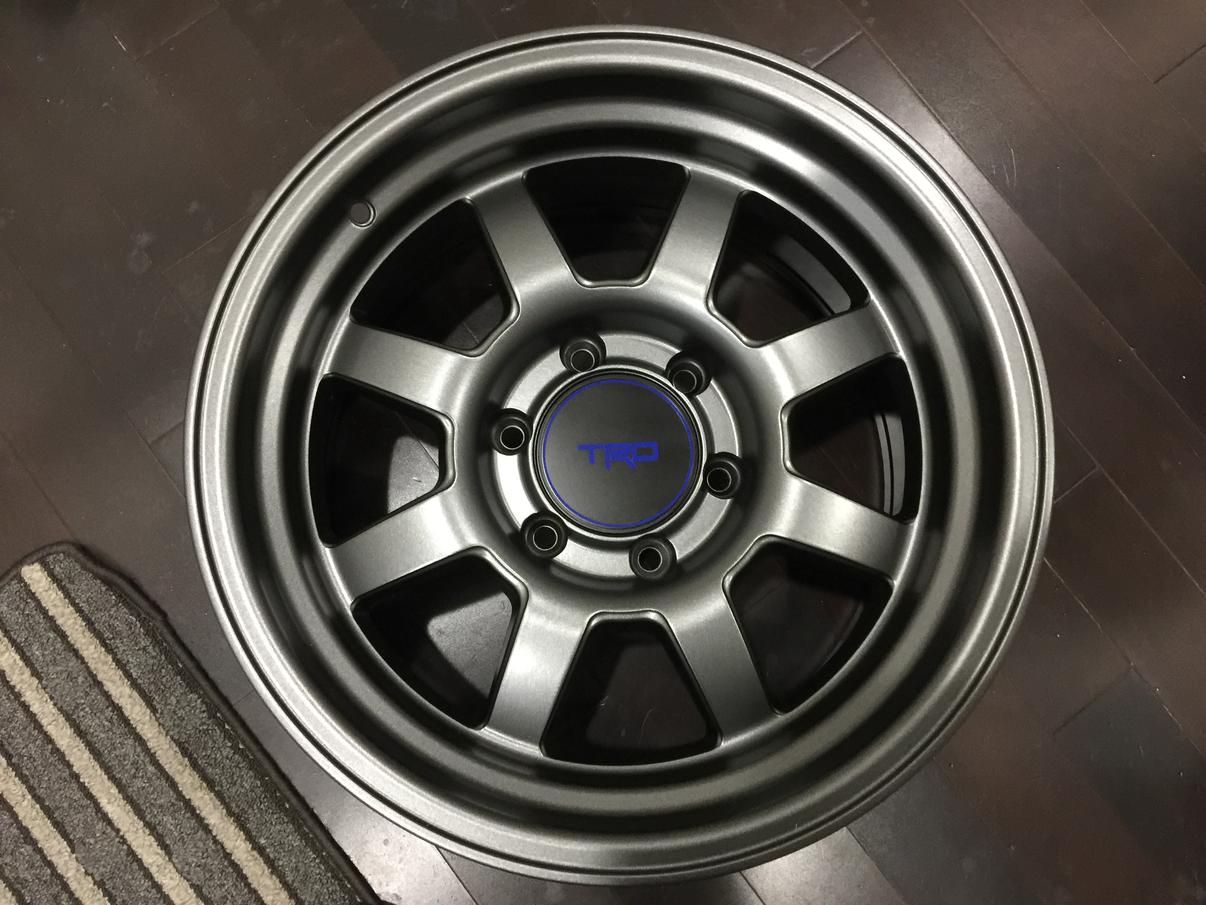

So went with FN's six shooter. Getting lift today and wheels put on. Wont know till tommorow what she looks like. Toyota Accessories PTR18-35092 TRD Center Cap is the size for the FN wheels. 11 bucks each on amazon. Caps not shown in photo. Per FN price going up next year on Six shooters.

are the caps a must?
