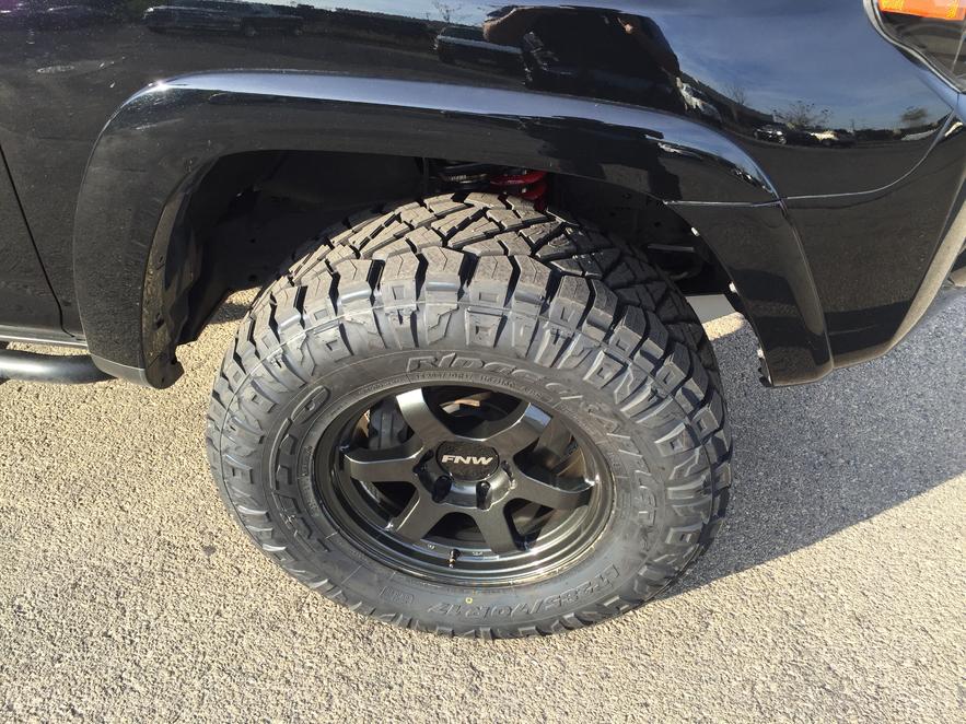

Ok done! Wow ride was better than i thought it would be. Got the toytec boss ultimate lift, no rubbing highway, street driving. Depending on what psi i choose ride was smooth at 40psi. And center caps are a must for me. FN Wheels are perfect fit 17x 8 zero offset 4.5 backspacing. Took mud flaps off beforehand but ill test them back on. I removed my spydertrax spacers from above pic before install.

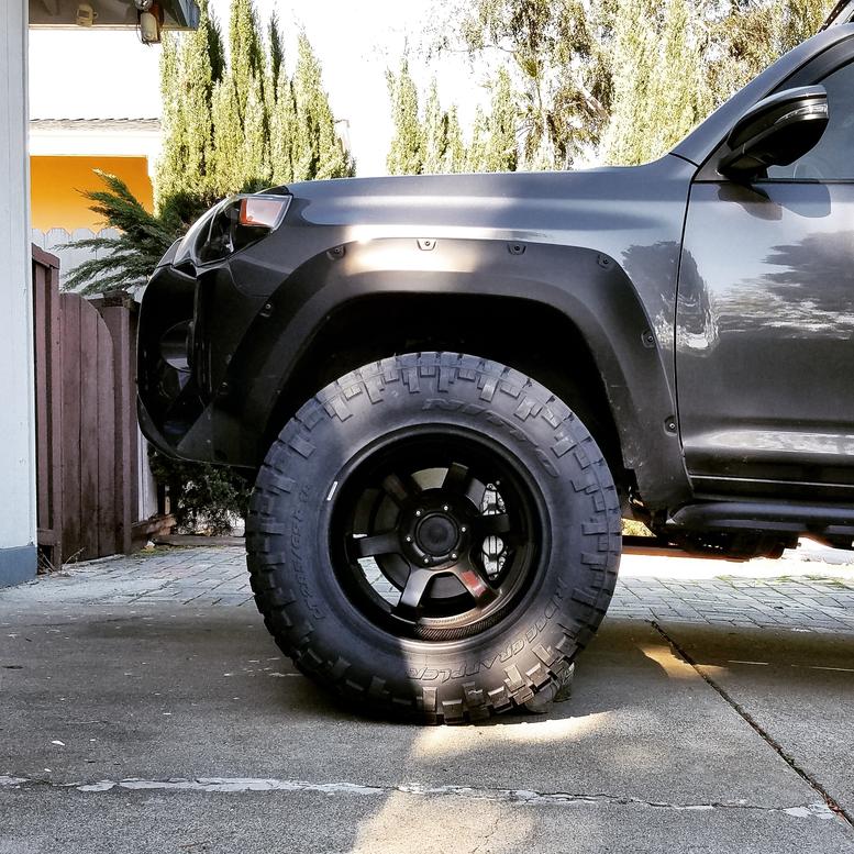

Here's my 4Runner. What do you think?

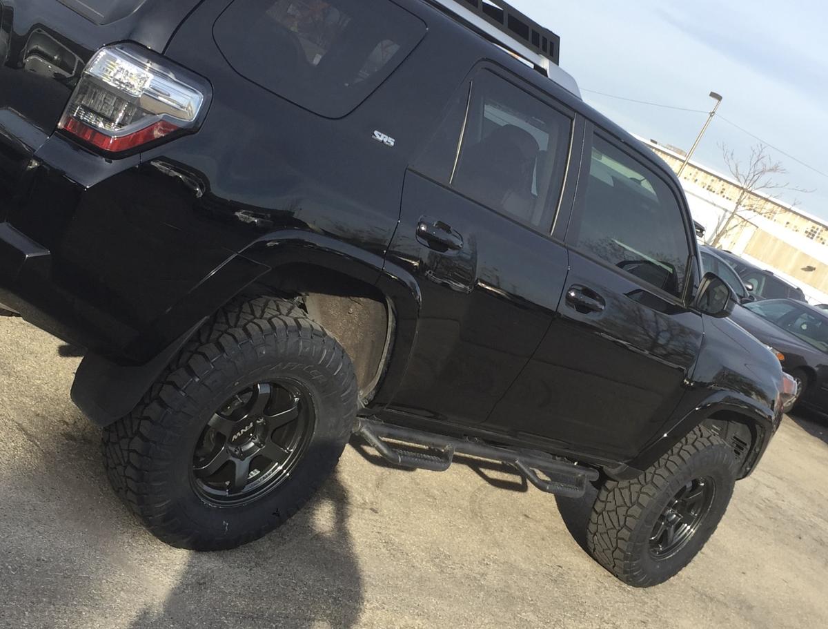

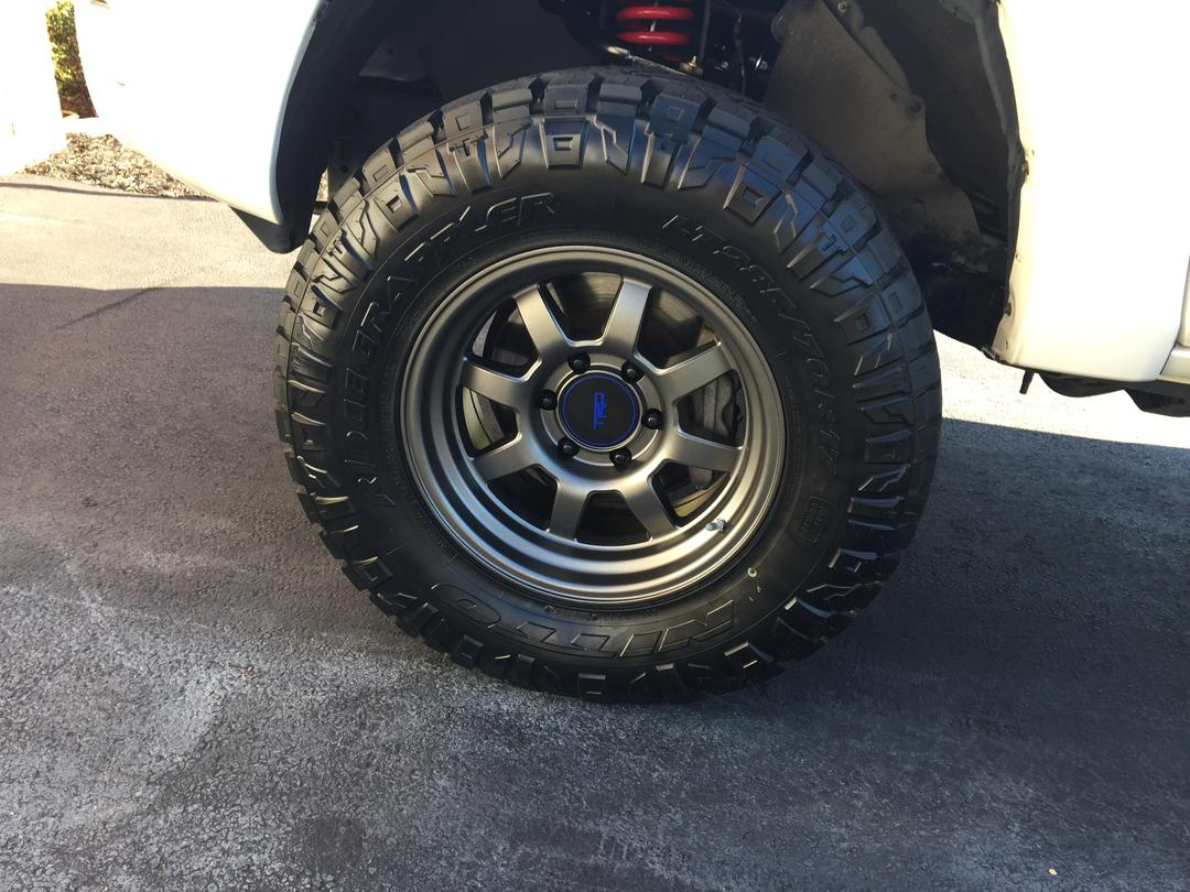

Can't really say as I haven't gotten around to mount it. I don't see a gain in going to the "C" as you're not really saving much in weight vs the added protection the "E" gives on the trail. Oh, I hate how the BF looks so small but if you have a UCAs the Ridge Grappler shouldn't but an issue based on my current setup but I won't know for sure until it's mounted. Here's what it should look like.
That looks pretty sweet! Unfortunately I didn't get UCA's with my kit. I'm running 3" boss lift, with 17x8.5" wheels zero offset and a 1" wheel spacers. I'm really close to the body mount right now, but it has never rubbed it. It only rubs the front fender liner in reverse at full lock.

At 3" lift you should really consider getting UCAs, as for BMC, I got about > .75" clearance which should be enough to clear. The liner will have to be push further out.

I have the same spec wheels and 3"lift, there is no rubbing at all with mine but vehicles are different in their own way. sometimes the spacers contribute to the rubbing which is why i took off my spydertrax first and never needed them back on. I reinstalled my mud flaps and no rubbing. hope this helps. Got my tires from Newegg.com free ship/no tax. still 243.00 as of today 285/70/17 C rated. or 238.00 BBwheels online.

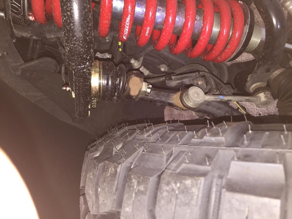

Inside look. Plenty of room. Just got back giving it a full tight turn torture test and found that i get rubbing on front fenter during hard incline turns, little trimming and no more worries. It will clear everything now. Test your gear sometimes its easy fix. SPC upper control arm. Remember my wheel size is 17x8 . 0 offset. 4.5 back spacing FN six shooters.

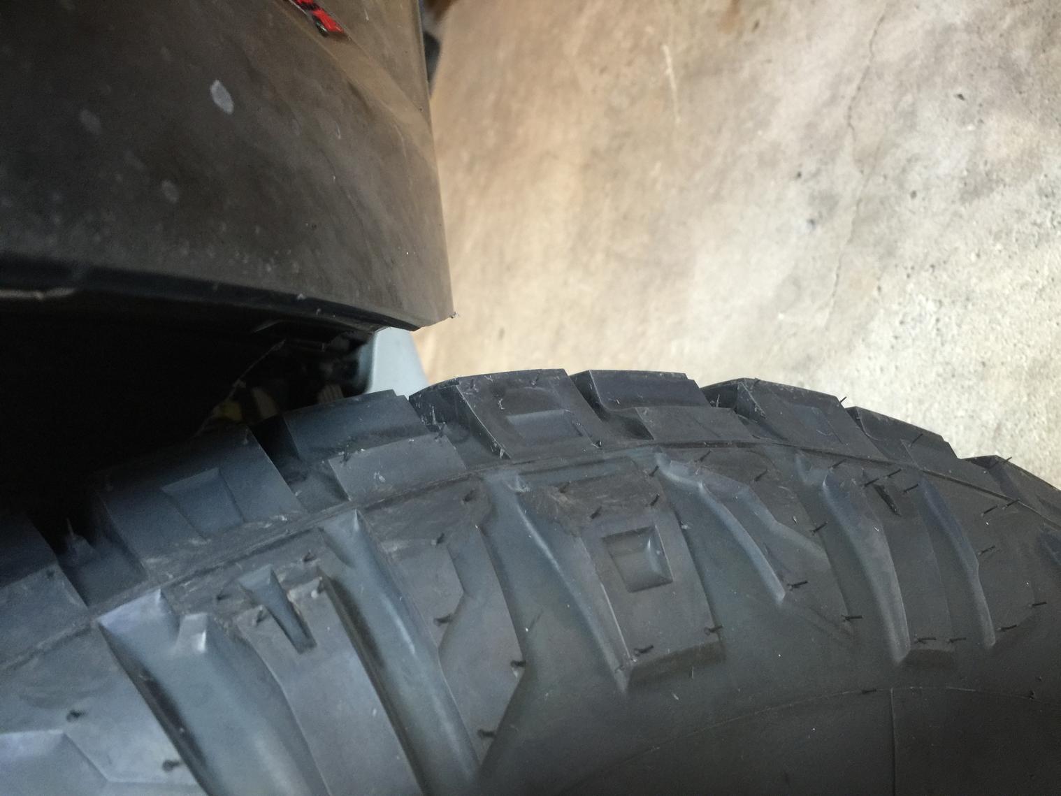

Did't need to trim much. It was mostly the tip end. Easy fix. Wheel turned at point of contact, under actual turn it rubs. Didn't find this out during normal driving and turns.
