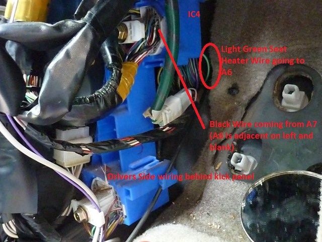

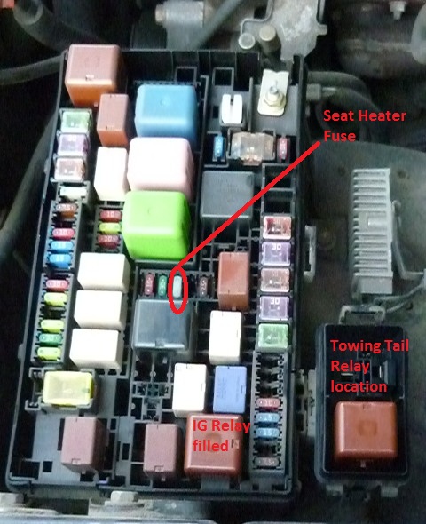

I wanted to use the factory fuse to wire the heaters. The fuse is in the engine compartment fuse box. It was in place so I figured the wiring may be too. To shorten the story a bit; There is a wire that goes from the factory fuse to position A6 of IC4 which is located behind the drivers side kick panel. Unfortunantly, it dies there. The other side of IC4 is blank. I decided to run my wiring to there and tap into the harness anyway so I could use the factory fuse. I soon learned there was no power there. I checked the fuse. It was fine. I looked at the schematics again and realized that power to this fuse is controlled by the IG relay in the fuse box. That location was empty. I pulled the relay from the 'towing tail relay' since I don't tow and put it in the IG Relay slot. Now I had power going through the fuse and to the wire in IC4.

How did you do the wires I'm lost. You spliced or tapped into the fuse box?
You cut it from behind the junction box (basically where I have it circled in the photo). There is no connector in the side of the harness that you can see so this is the end of the line for that wire.

I just wanted to say thank you for these instructions! Switched the relay over, ordered a 2nd relay because I do tow with the 4runner, and cut/soldered the green wire to main power. Works great! Thanks!
Glad to hear it. Always nicer when things are kept as stock as possible for these types of things. Enjoy the heated seats. I use them all the time in the winter.

Probably going to install my heaters this weekend. Have many other people done it this way? Any ill effects from moving the relay? Do you lose power to other essential places?
