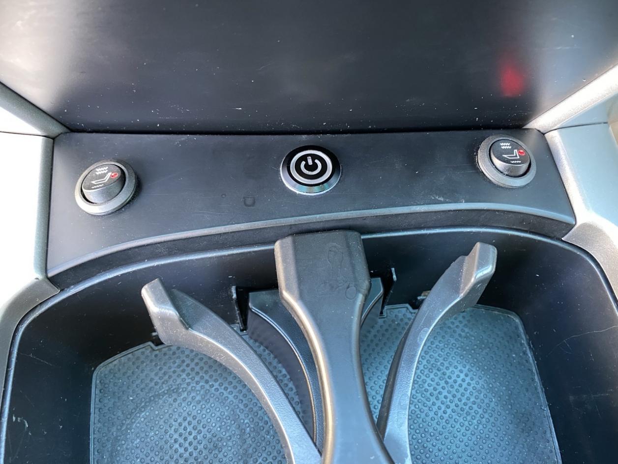

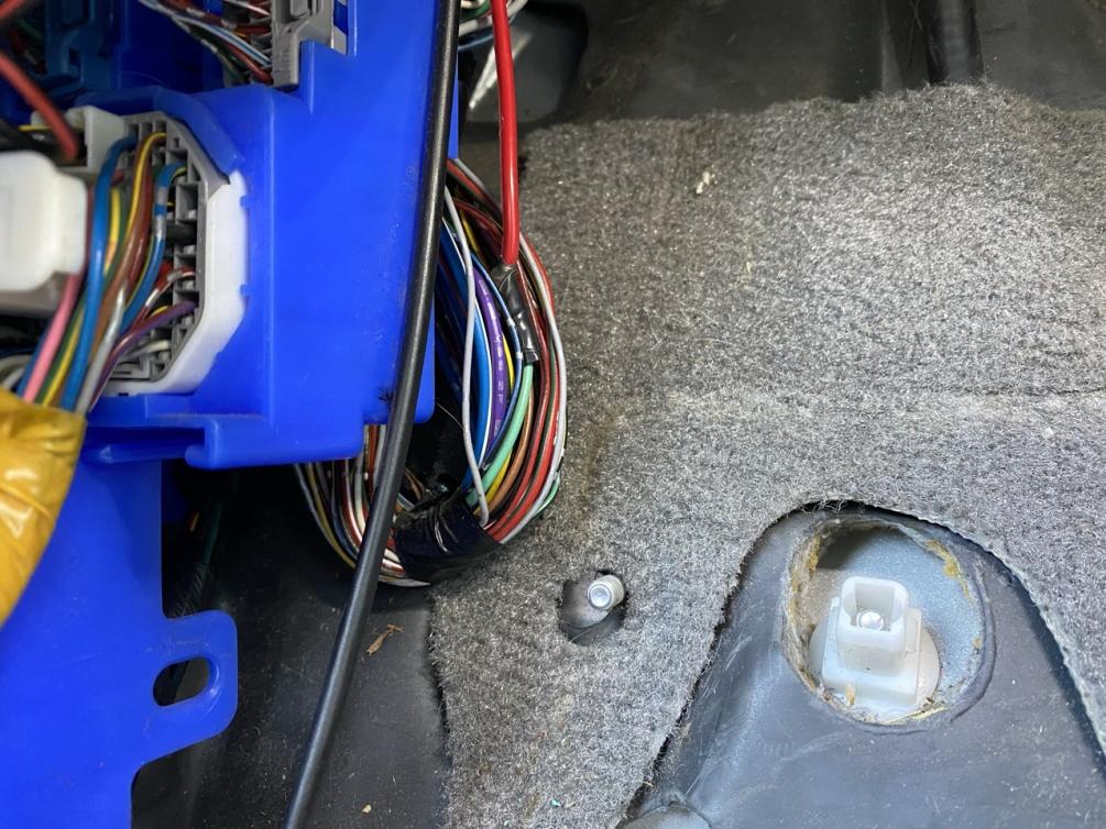

[MENTION=22661]Asmara[/MENTION], thank you for starting this thread. Although 5 years old it’s still very relevant. I was struggling last night to find an appropriate Ignition power fused wire under the seat and behind the ECU.
Switching relays and using the existing seat heater fuse and green wire in the IC4 was perfect! I ordered 2 of the 02016 relays off EBAY for about 14 for the pair shipped! I went with the Clazzio heaters. I’ll probably change the fuse to 15A since it came with 7.5A for each and wires are pretty small.
THANK YOU!!!
