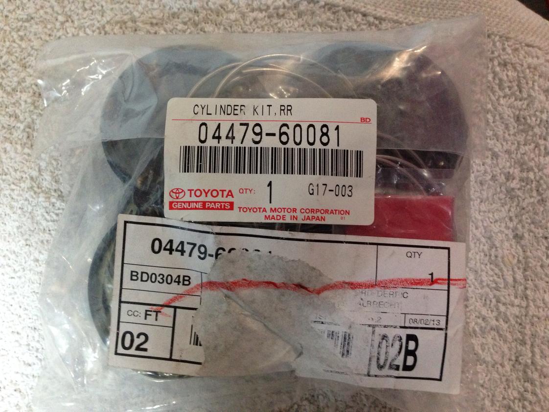

I do, yes. It's just the piston seals(boots and o-rings), unless you need the pistons as well, they are expensive though. I'll send the part #'s in just a bit for ya.
Here ya go [MENTION=102606]infamousRNR[/MENTION], it comes with everything to do both front calipers. I made the mistake originally buying two kits thinking it was one per caliper.

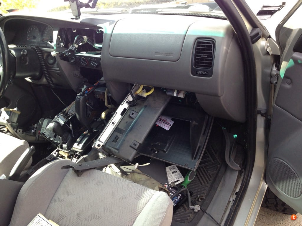

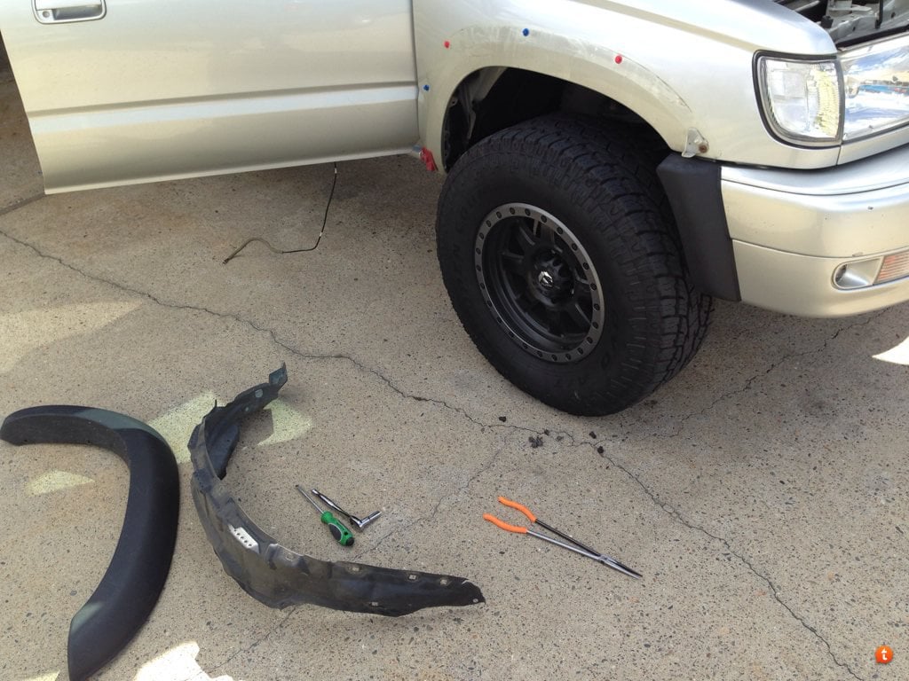

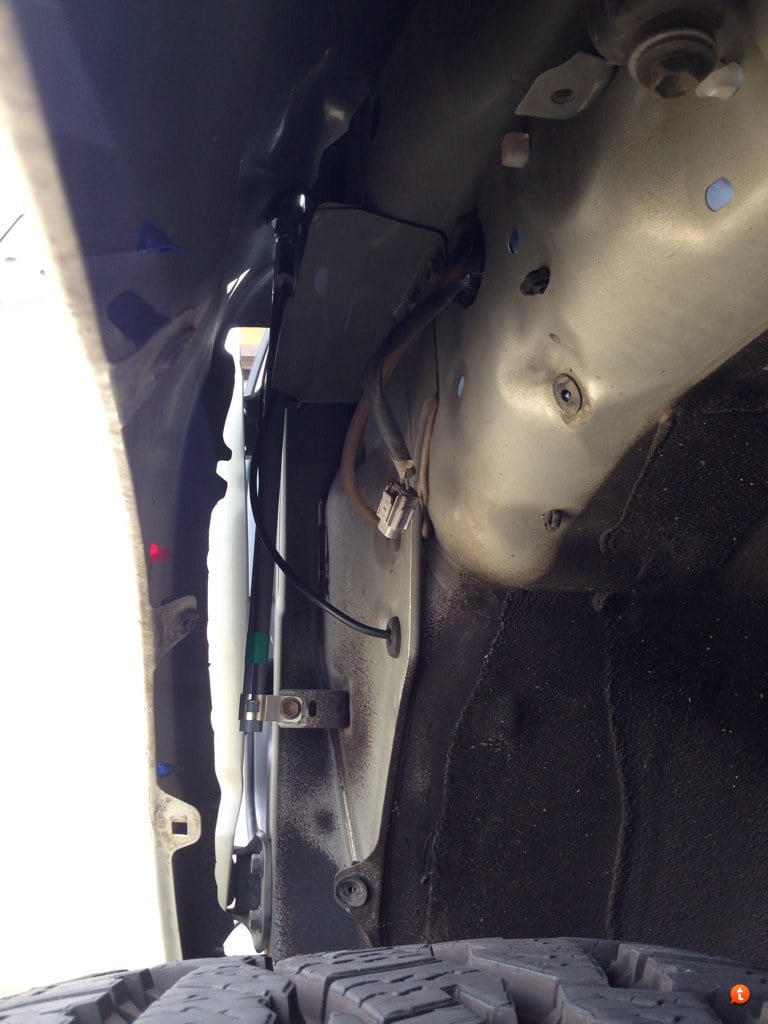

FU*K this mod hard in it's a*s!!! Sport flare clips break EVERYTIME and the stupid antenna wire is such a bi*ch to get up the passenger kick panel and back in the factory clips. I swear this antenna wire has it out for me, been 20 minutes and I'm still dicking around with getting it up the kick panel. I feel completely useless at the moment trying to get this stupid thing in place. Ok, rant over. Back to it.
and what exactly is this MOD?... what is the end result..
It rids you of the electric gear driven multi piece antenna mast that breaks super easily and switches it to a stationary flexible mast(know as the Tacoma whip mod I believe). Now you can wheel without breaking your antenna and go through drive through car washes without turning off your radio. Also, I'm done finally, well almost. I need to search my toolbox for the extra fender clips due to breaking 4 taking my flare off. :violin::redbrick::gun4:
